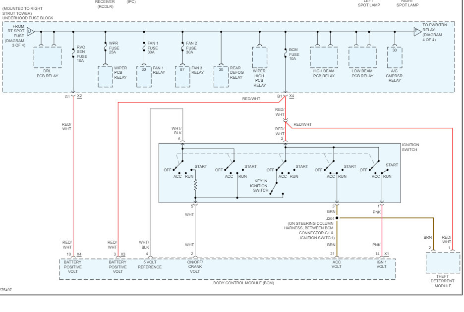

I need a color code wiring diagram for the car listed above for the ignition switch, so I can wire in a aftermarket push to start and stop button.
Aug 16, 2023 at 5:49 PM
  • 55,721 POSTS
Sure, here is the ignition switch wiring diagram so you can see how the system works and how to wire the aftermarket push to start and stop button. This guide will help you test the connections:

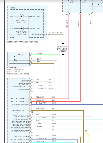

Is it also possible for you to tell me the color code for the brake wire for the push start button?
Aug 17, 2023 at 7:59 AM
  • 55,721 POSTS
I think you need the light green wire. Check out the images (below). Please let us know how it goes.
