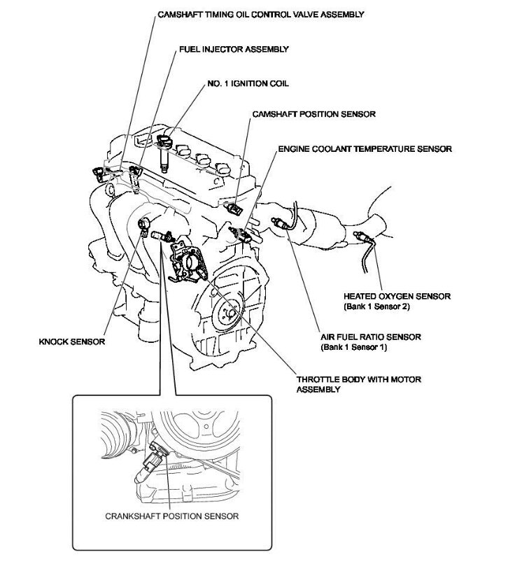

Car drives fine then out of nowhere it's like all the power is lost except power is still on, then when trying to accelerate no rpms or movement except the momentum you previously had. So, I have to pull over and turn car off for 10 -20 seconds, then starts up and drives but is sluggish .

The car sounds like it is in limp mode, here is a guide to help explain it better:
https://www.2carpros.com/articles/reduced-power-limp-mode
This can happen when the throttle body needs to be replaced or serviced, here is a guide to help run the codes:
Here is a generic guide to help you step by step with instructions in the diagrams below to show you how on your car:
