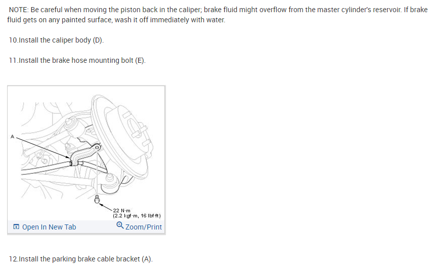

My brake warning light is on they say I need rear brakes
2013 HONDA ACCORD
110,000 MILES • 2.4L • 4 CYL • 2WD • AUTOMATIC
SHADOWFROM88
Sep 13, 2018 at 8:26 AM
DANNY L
  • 5,648 POSTS
Hello, I'm Danny.

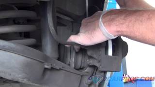

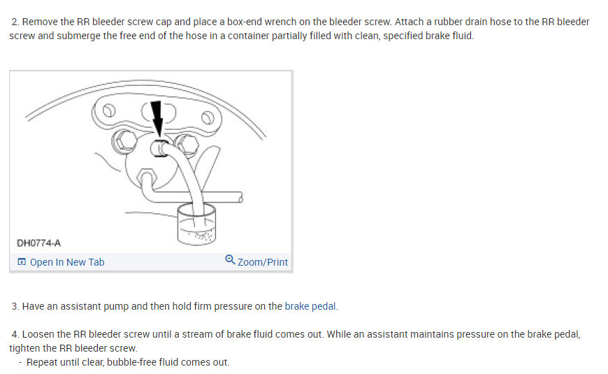

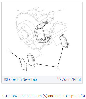

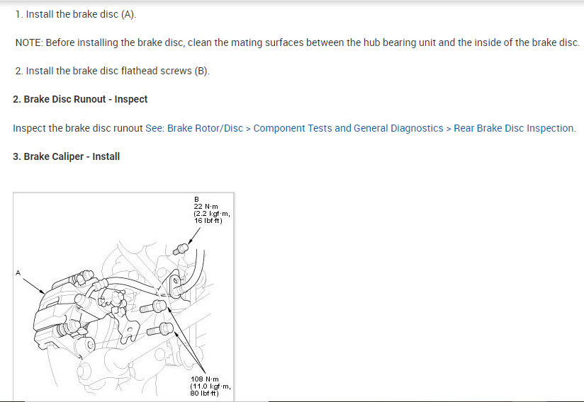

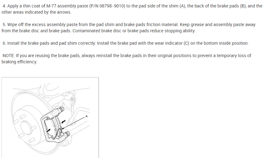

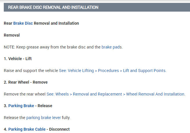

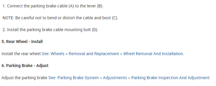

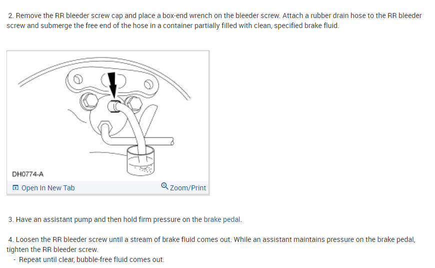

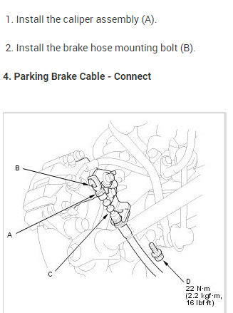

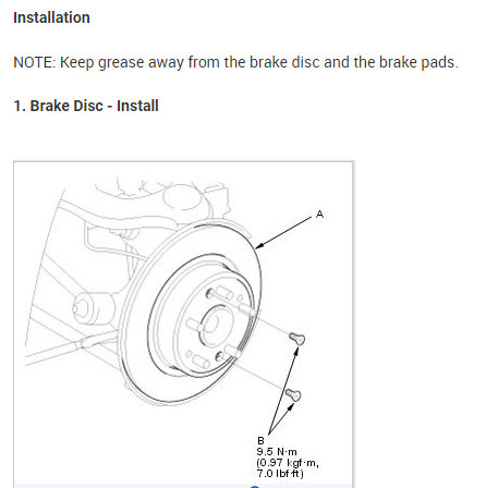

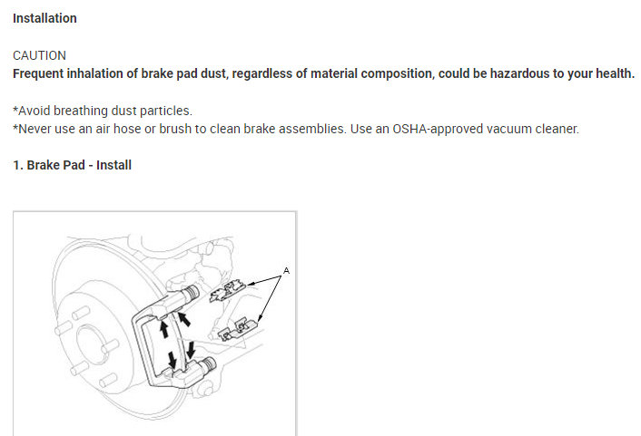

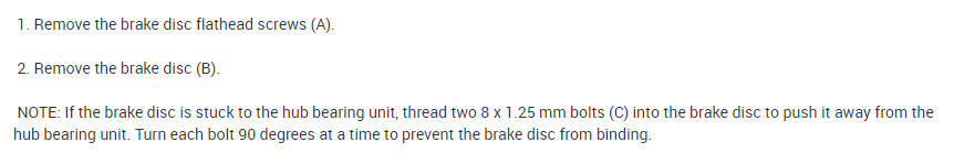

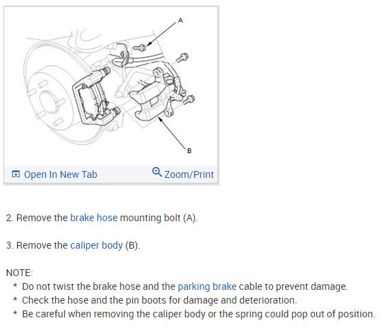

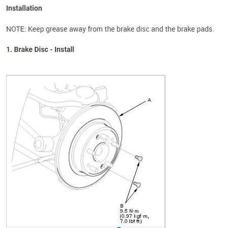

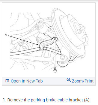

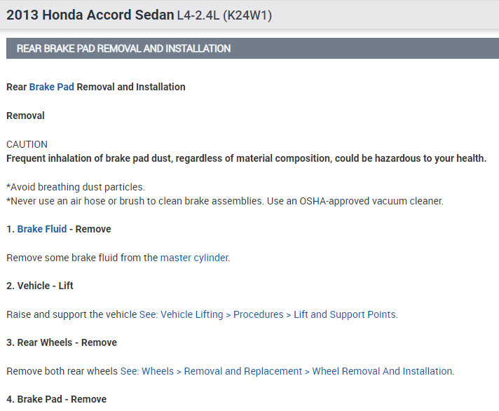

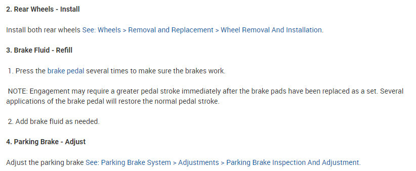

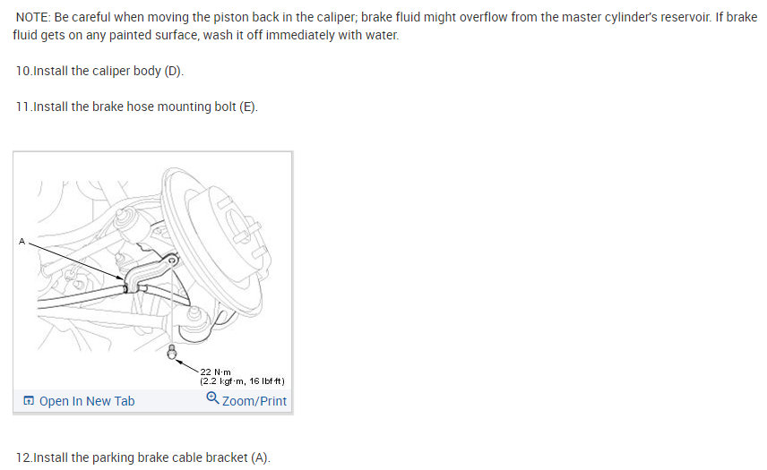

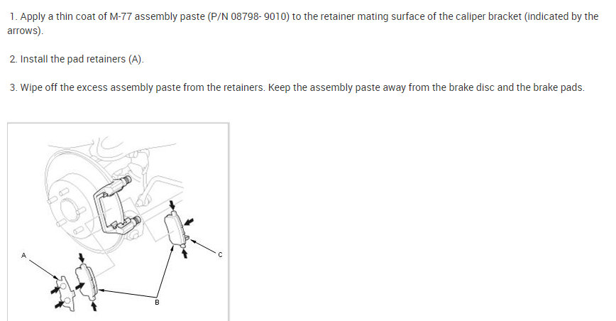

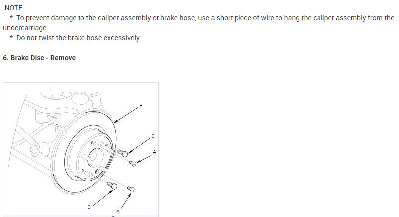

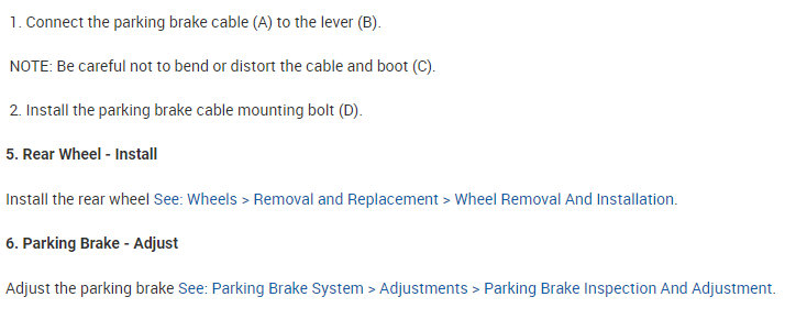

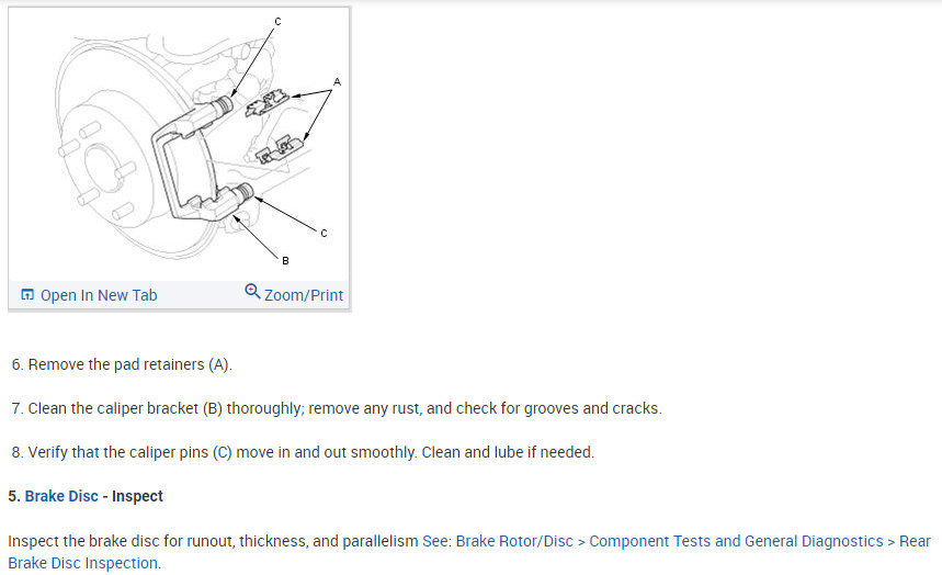

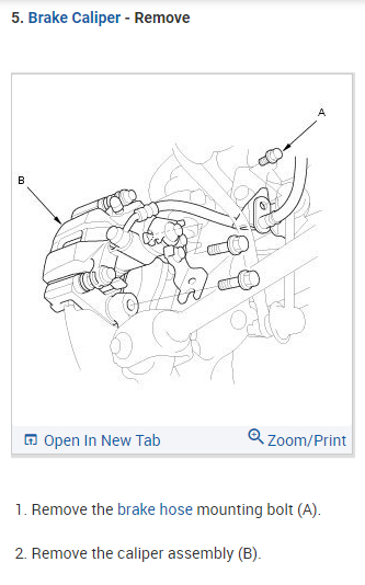

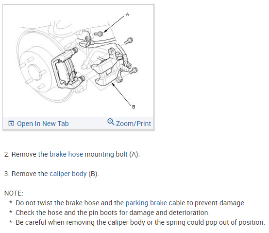

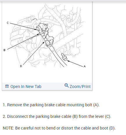

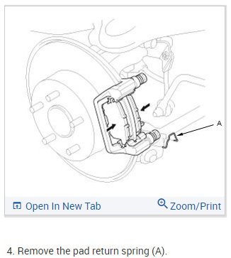

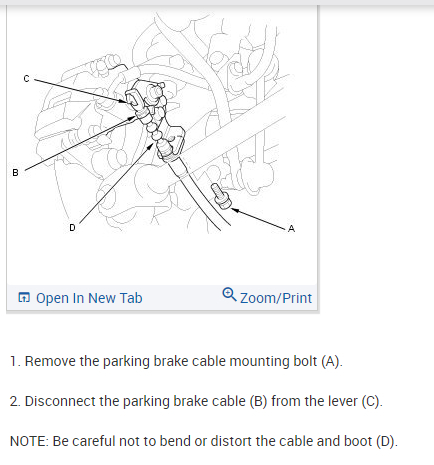

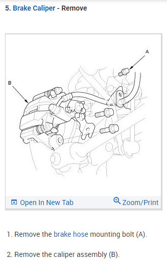

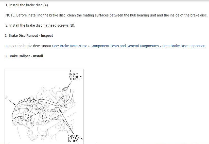

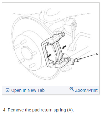

Here is the information you requested. Here is a guide to help you step by step with instructions in the diagrams below to show you how perform the repairs on your car:
https://www.2carpros.com/articles/how-to-replace-rear-brake-pads-and-rotors
Here is a YouTube video from our site on how to compress the rear caliper piston when performing a rear brake job:
https://youtu.be/j8YwfSKEzZo
I've attached picture steps below on how to replace the brake pads and rotors on your car and it shows what special tools are needed to perform this repair. Hope this helps and thanks for using 2CarPros.
