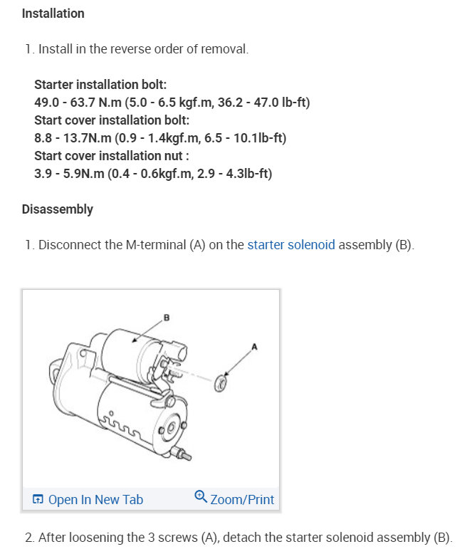

Push button starts sometimes. The dealer gave me new fobs and put in new car battery. Still happens.
Sep 25, 2018 at 8:19 AM
  • 55,423 POSTS

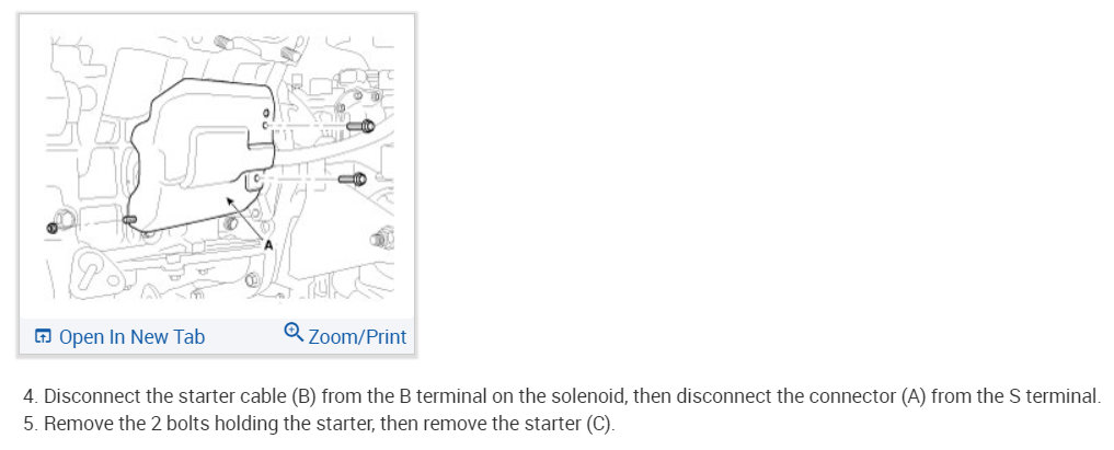

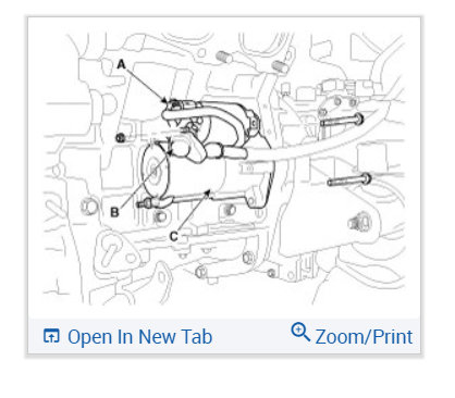

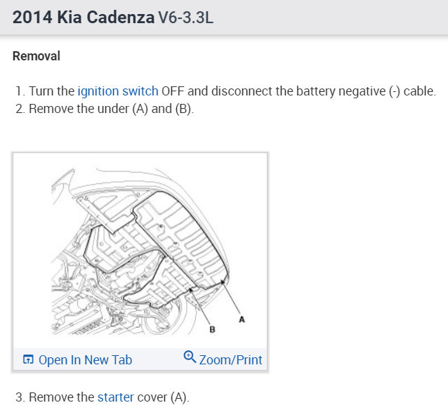

It sounds like the starter motor is going out. Can I ask if the security light is flashing? If not here is a guide to help us confirm the starter failure and diagrams below to show you how to change it in your car:
and
