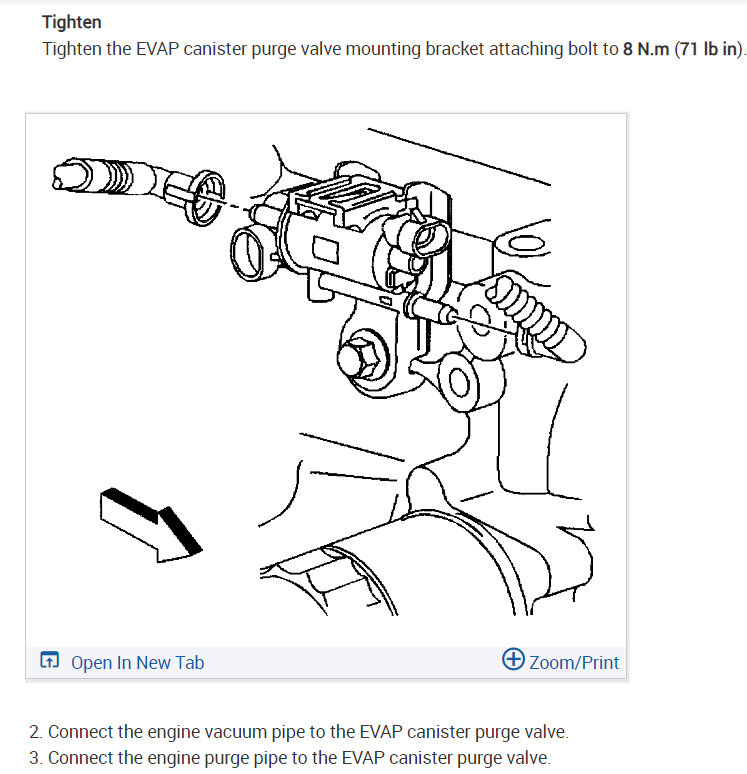

I want to clean the purge valve solenoid to fix a p0440 code, but I can't find the purge solenoid.
Feb 26, 2024 at 11:38 PM
  • 55,851 POSTS

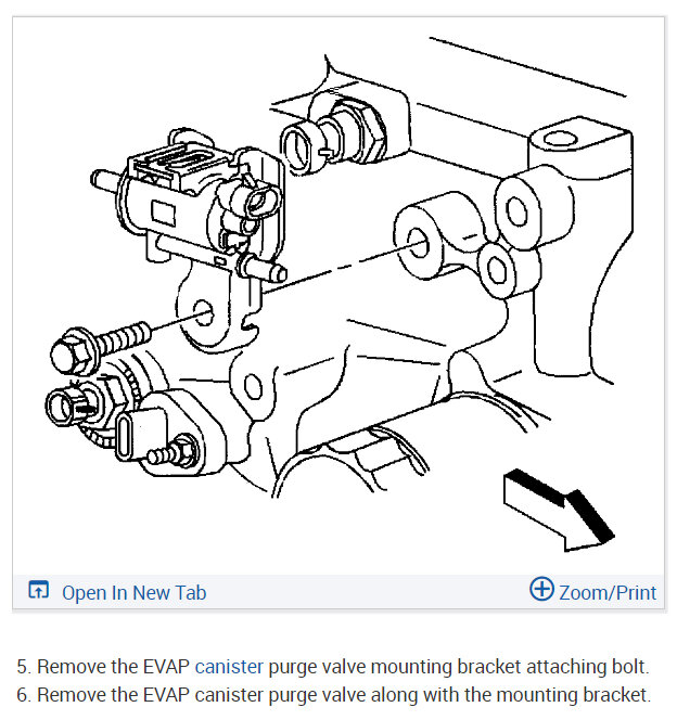

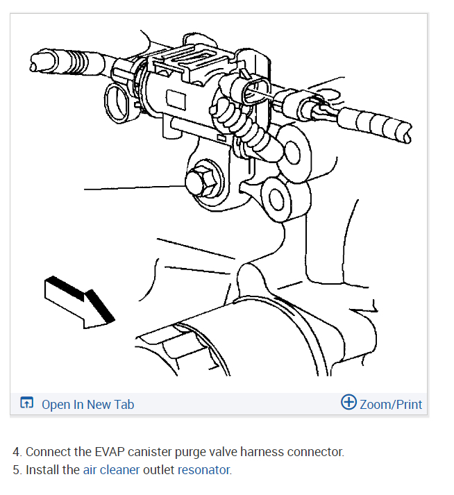

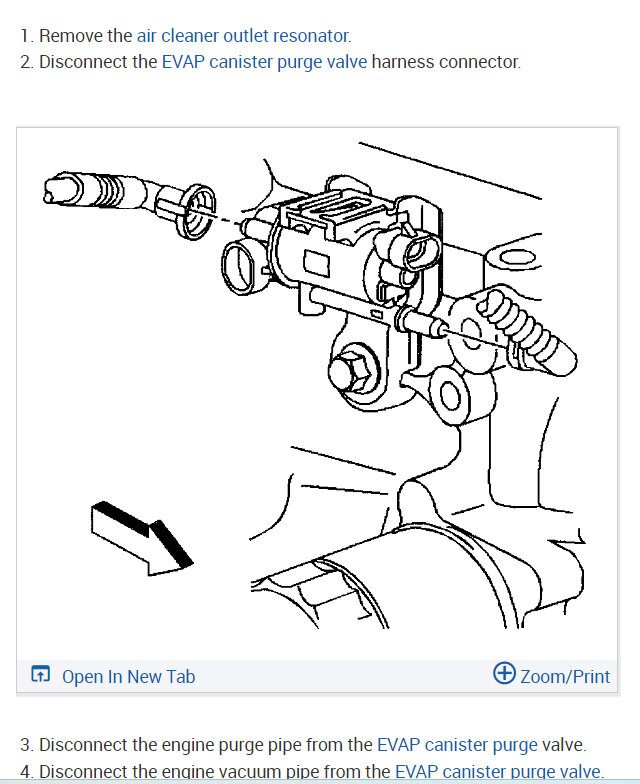

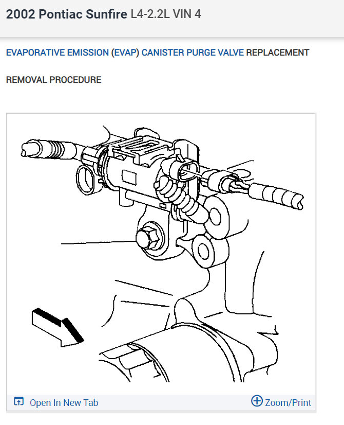

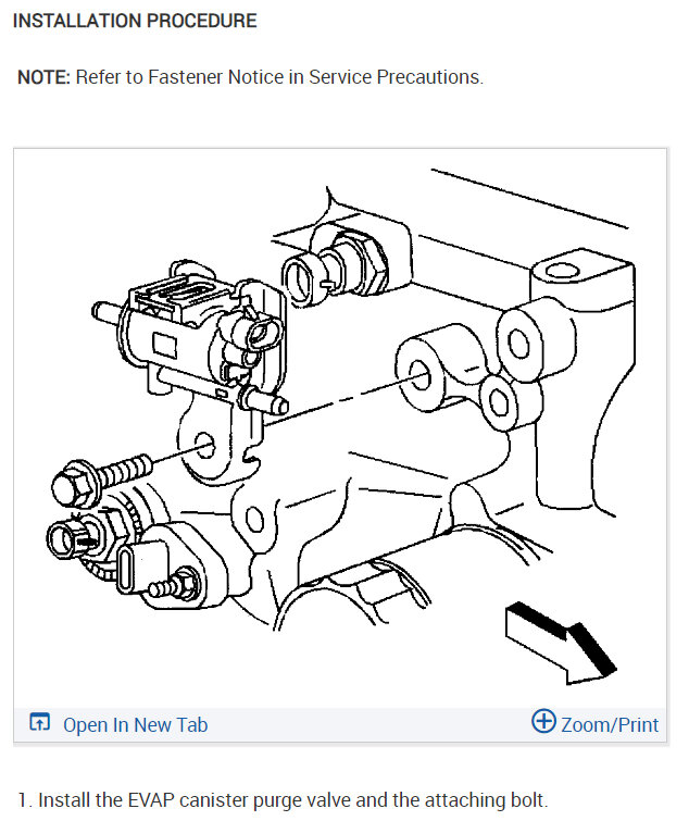

The purge valve solenoid is located right above the engine oil filter. Here are the instructions on how to change it out. Check out the images (below). Let us know if you need anything else.
