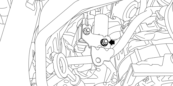

I am trying to replace my purge valve solenoid. This if for the Forester XT and not the not turbo Forester. I am not sure of its loacation. thank you.

The purge valve solenoid 2.0 turbo is mounted on-under the intake manifold area, toward the driver’s side and rear/center of the engine, under the top-mounted intercooler. Here is a diagram to help. It is kind of near the oil dip stick tube. Check out the images (below). Let me know if you need anything else.

Thank you. Much appreciated.
