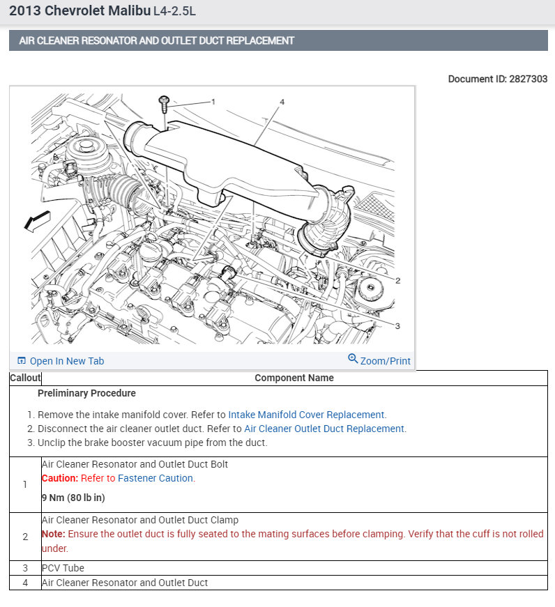

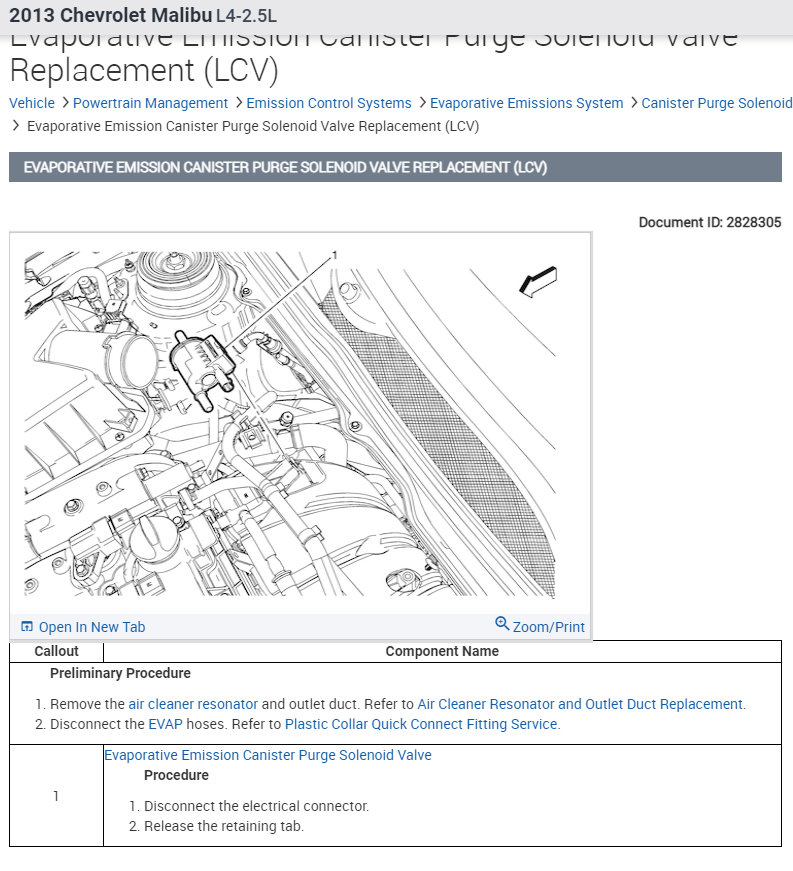

Where is the purge valve solenoid located?
2013 CHEVROLET MALIBU
157,000 MILES • 4 CYL • 2WD • AUTOMATIC
PINEAPPLEAK90
  • 6 POSTS
Purge valve solenoid location.
May 7, 2022 at 8:15 AM
SQM
  • 6,383 POSTS
The EVAP canister purge solenoid is located under the hood, on top of the engine close to the firewall.
In order to access the solenoid, first the air cleaner duct needs to be removed.
I have attached diagrams below for reference.
let me know of any questions.
