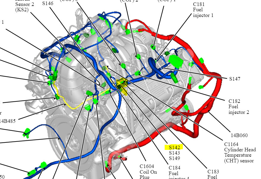

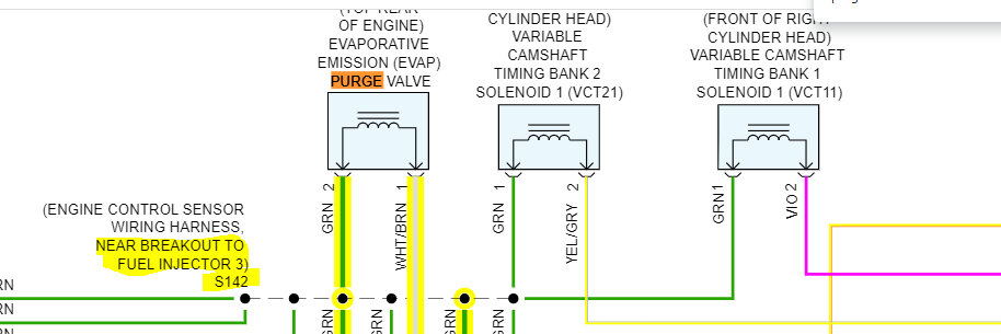

I would remove the new part, and have it replaced under warranty to see if you simply got a faulty part.
On the other hand, there is a wire splice that ties several power supplies together including the purge valve. It is splice S142. See pic below. When you hear the noise, move the green wire around or wiggle it to see if the noise stops.
Let me know what you find.
