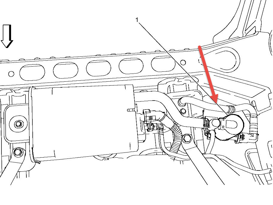

Hi, I am trying to figure out where my purge valve and EGR valve is located in my car and what they look like?

purge valve is normally on the evaporator canister and EGR is on engine, but since you gave no engine size cannot give location of EGR. See picture.

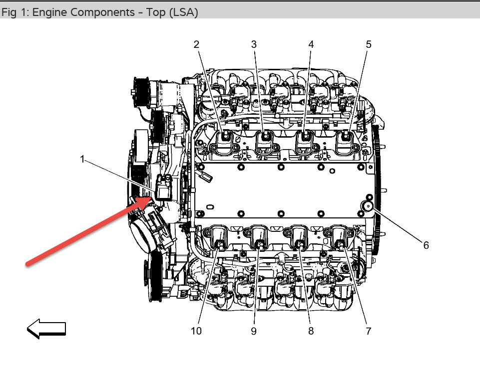

Hi, my engine is 3.6L six cylinder 6A. Could you provide picture of where the valve purge is located?

see picture. there is no picture of EGR valve, so you may not have one.
