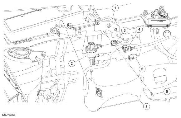

I ordered a new Purge Valve (after having switched out the gas cap, and tested the new gas cap). The new one arrived but am not sure it is the right model. Could you send me a picture of the valve itself, with instructions on how to locate and change it out? Also, if that doesn't solve the issue, recommend how I go about checking for cracked lines, i.e. do a step by step diagnostic. Thanks

Here are the directions for replacing the canister purge valve. The attached pics correlate with the directions. The code you have doesn't pertain to this as a problem.

EVAPORATIVE EMISSION CANISTER PURGE VALVE
303-13 Evaporative Emissions 2010 Focus
REMOVAL AND INSTALLATION
Evaporative Emission Canister Purge Valve
Pic 1
Item Part Number Description
1 9G683 Evaporative Emission (EVAP) canister purge valve bracket
2 9G641 EVAP canister purge valve
3 14A464 EVAP canister purge valve electrical connector
4 — Vapor jumper tube-to- EVAP canister purge valve quick connect coupling (part of 9D289)
5 — Vapor jumper tube-to- EVAP canister purge valve quick connect coupling (part of 9L291)
6 W709438 Heat shield retainer (2 required)
7 — Heat shield
Removal and Installation
image WARNING: Do not smoke, carry lighted tobacco or have an open flame of any type when working on or near any fuel-related component. Highly flammable mixtures are always present and may be ignited. Failure to follow these instructions may result in serious personal injury.
image WARNING: Do not carry personal electronic devices such as cell phones, pagers or audio equipment of any type when working on or near any fuel-related component. Highly flammable mixtures are always present and may be ignited. Failure to follow these instructions may result in serious personal injury.
image WARNING: Always disconnect the battery ground cable at the battery when working on an evaporative emission (EVAP) system or fuel-related component. Highly flammable mixtures are always present and may be ignited. Failure to follow these instructions may result in serious personal injury.
Disconnect the battery ground cable. For additional information, refer to Section 414-01 .
Remove the 2 retainers and the heat shield.
Disconnect the Evaporative Emission (EVAP) canister purge valve electrical connector.
Disconnect the 2 vapor jump tube-to- EVAP canister purge valve quick connect couplings. For additional information, refer to Section 310-00 .
Press the locking tab and remove the EVAP canister purge valve from the bracket.
pic 2
To install, reverse the removal procedure.
