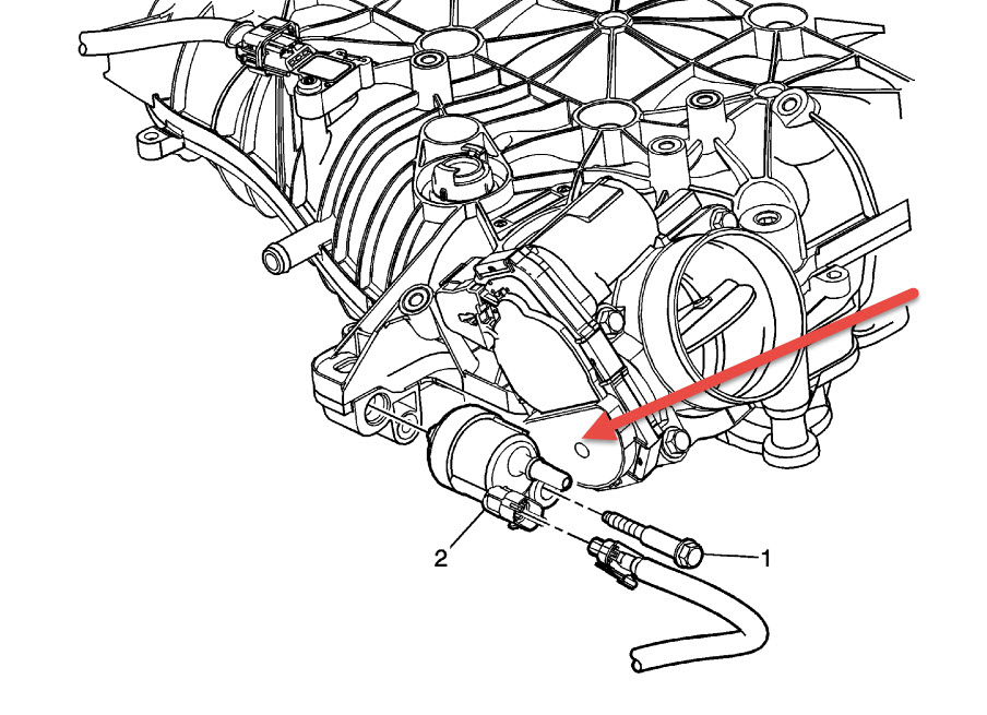

How do I change the purge valve?

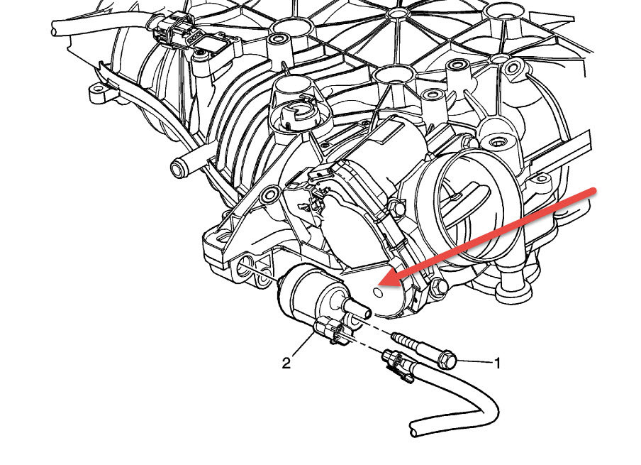

remove intake cover , unhook electrical unbolt purge valve solenoid bolt replace new O-ring on valve and reverse for assembly. Check out the diagrams (Below). Please let us know if you need anything else to get the problem fixed.
Image (Click to enlarge)
