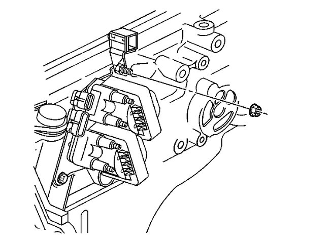

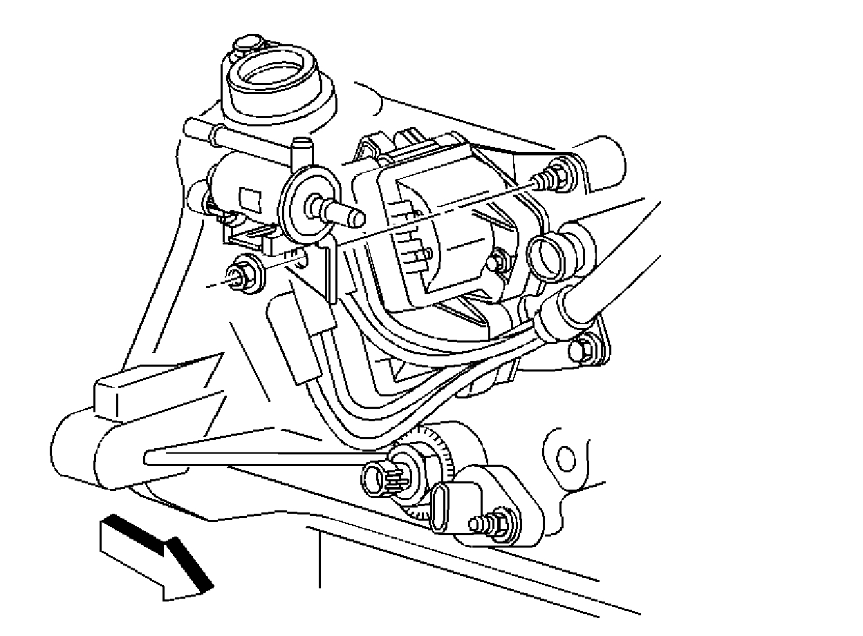

I cannot locate the purge valve on my pickup.

You have to remove the right front wheel to access it. Here are the directions for removal and replacement. The attached pictures correlate with these directions.
_______________________
PROCEDURES
EVAPORATIVE EMISSION (EVAP) CANISTER PURGE VALVE REPLACEMENT
REMOVAL PROCEDURE
1. Lift the vehicle.
2. Remove right front tire and wheel assembly.
Picture 1

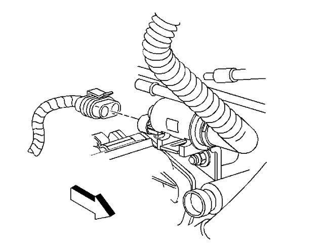

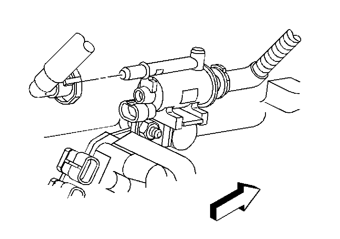

3. Disconnect the evaporative emission (EVAP) canister purge valve harness connector.
Picture 2

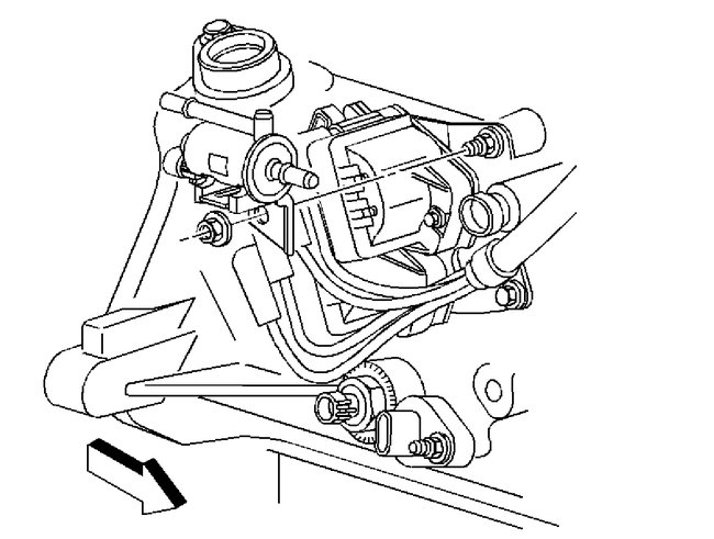

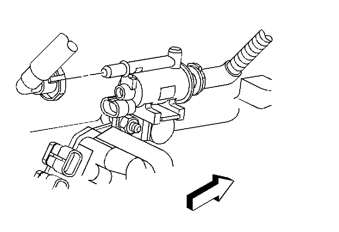

4. Disconnect the purge pipe from the EVAP canister purge valve.
Picture 3
5. Remove the purge valve nut and the purge valve mounting bracket.
6. Remove the purge valve from the purge valve mounting bracket.

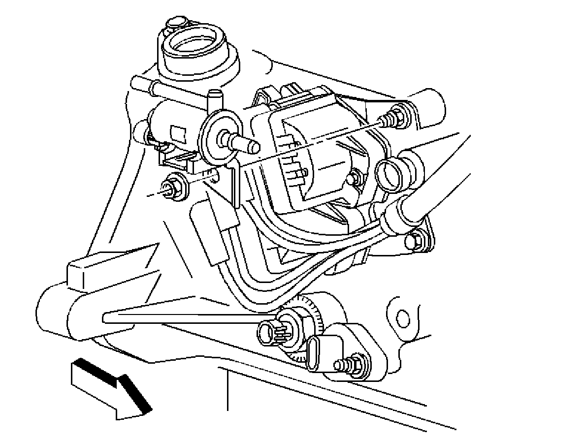

INSTALLATION PROCEDURE

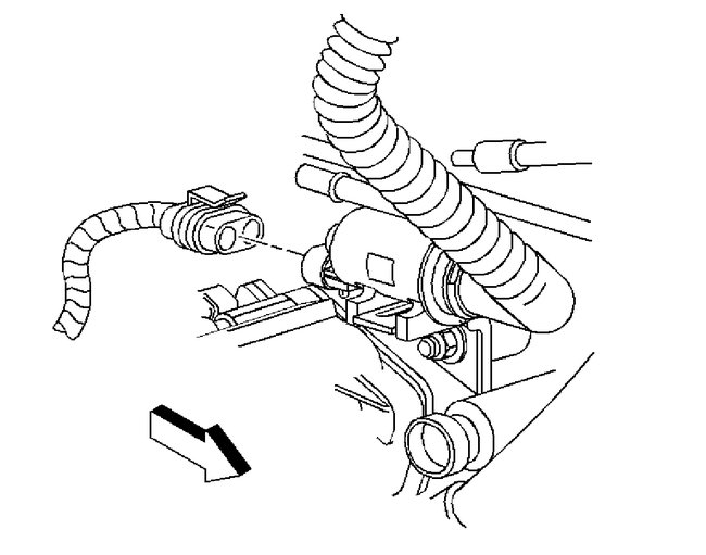

1. Install purge valve on to the purge valve mounting bracket.
Picture 4

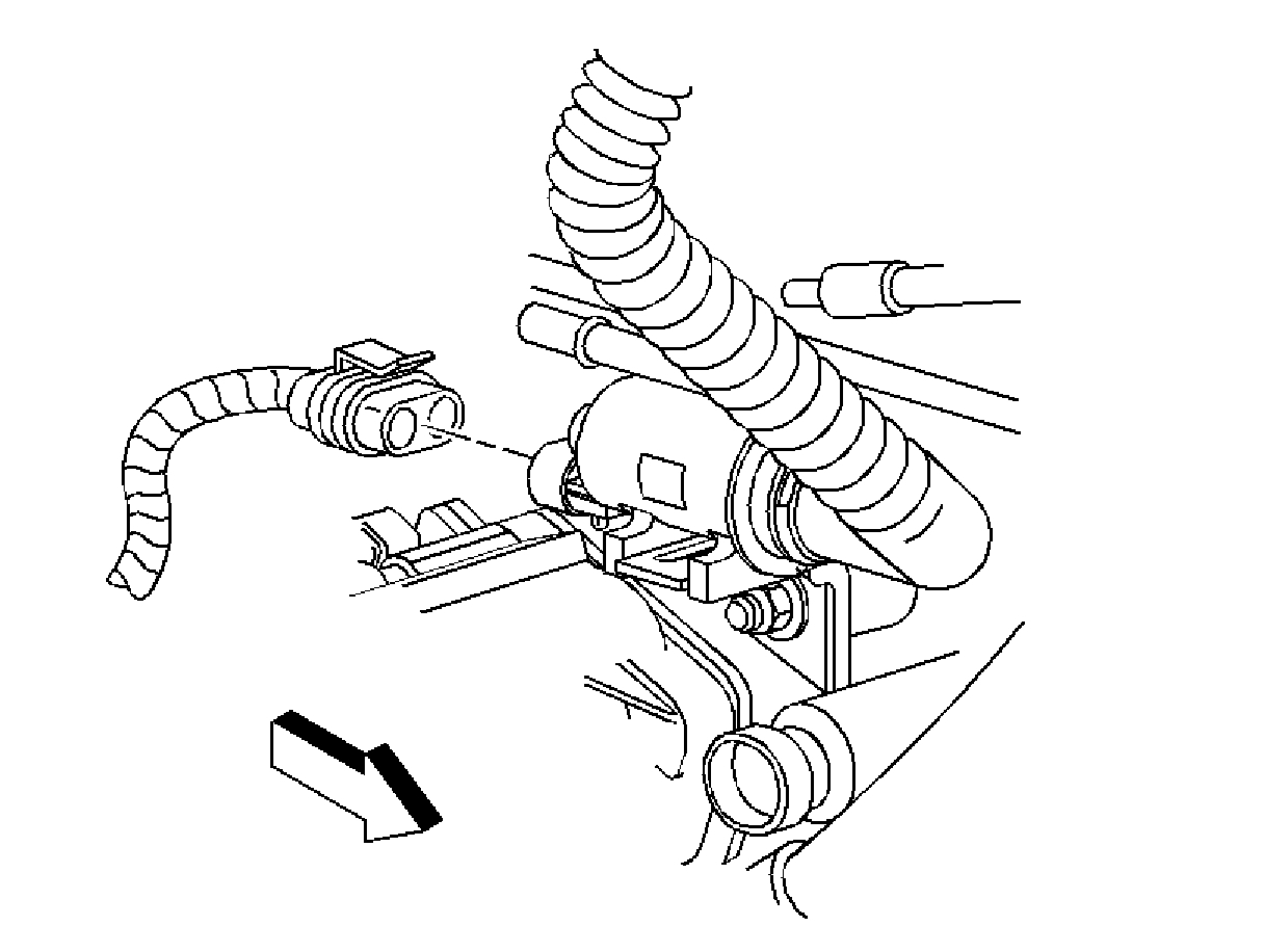

2. Install the purge valve mounting bracket and the attaching nut.
NOTE: Refer to Fastener Notice in Service Precautions.
Tighten
Tighten the purge valve mounting bracket attaching nut to 8 N.m (71 lb in).
Picture 5

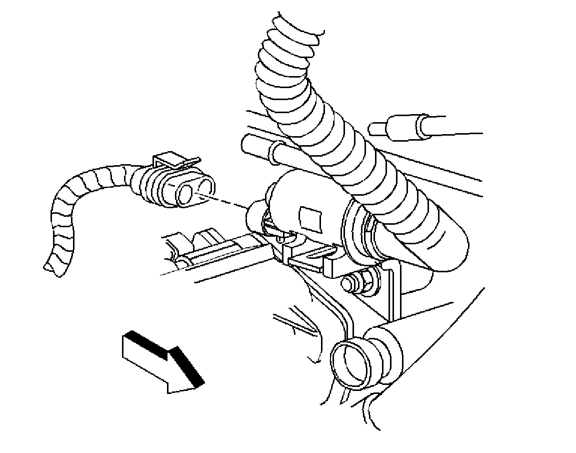

3. Slide the purge valve bracket on to the mounting stud.
Tighten
Tighten the purge valve mounting nut to 8 N.m (71 lb in).
Picture 6

Apr 1, 2019 at 12:22 PM
DEENADOLLY
Do you mean to remove the front driver side wheel and wheel well?
Apr 1, 2019 at 3:14 PM
  • 110,240 POSTS
According to the directions, you shouldn't need to remove the inner fender. It's been a long time since I did one of these. I don't remember having to remove it.
Let me know if you run into trouble.
Apr 2, 2019 at 11:54 AM
DEENADOLLY
Thanks Joe I found the purge valve. I had to remove the tire and inner wheel well on the passenger side.
