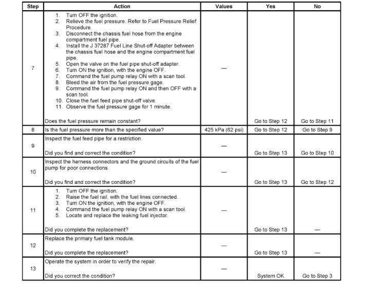

I recently changed the purge solenoid on my vehicle, but the vehicle is now running worse. When i unhook the wire thing from the solenoid. is there supposed to be a change in the motor while running?

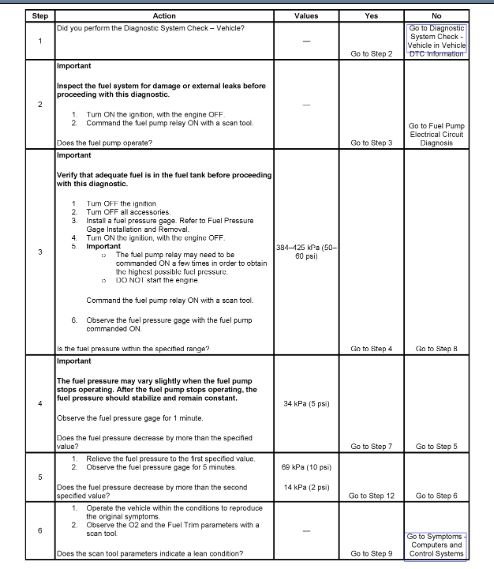

It's throwing a multiple cylinder misfires and check engine light is flashing when you go down the road. My husband changed it because he broke a piece off when changing the spark plugs and wires.
Feb 23, 2020 at 7:08 AM
Okay, thanks. that makes sense.

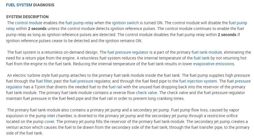

I would start by checking the fuel pressure. Low fuel pressure will cause misfires and make the engine run that way.
