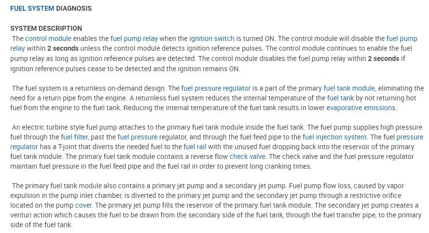

It's throwing a multiple cylinder misfires and check engine light is flashing when you go down the road. My husband changed it because he broke a piece off when changing the spark plugs and wires.
Feb 23, 2020 at 7:08 AM
Okay, thanks. that makes sense.

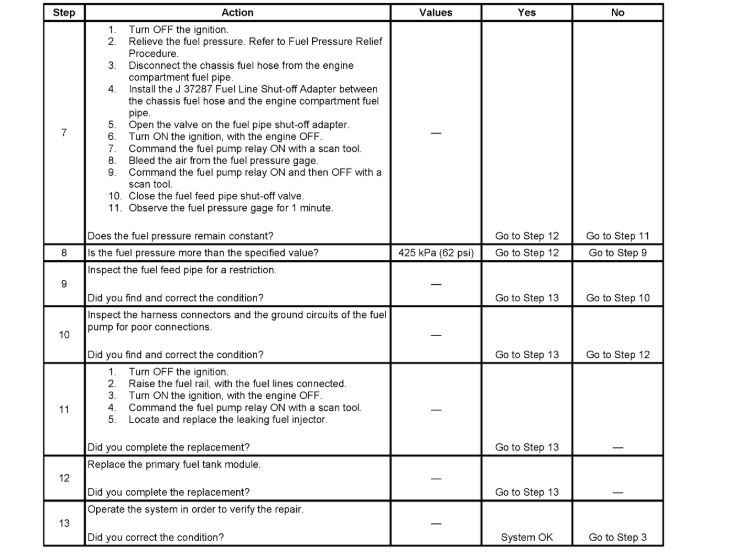

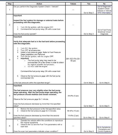

I would start by checking the fuel pressure. Low fuel pressure will cause misfires and make the engine run that way.
