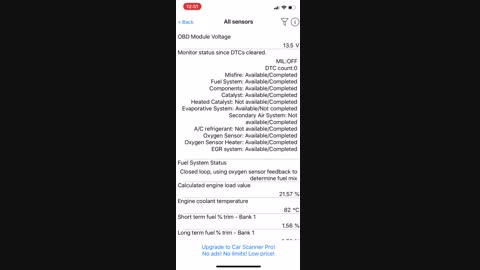

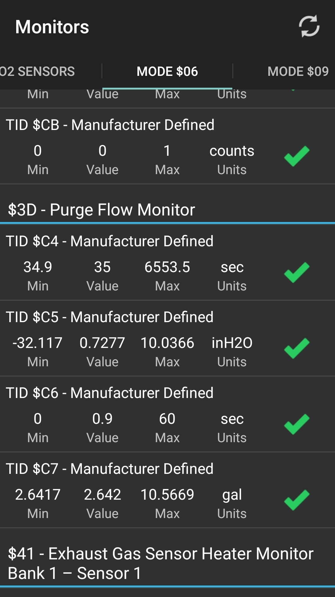

I have no check engine light. my fuel pressure holds when I checked with gauge. my jerks a little feels light a noticeable high vibration.
Mar 21, 2019 at 6:03 PM
BOBBYPUE DOPEHI
  • 40 POSTS

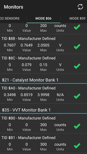

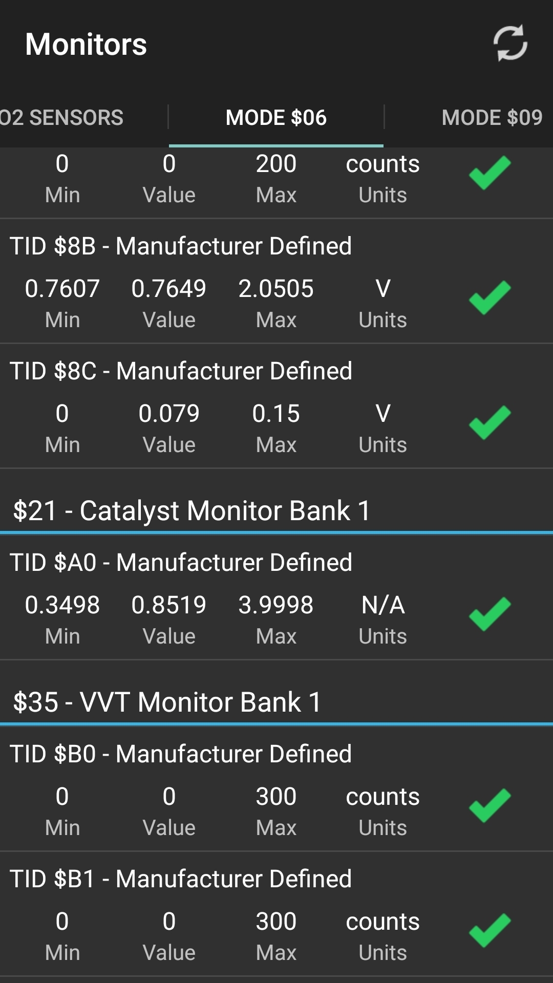

Other pictures.
Mar 21, 2019 at 6:08 PM
SCGRANTURISMO
  • 4,897 POSTS
Those all look good to me. Did you have a question that you wanted to ask?

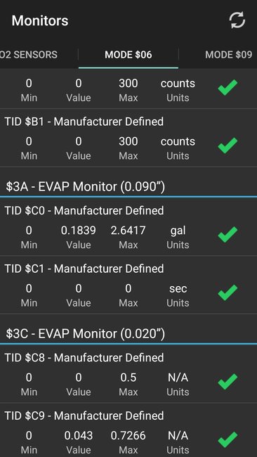

The purge flow monitor min and value, the value is higher then the min, I have champion spark plugs, not AcDelco, and new coil pack and a new mass air flow sensor, but the car shivers in a high pitch while driving from engine department when it's in park shiver is 80% less noticeable.

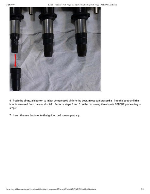

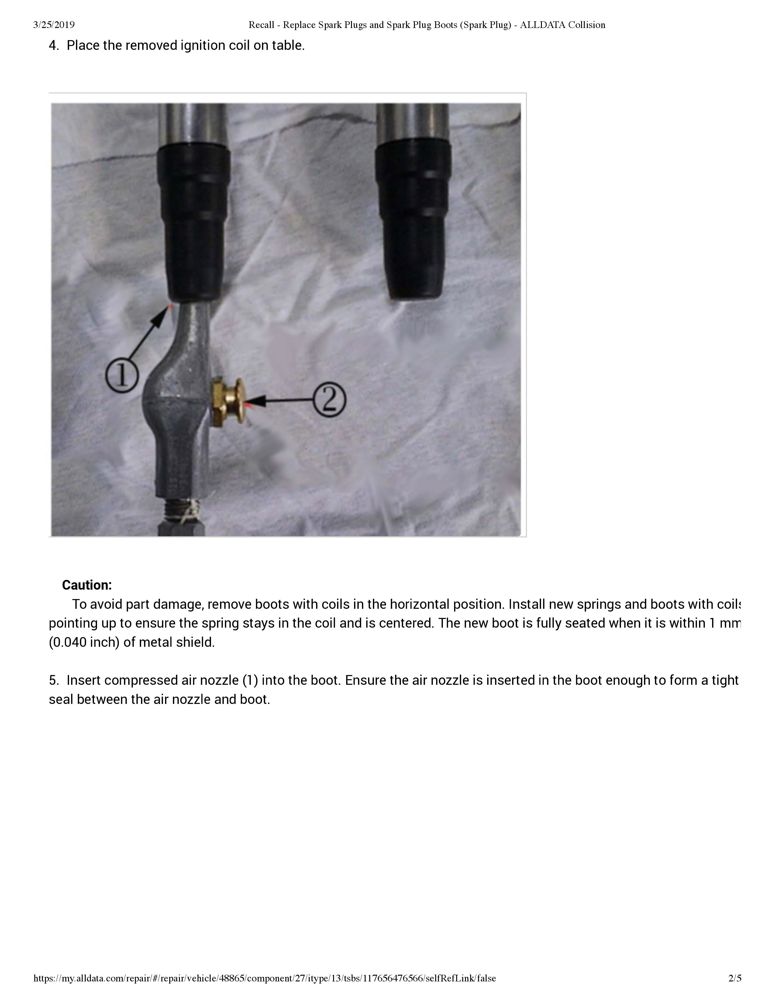

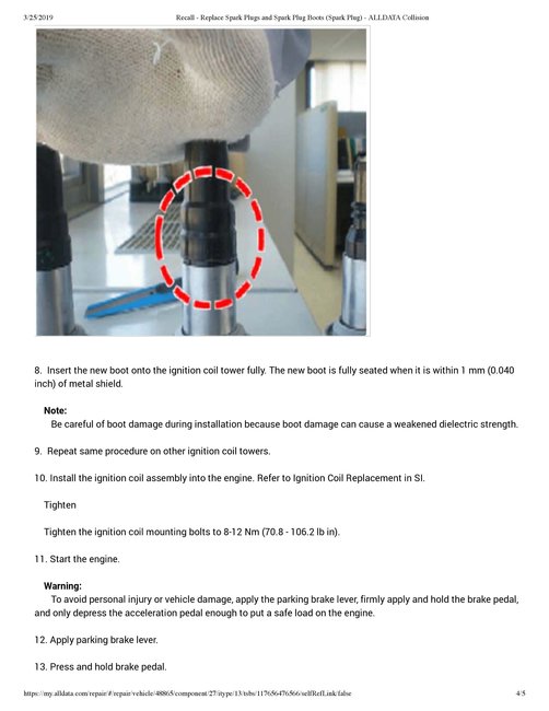

Hey BOBBYPUE DOPEHI,

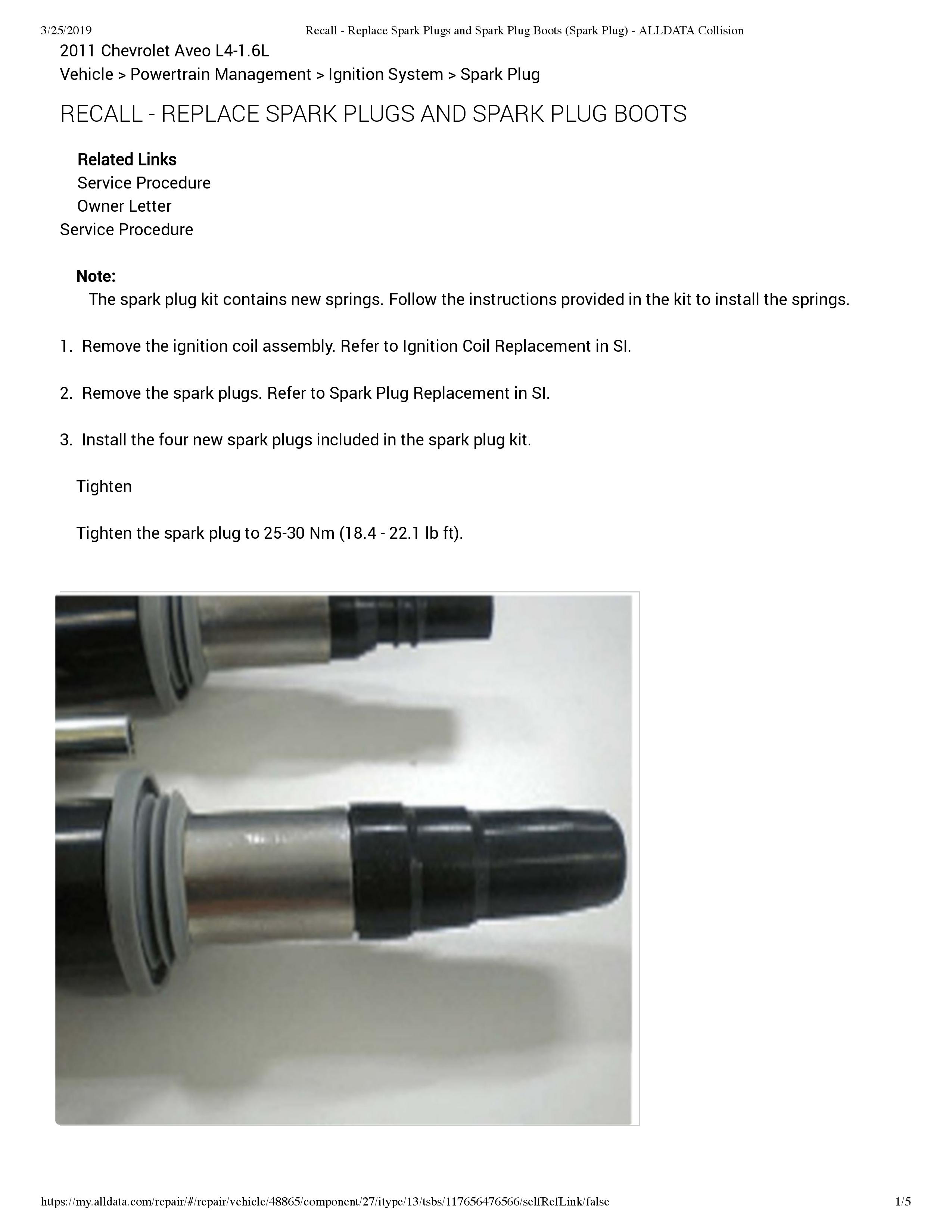

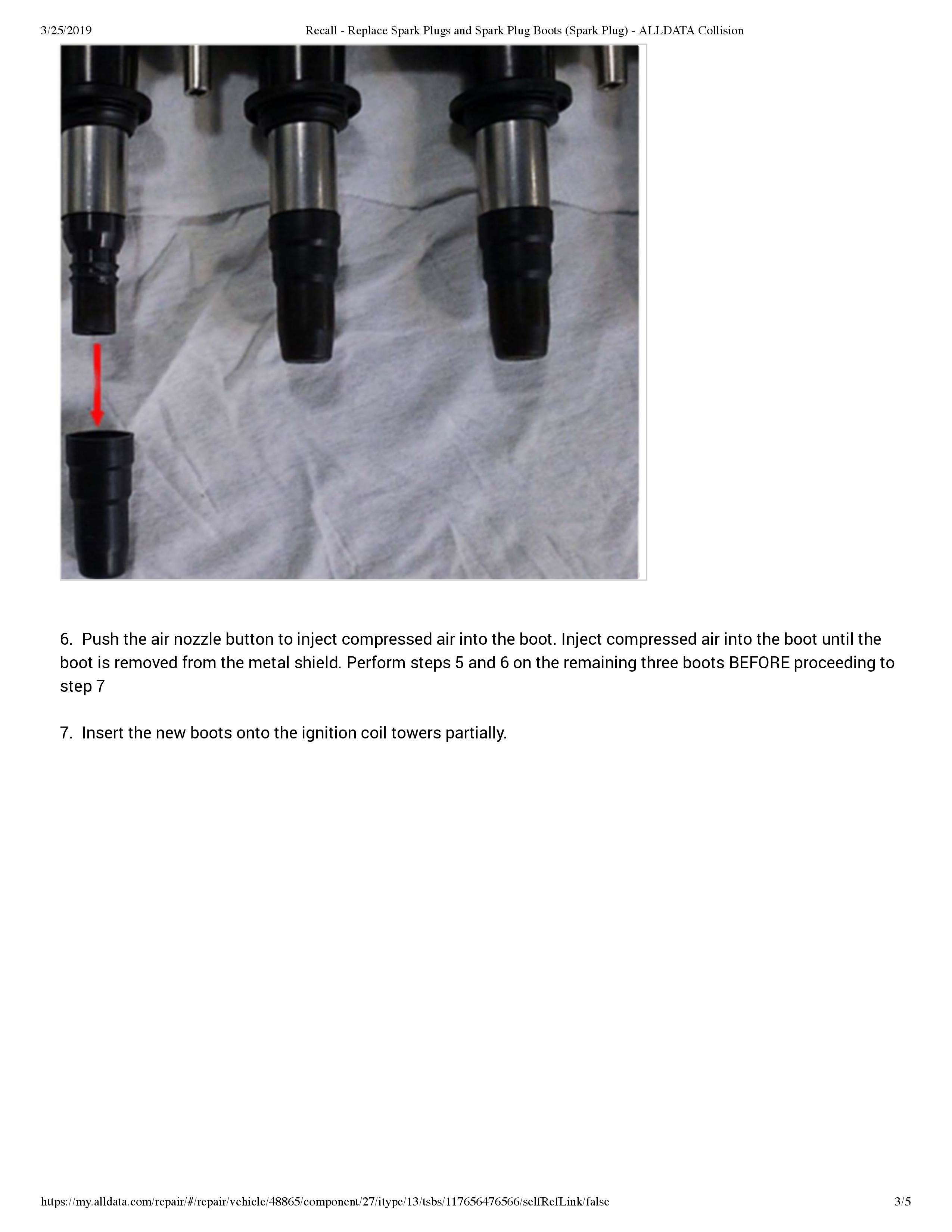

There is also a recall applicable to your vehicle. This is to replace spark plugs and spark plug boots.
I have attached the information for this.
If you contact a chevy dealer they may be able to carry out this recall free of charge.
Regards, Joe
Mar 25, 2019 at 9:30 AM
BOBBYPUE DOPEHI
  • 40 POSTS
I checked my vin kl1td6de9bb131940. I don't see the recall do you have a link etc.
Mar 27, 2019 at 5:44 PM
BOBBYPUE DOPEHI
  • 40 POSTS
Dealer checked and it was performed in 2012. Thanks.

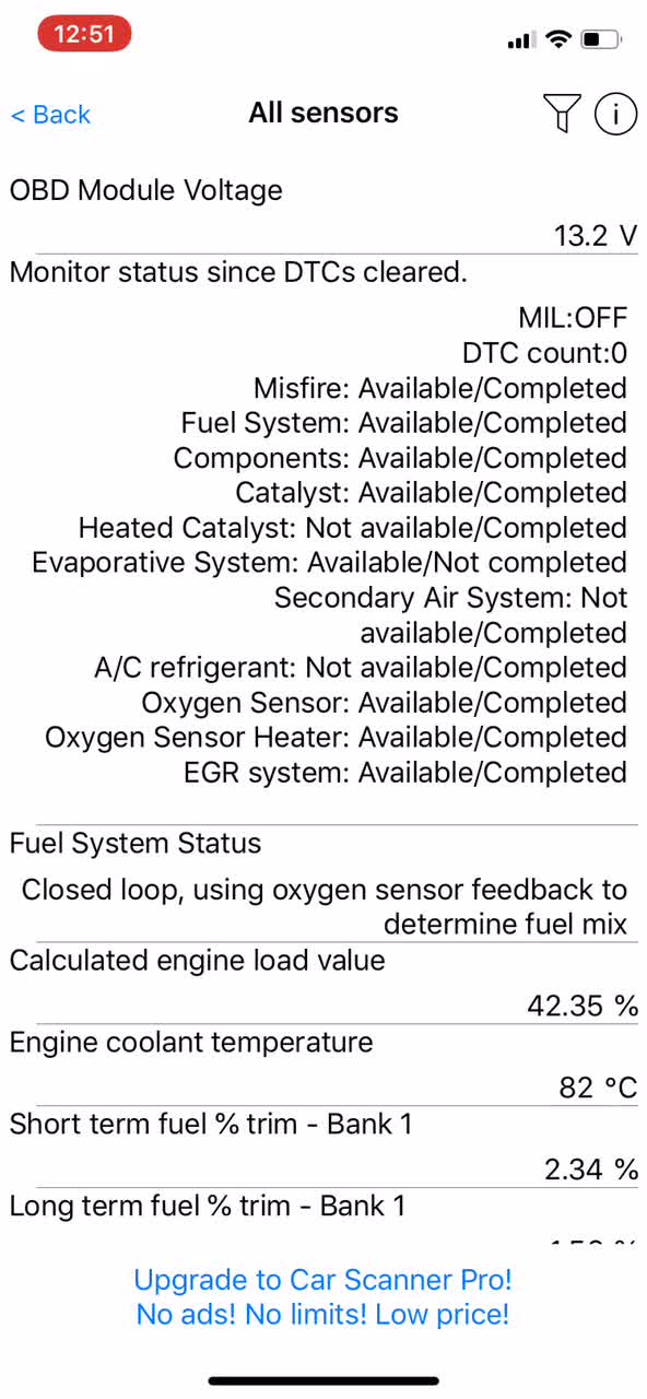

Can you please provide a current list of fault codes you have stored?
If you delete the codes and drive the vehicle what do you have after this?
Regards, Joe
Mar 28, 2019 at 10:27 AM
BOBBYPUE DOPEHI
  • 40 POSTS
This is my second coil pack put on I added four AC Delco spark plugs my car feel like it has a misfire also coming from a rolling stop with the AC on the car jerks forward and backwards with my foot firmly on accelerator. so I added two videos. Any input would be greatly appreciated. thank you.
