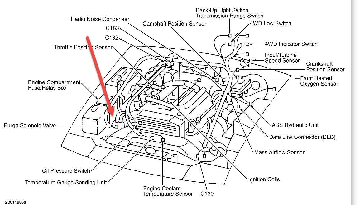

How to remove a purge canister.
Jan 16, 2017 at 3:52 AM
HMAC300
Experienced Mechanic
48,601 POSTS
see picture where it is mounted. disconnect electrical and vacuum lines. then should be a bracket holding it bolted to frame.
