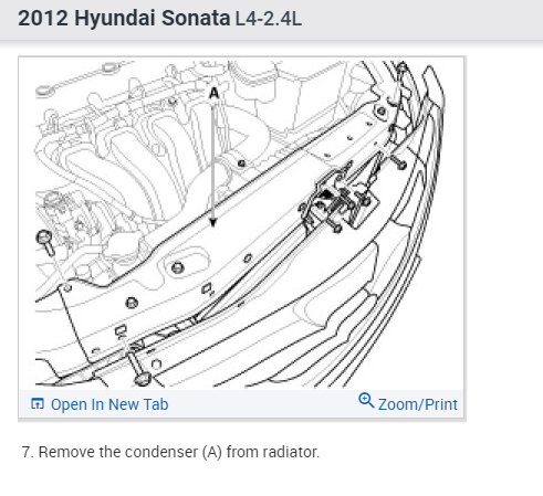

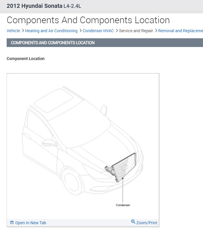

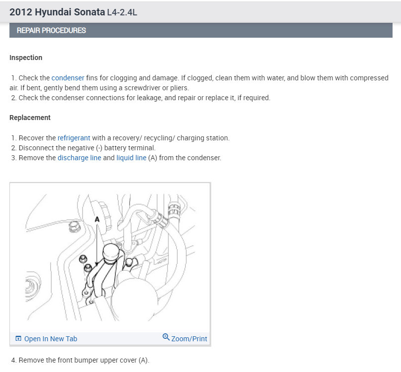

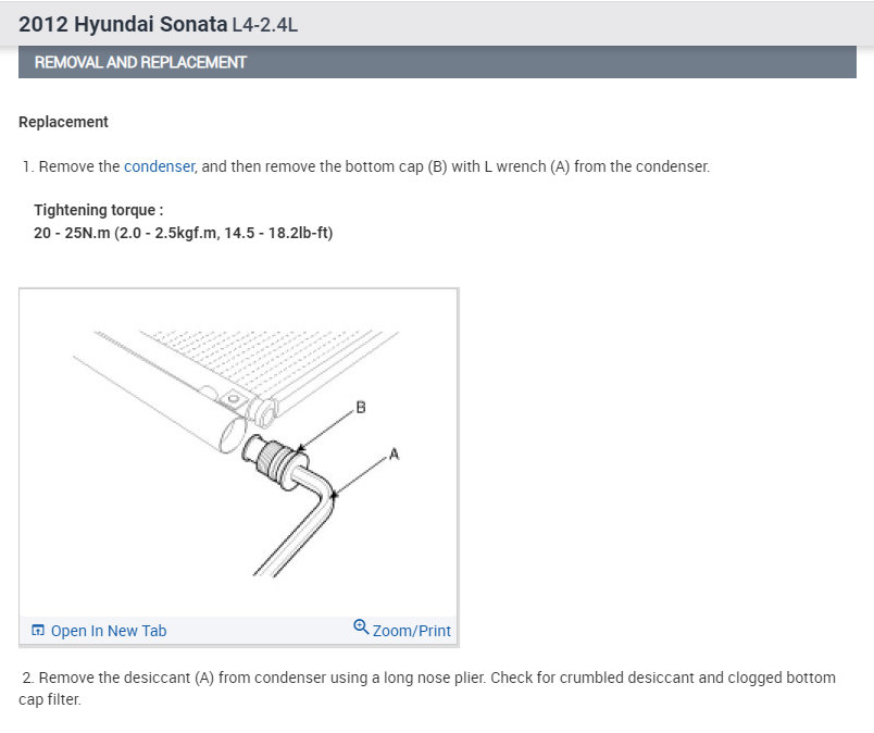

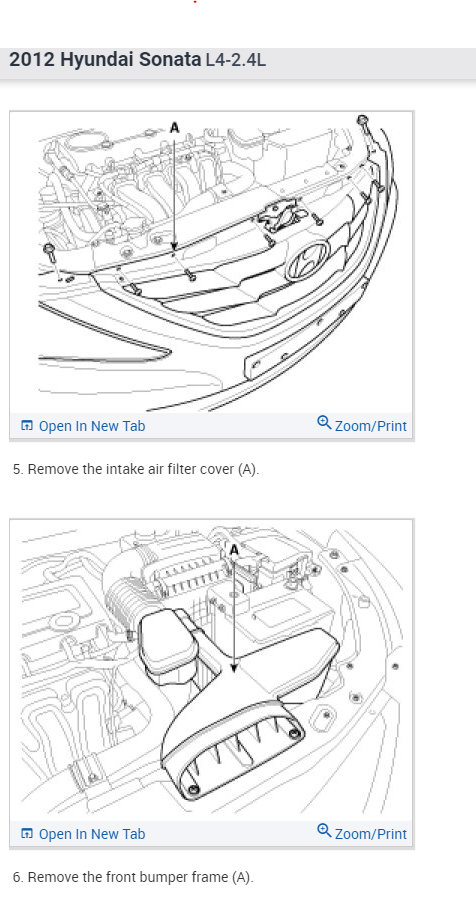

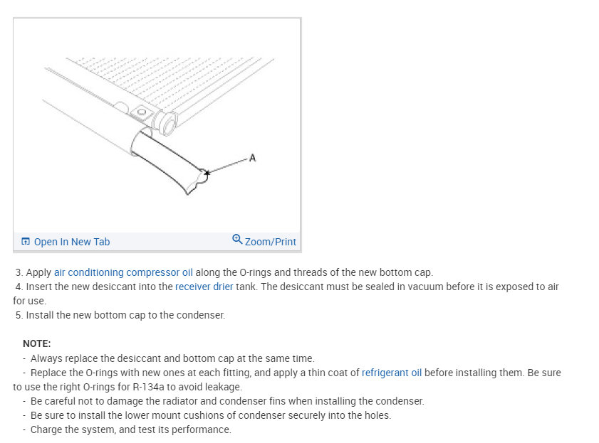

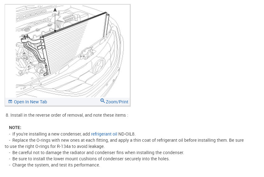

My condenser for A/C got punctured while replacing the radiator. All the refrigerant has leaked out. I would like to replace the condenser by myself and then bring it to mechanic to fill the A/C refrigerant. Do i need to replace the dryer bag since it has been exposed to air? What should i do? the car is stuck in my garage because the radiator is also removed?
Mar 10, 2022 at 4:26 AM
SQM
  • 6,383 POSTS
Yes, it will be a good idea to replace the dryer. Any time the system gets opened, changing the dryer is ideal.
I have attached the condenser replacement procedure below for your reference.
