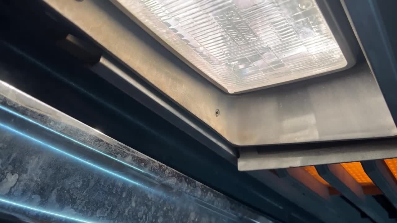

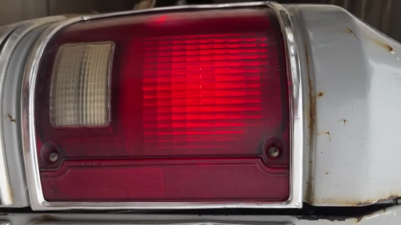

I have a separate wiring harness for the headlights, that pulls power from the battery, but still pulses. Alternator? Bad ground? Any thoughts?

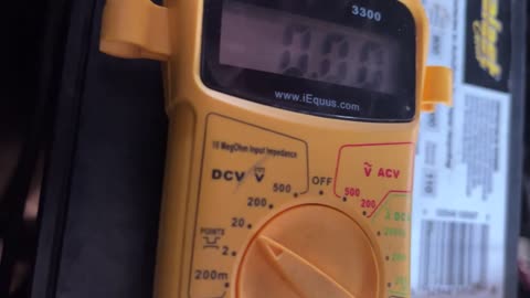

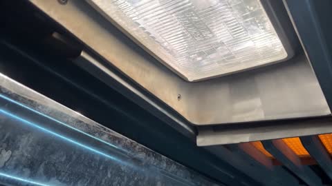

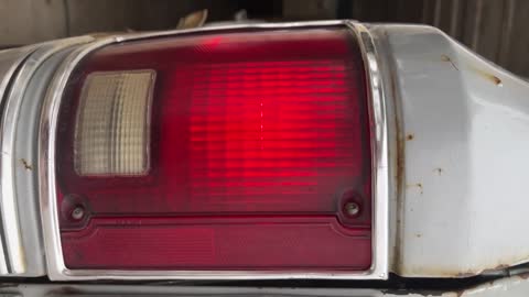

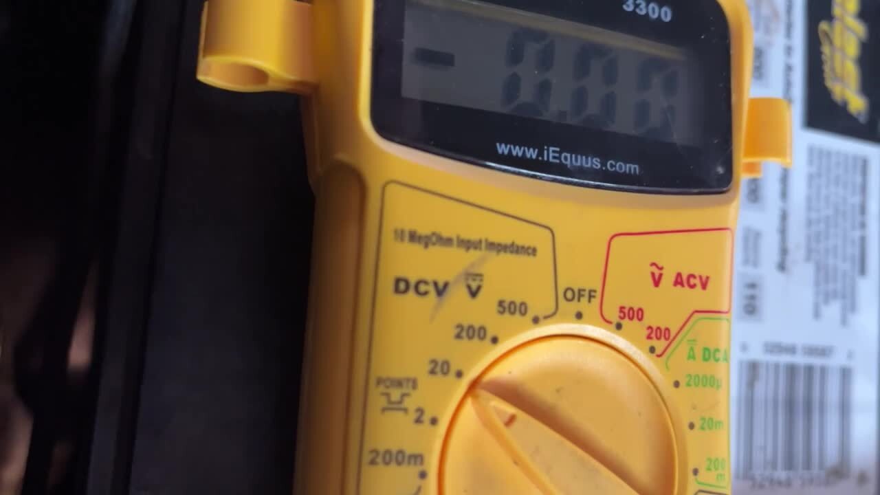

Thanks Joe. Here are my test results: battery without the engine running: 12.3; battery with engine idling: 15.56; battery with heater on full, lights on, and radio on: 15.1-15.3. I’ve tried to show you the pulsing in the videos.

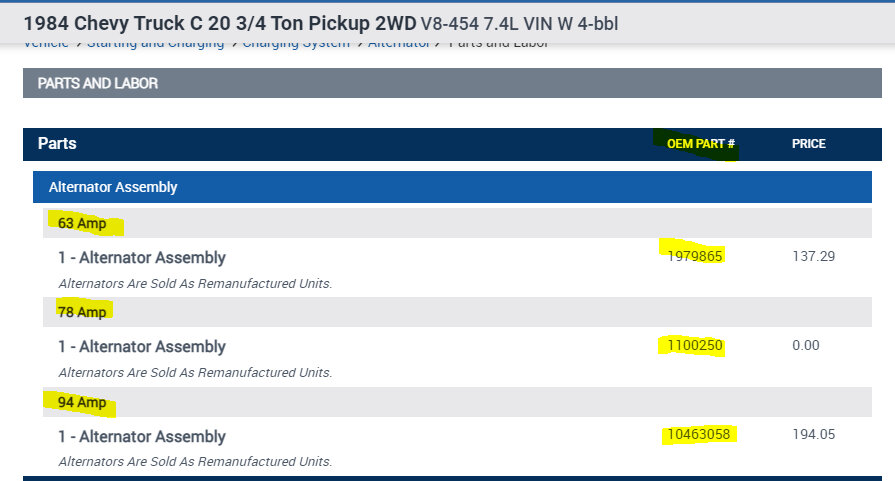

Do you know which one is on the vehicle presently? There were three options. 63, 78, 94amp. What it came with I would recommend.
If you look at pic 1 below, I attached the OEM part numbers for each amperage. See if you can locate the part number so we know for sure what you have.

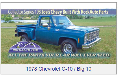

Also, it really makes me happy to hear someone is working on the old square-body trucks. If you look at pic 2, I restored that one in 2000. It was picked by Rockauto for a magnet. LOL
