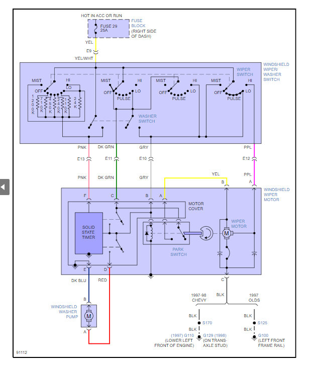

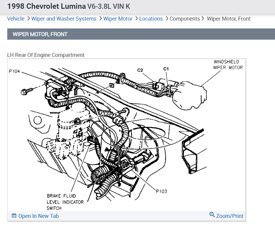

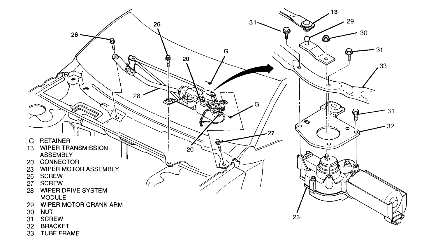

put in new pump, nothing. I think it's the solid-state timer. Where is that located? Is it next to the wiper motor? which is up close to the firewall. no pulse wipers but i do have low and fast wipers. when i push that half circle forward on the control wipers do come on for short period like they should but no washer fluid shots out... Thank you for any help.
Aug 22, 2022 at 8:49 AM
  • 55,433 POSTS

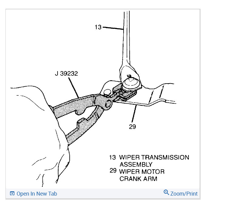

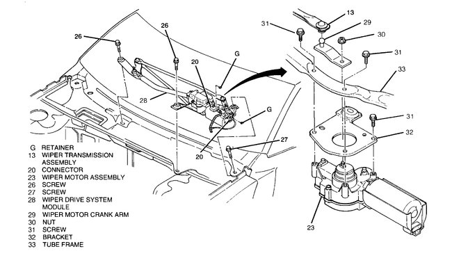

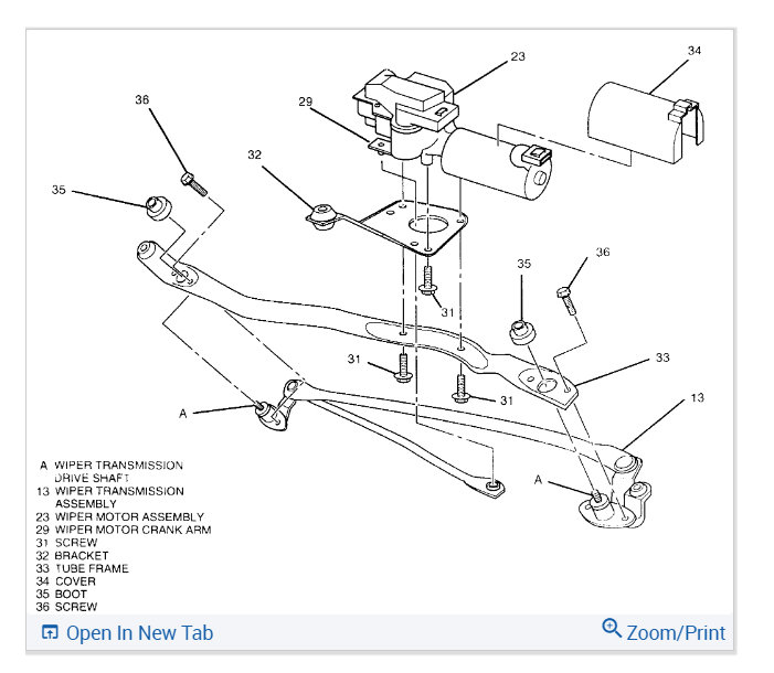

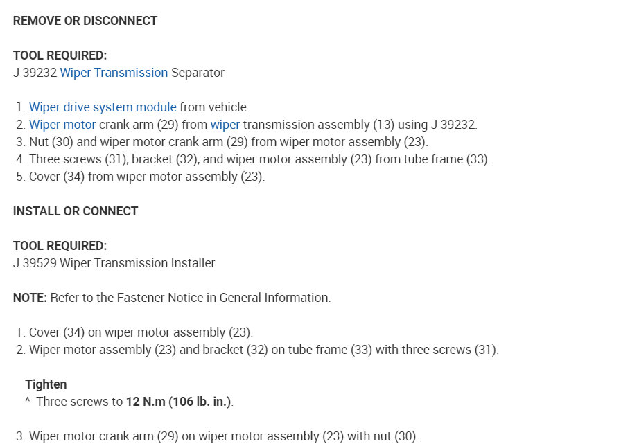

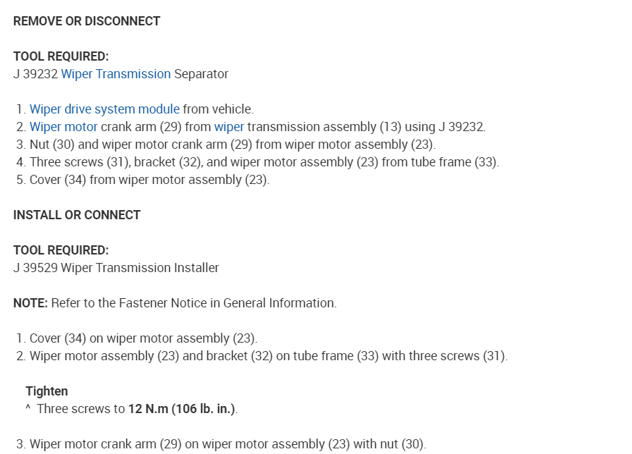

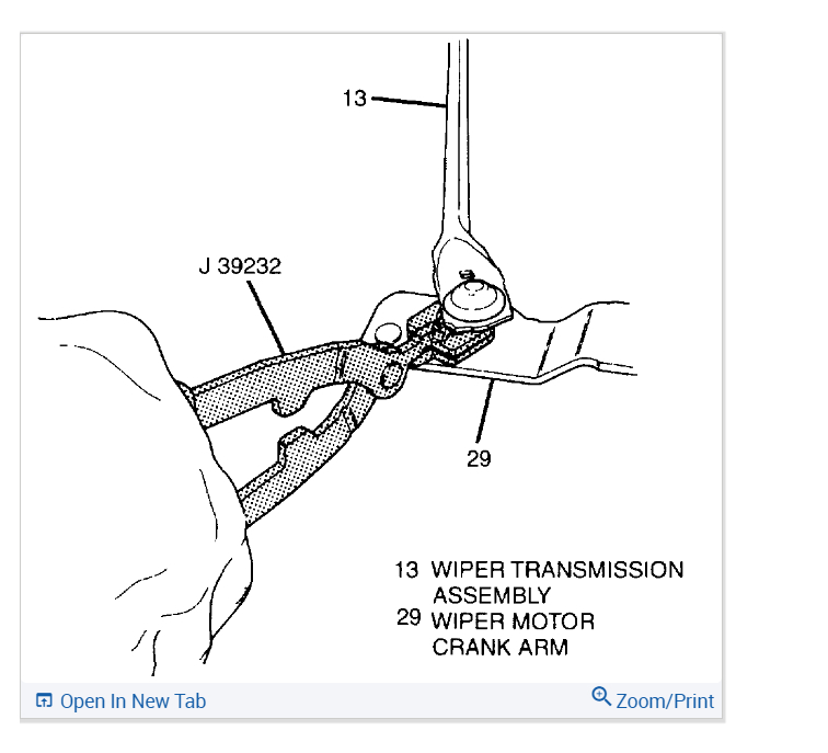

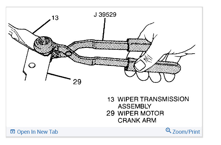

Here is the wiring diagrams for the wiper so you can see how the system works, as you can see it is pretty simple. The control module is on the wiper motor itself so you will need a new or rebuilt motor. I would check Rockauto.com
Also here is a guide to help you check the power output of the switch, which is the only other thing it can be, use the wiring diagrams to help see which wire does what.
Check out the diagrams (below). Please let us know what you find.
