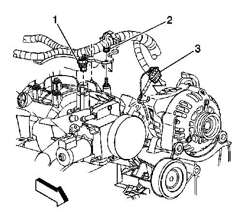

While I drive down the road or sit at a stop my dash lights and headlights pulsate. I have check all the grounds replaced the battery to no avail. Just yesterday the truck gave me a system message battery not charging and you can watch the AMP meter just fall and lights dim after I take the jumper cables off. What else should I try? Any help would be great!

Hi and thanks for using 2CarPros.com. It sounds like the alternator/regulator is bad. Here are general directions for checking:

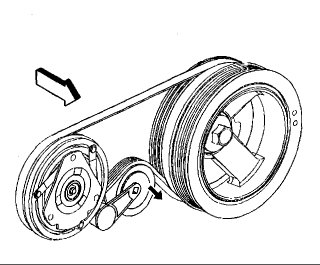

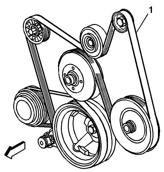

Remove the accessory drive belt.

Disconnect the generator electrical connector (3).

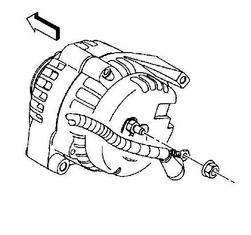

Remove the generator cable from the generator, perform the following:
Slide the boot down revealing the terminal stud.
Remove the generator cable nut from the terminal stud.
Remove the generator cable.

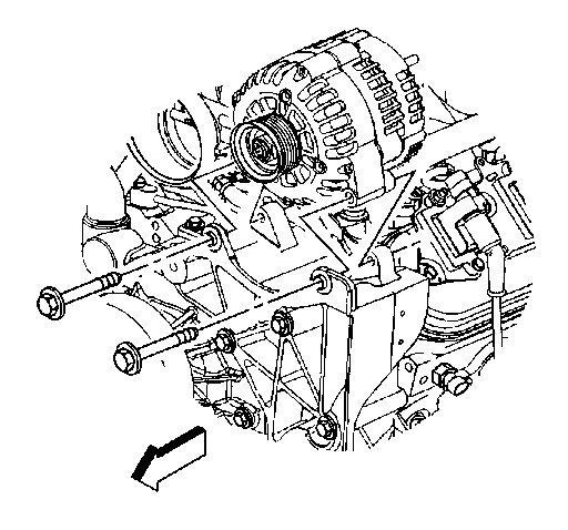

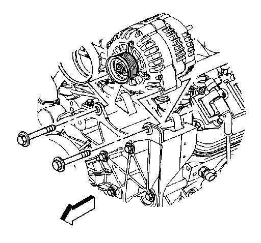

Remove the generator bolts.
Remove the generator.

Install the generator bolts.
Tighten the bolts to 50 N.m (37 lb ft).
Install the generator cable to the generator, perform the following:
Install the generator cable.
Install the generator cable nut to the terminal stud.
Tighten the nut to 9 N.m (80 lb in).
Slide the boot over the terminal stud.

Install the accessory drive belt.
I've also attached belt routing diagrams for you.
