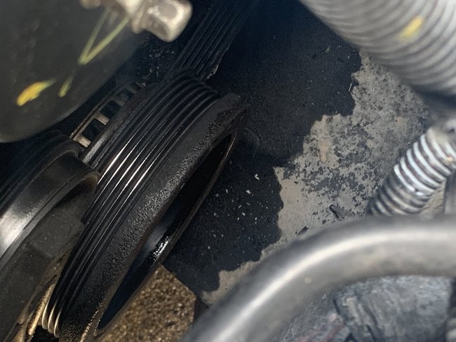

I am hearing a squeaking sound and when i looked the belt wasn't all the way on the harmonic balancer. when i push or pull on the HB it is very loose. Is there a way i could tighten it or do I need a new one?
Nov 13, 2019 at 11:35 AM
Good afternoon,
The balancer has to be replaced. There is a rubber bushing internal that has failed and this is the result. It may also make a knocking noise cranking or running.

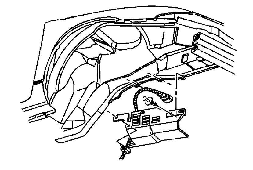

5. Remove the right engine splash shield retainers and the engine splash shield.
6. Remove the torque converter cover.

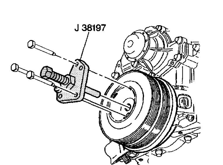

7. Install the J 37096 to hold the flywheel.

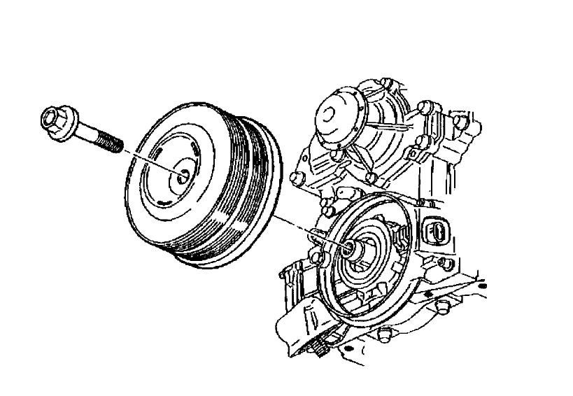

8. Remove the crankshaft balancer retaining bolt.
Important: Do not separate the crankshaft pulley from the crankshaft balancer. Service the crankshaft pulley and the crankshaft balancer as an assembly.
9. Install the J 38197-A.
10. Remove the crankshaft balancer.
11. Remove the J 38197-A.
