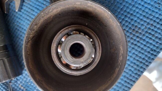

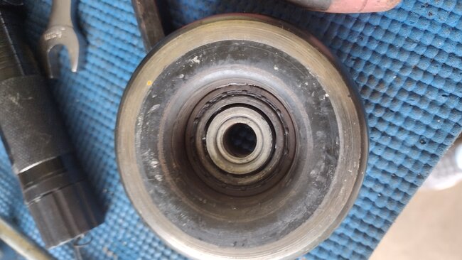

Can someone tell me which side of the pulley faces the engine before I put this thing back together?
1998 NISSAN ALTIMA
105,000 MILES • 2.4L • 4 CYL • 2WD • AUTOMATIC
JC-842
  • 181 POSTS
I saw a video and the opened/recessed side is facing out instead of in. Are different years install different? I'd swear the pulley was installed with the solid facing out. I saw videos of a few years newer model with the open side facing away from the engine. This engine has the enclosed bolt permanently enclosed inside the block. The pulley slips over the bolt held on by a 14.mm # 10 nut. I don't want to do this job but once ( ever). Thanks, Jc

Putting the old pulley and the new pulley face to face and back-to-back there is a slight difference in the two. The newer pulley is slightly thinner width way the overall circumstances are pretty much the same. I used the old bearing race in the new bearing because the new one came without a race.so as the orientation of the pulley i put it back the way it was when i removed the old pulley... I started it up and it appears to be running straight and true no wobble a very slight noise at first but appeared to go away after 10 minutes of sitting idling i guess i'll keep a close eye on it and if the noise comes back or gets loud i'll know something is wrong. I'm kind of wishing i'd bought OEM the new pulley was a Gates. But i'm convinced the minute size difference was so small that it won't be an issue. Do you know how you would remove and replace the bolt that holds that pulley on? It fits in a hole in the block and has a particularly weird design. I mean if that bolt were to have excessive wear, or it broke you could not replace the pulley. What then? Thanks. JC
