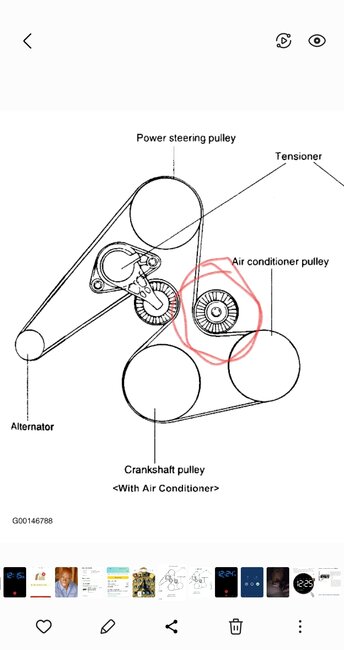

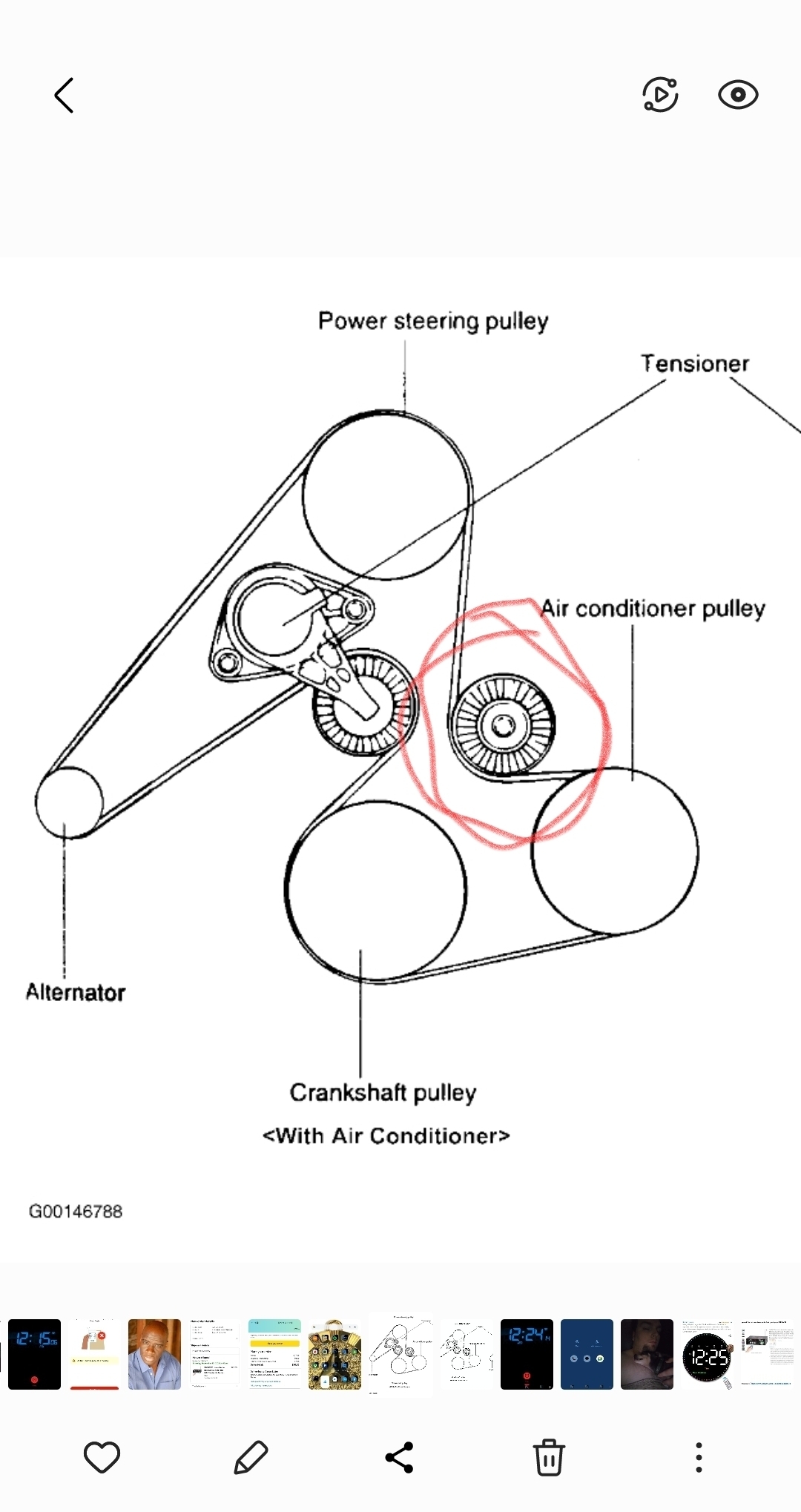

I'm just curious what the name of the pulley is next to the air conditioner pulley. It's wobbly and I need to replace it. I have circled it in the picture.

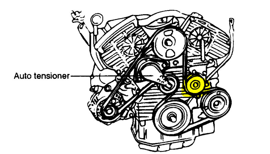

That is an idler pulley. Basically, it does nothing more than direct the belt in a needed direction. In this case, the positioning causes an increase in the belt to pulley surface area for the compressor. I attached a pic below and highlighted the pulley I believe you are referring to. If that is incorrect, let me know.
Let me know if that helps or if you have other questions.
joe
See pic below.
