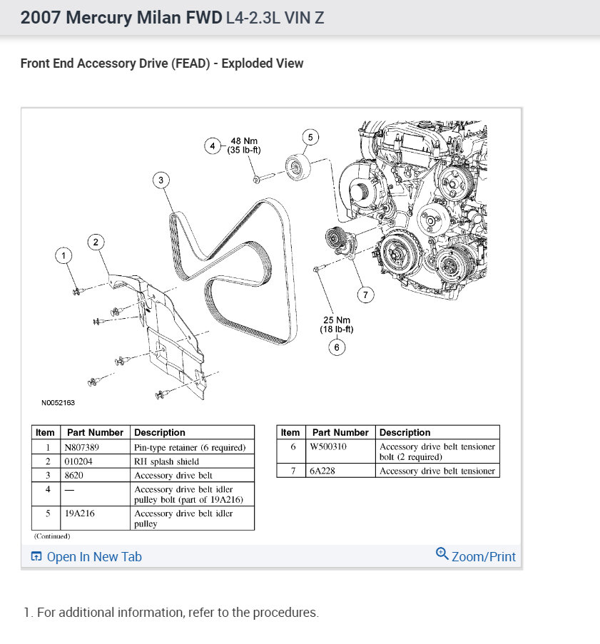

Hello, I want to know if you all have any diagram on how to change an idler pulley on my vehicle listed above.
Mar 22, 2023 at 3:00 PM
  • 55,594 POSTS

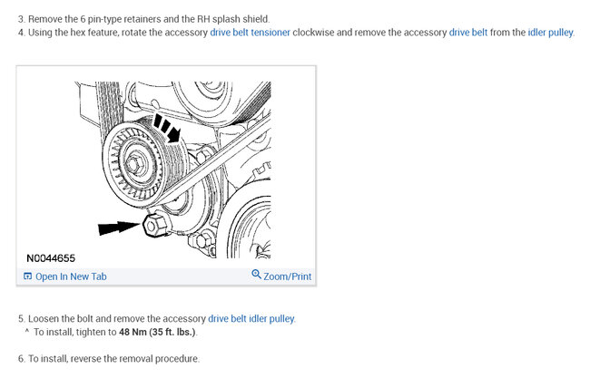

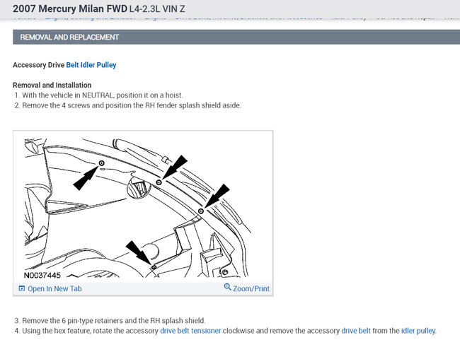

Sure, here are the instructions on how to change out the serpentine belt idler pulley. Check out the images (below). Please let us know if you need anything else to get the problem fixed.
