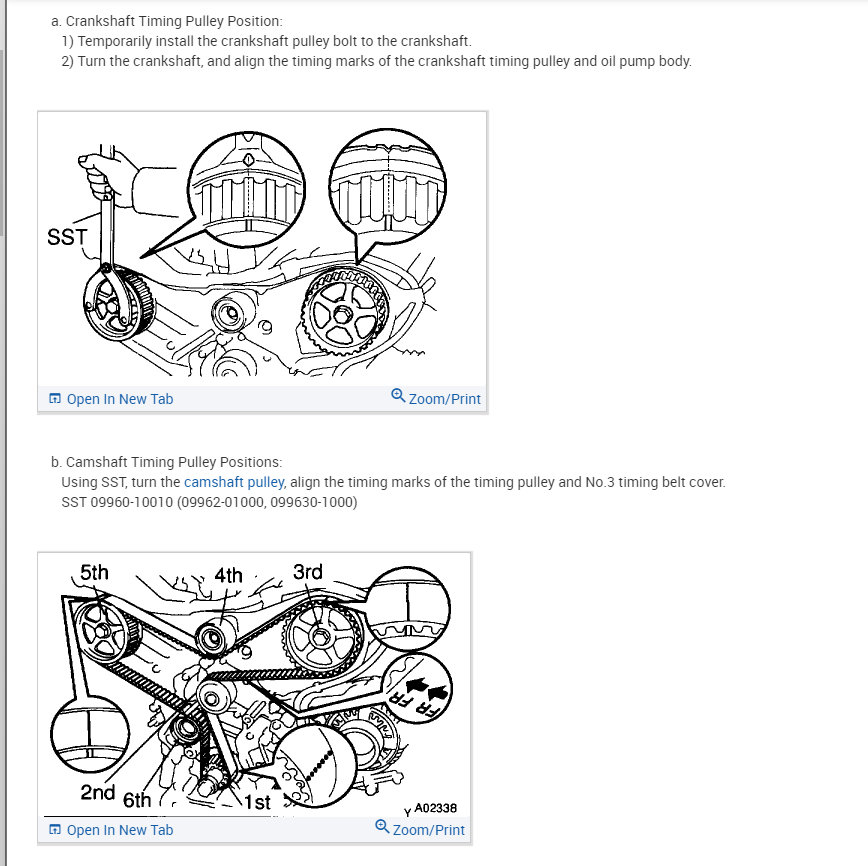

Hi, I am trying to diagnose cause of an Propane/LPG inlet manifold backfire under load, usually when accelerating hard in top gear, does not seem to backfire when accelerating hard in a lower gear.
Any guidance/advice welcome.

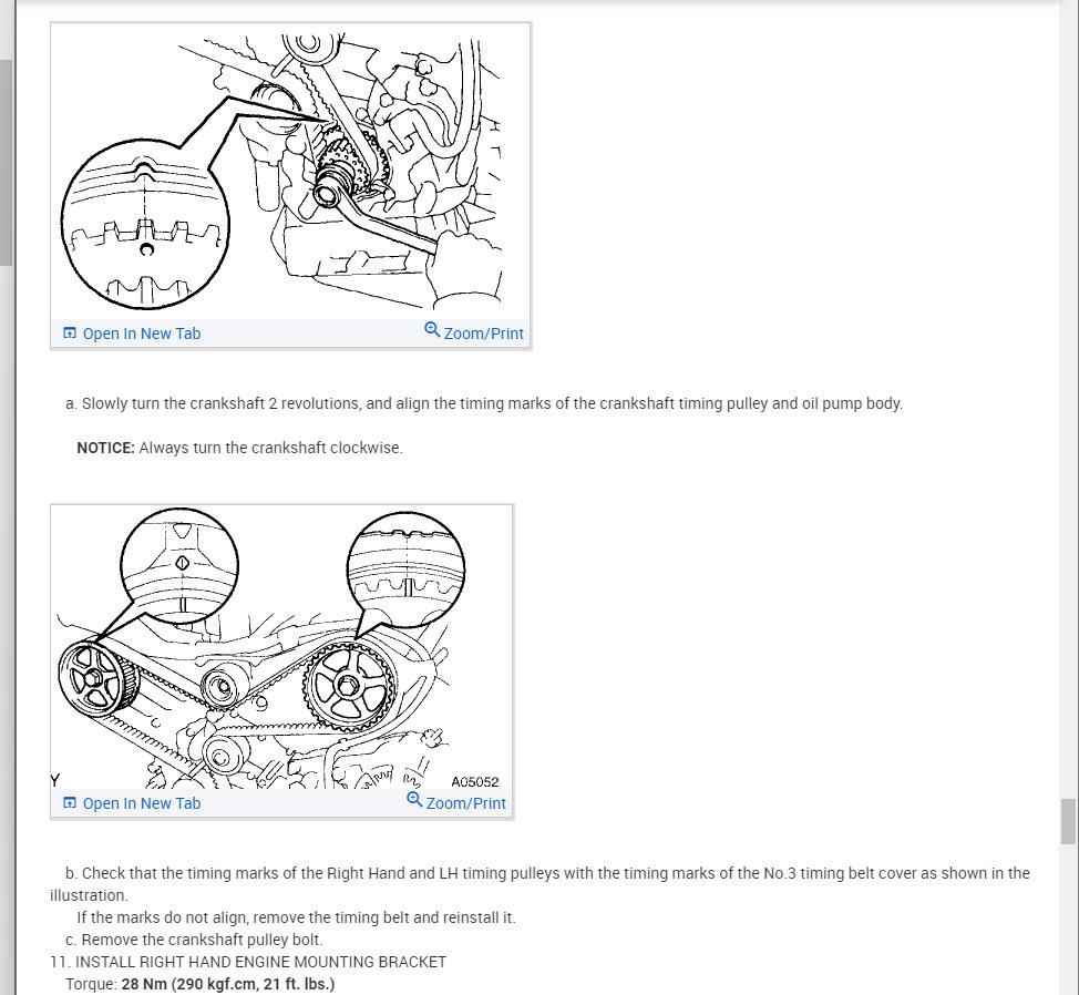

This normally does not have anything to do with the fact that this is an LPG vehicle unless you have a leak in the intake and this gas is igniting in the intake.
However, the fact that you only have this at higher gears means we have a lighter load on the engine, I suspect this is just a poor ignition issue or possibly timing issue.
Here is a video that will get us started.
https://youtu.be/HiI_eeFg-2A

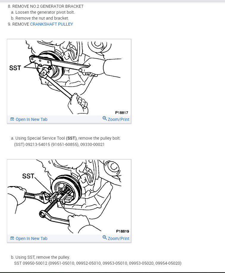

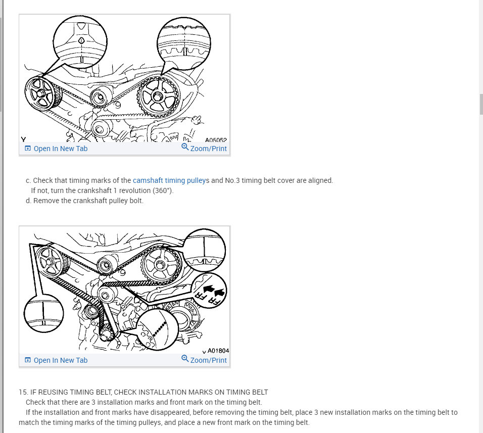

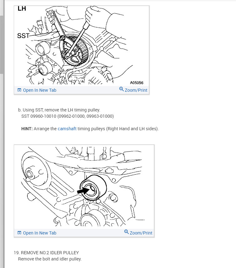

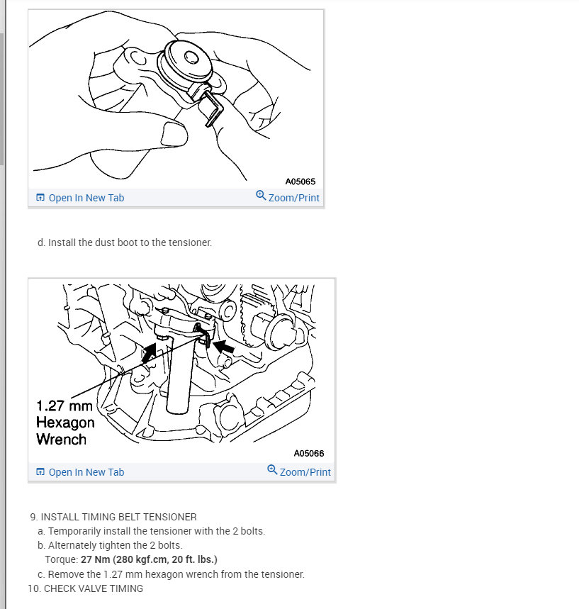

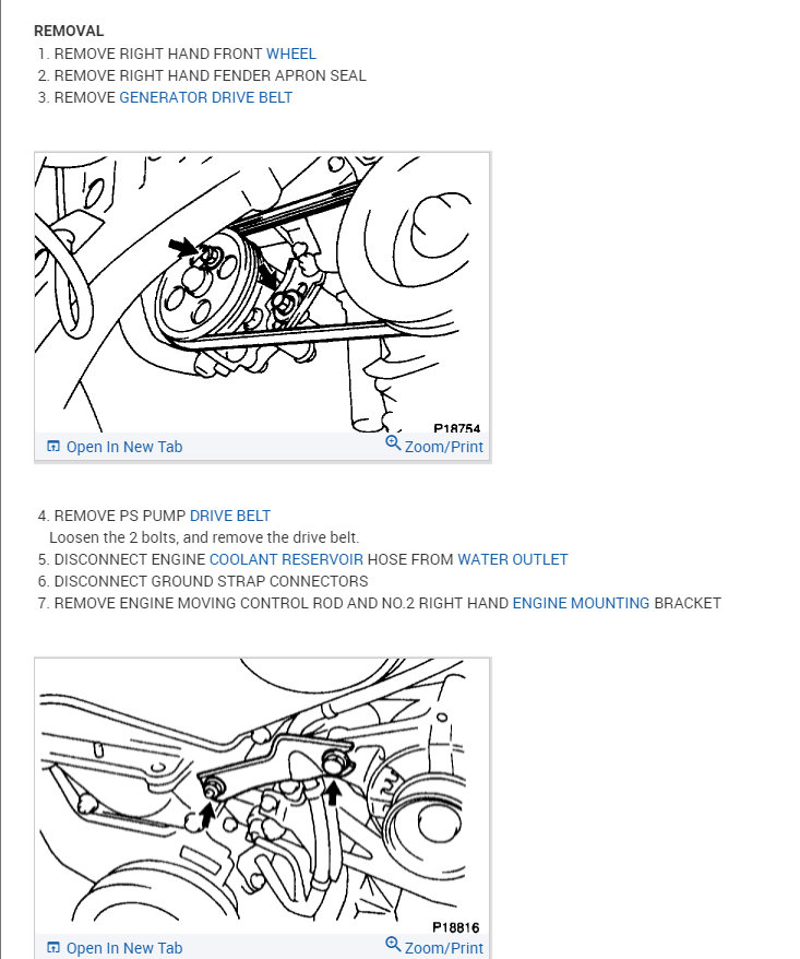

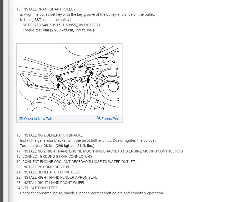

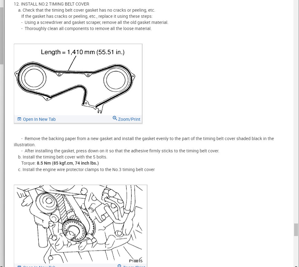

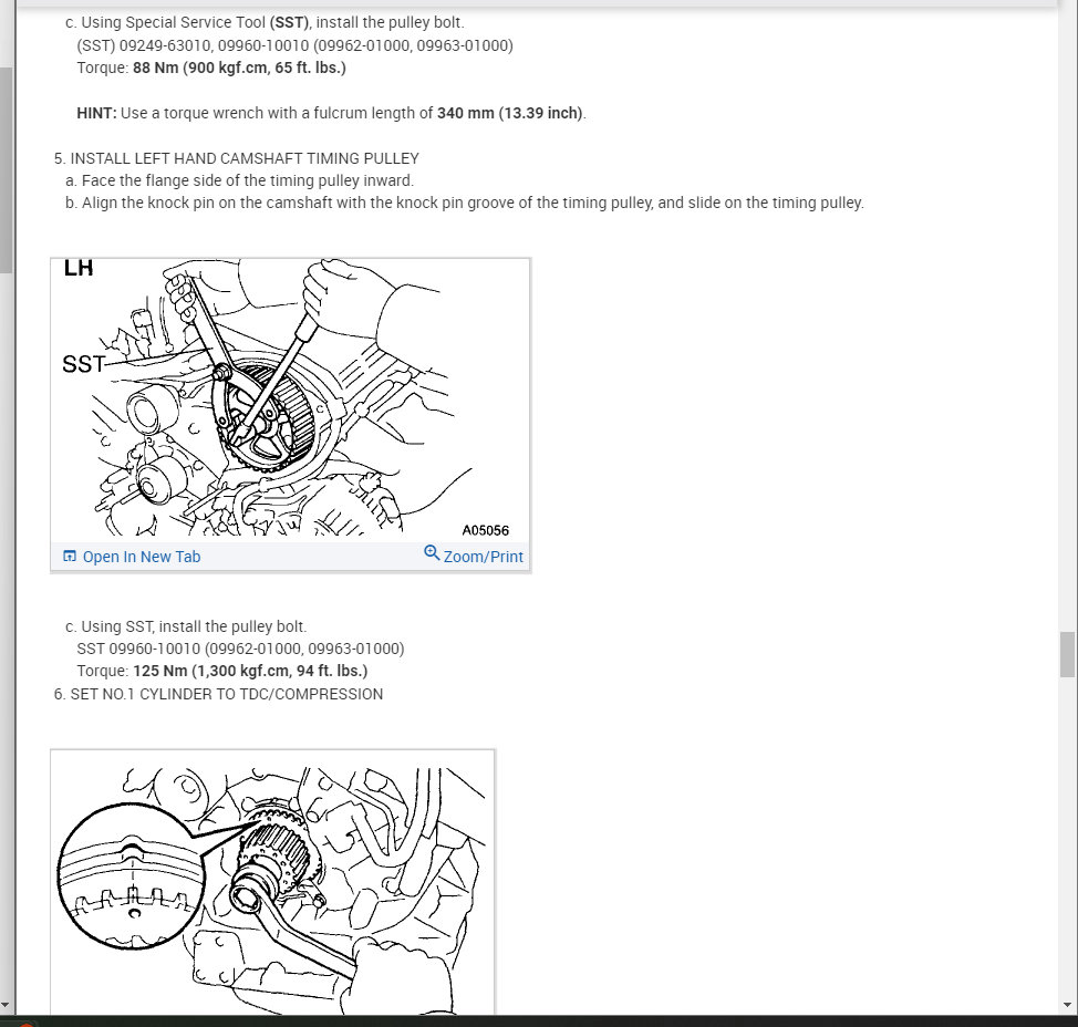

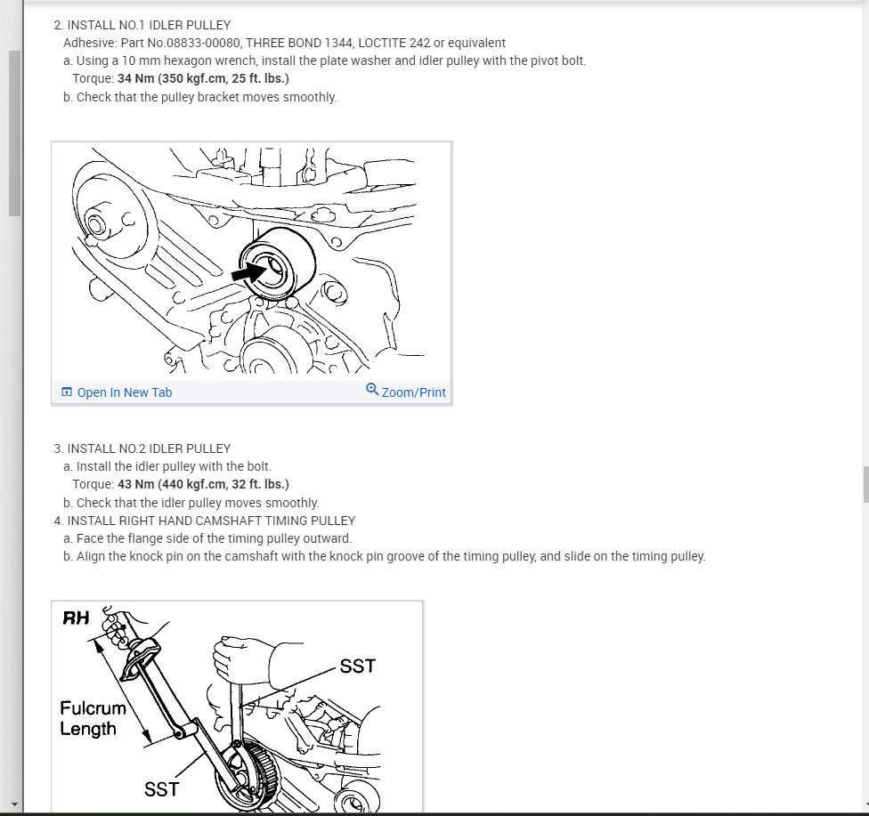

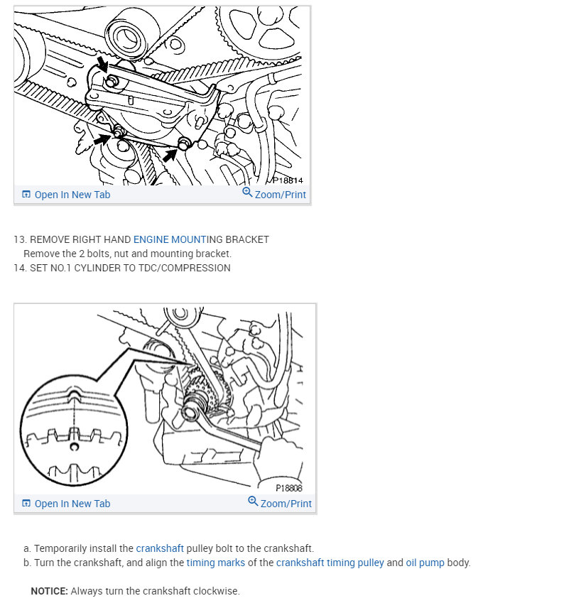

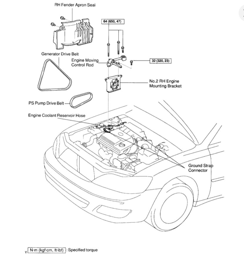

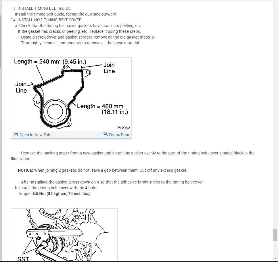

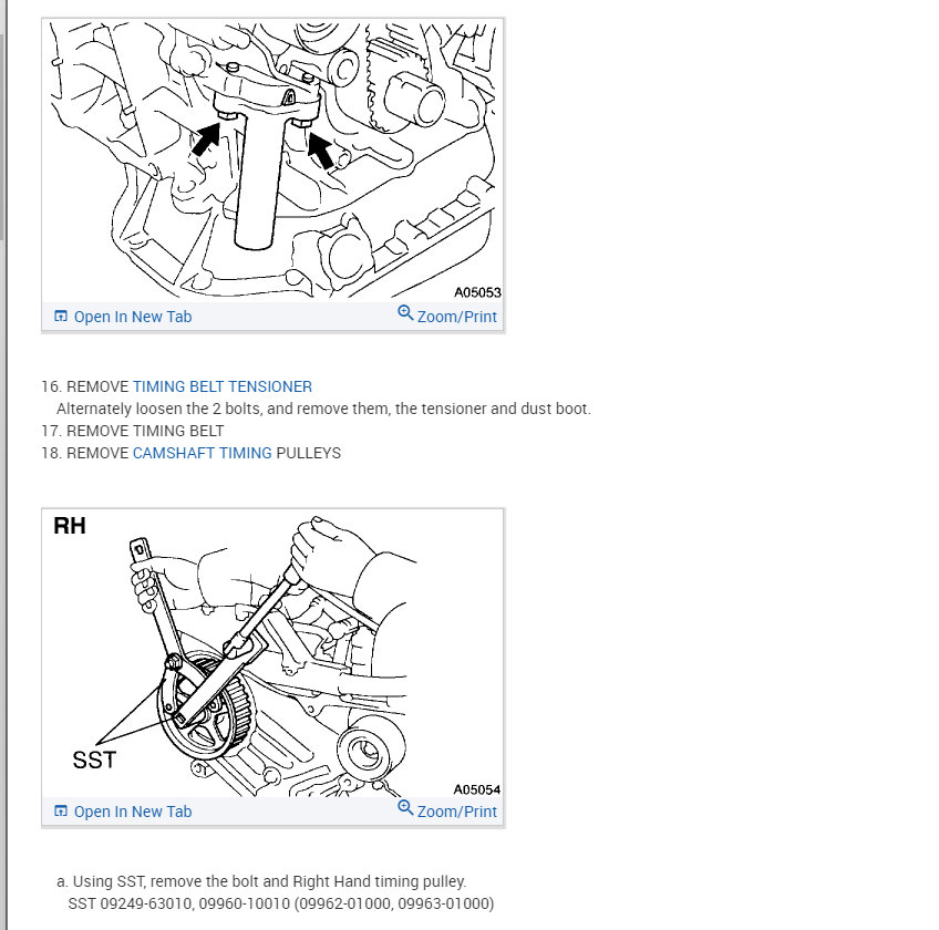

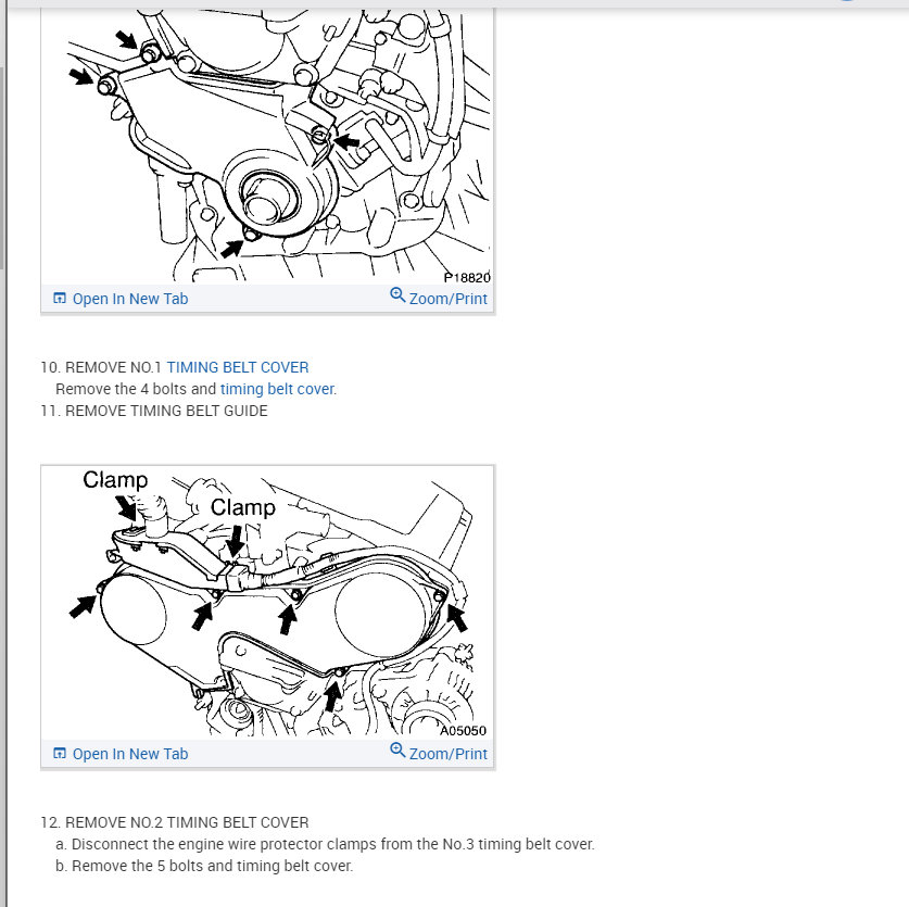

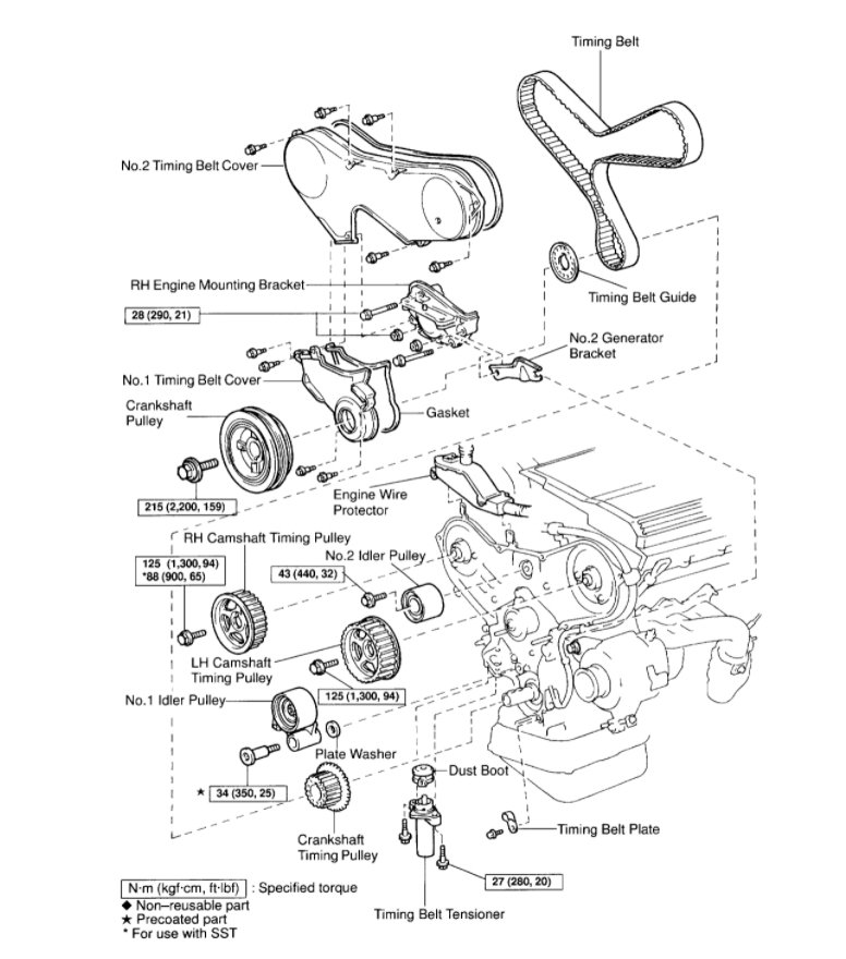

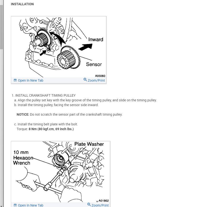

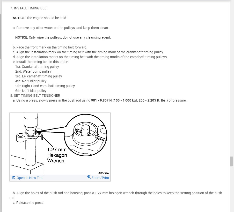

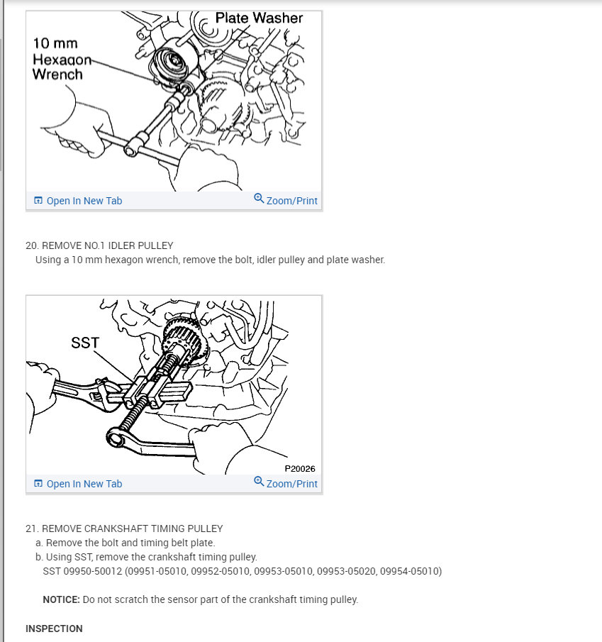

I am attaching the info below on how to change the timing belt. If it were me and you have not changed the belt, then it is past due, and I would suggest doing this and setting the timing correctly.
Please run through this and let us know what you find. Thanks
