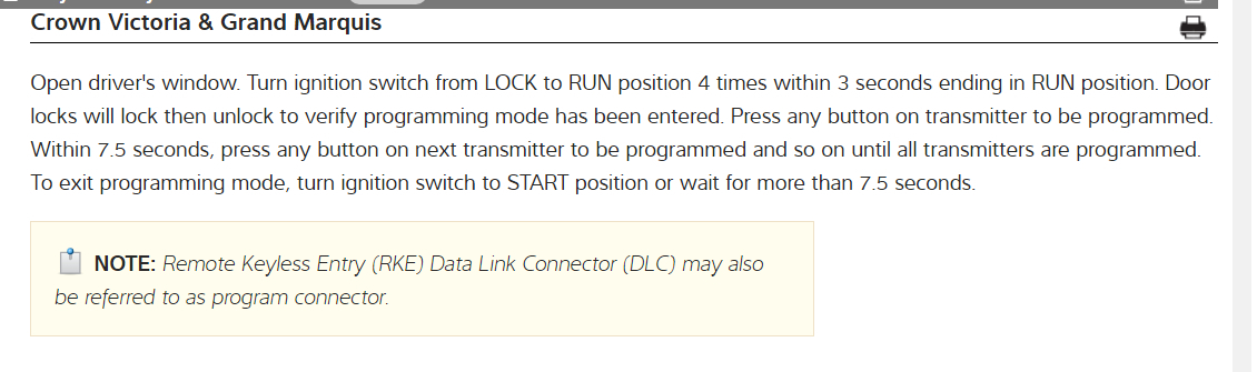

2000 MERCURY MARQUIS
50,000 MILES
WHITEDOG57

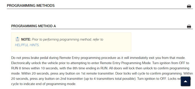

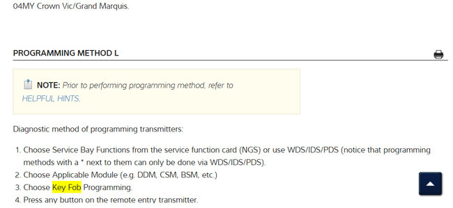

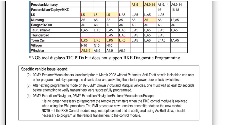

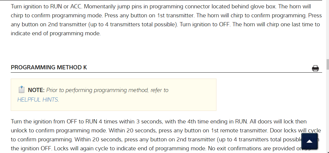

I tried to program new remotes.
Insert key from on position to right before start 4 times.
Locks should cycle, up=down,
Locks don't cycle.
After each program, remove key repeat above steps again.
Locks purchased on Amazon,
KeylessOption Keyless Remote Car Key Fob Replacement for CWTWB1U343, CWTWB1U313, LHJ002 (Pack of 2)
I also have a BlueDriver LSB2 Bluetooth Pro OBDII Scan Tool for iPhone and Android. If this c
An provide any helpful information.
Please help.

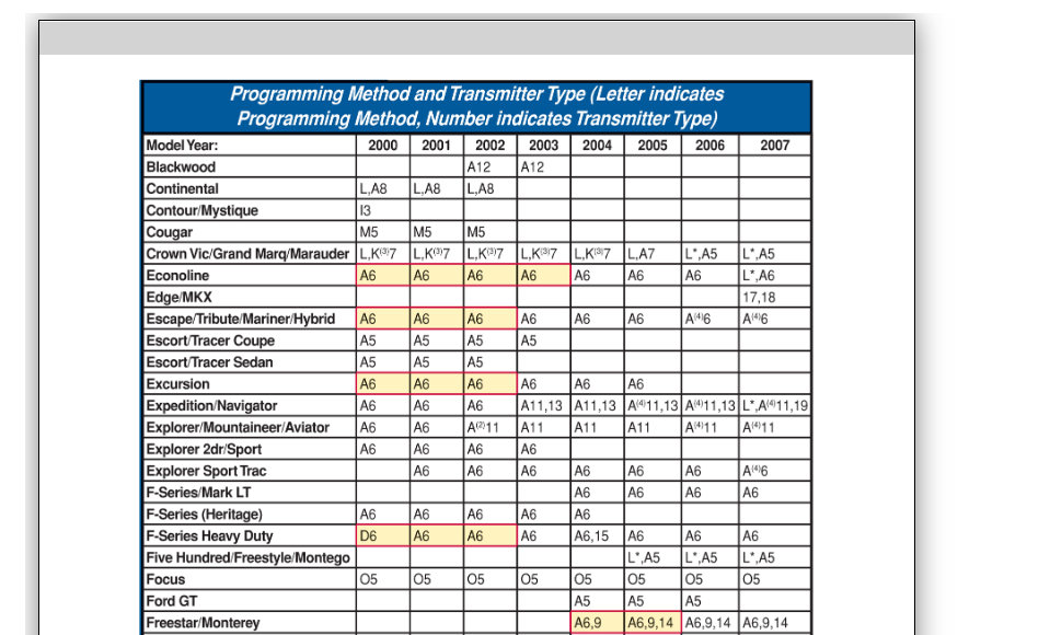

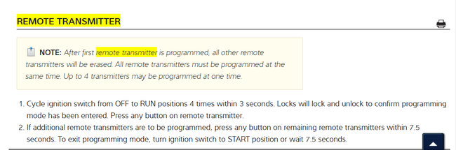

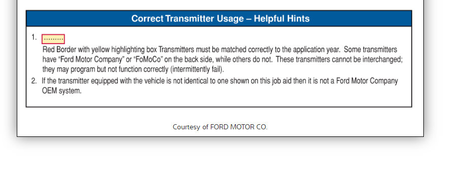

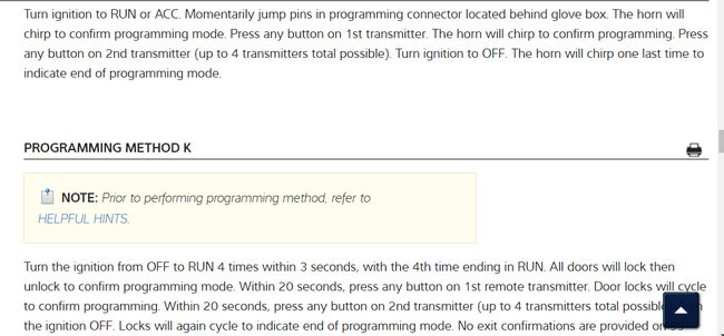

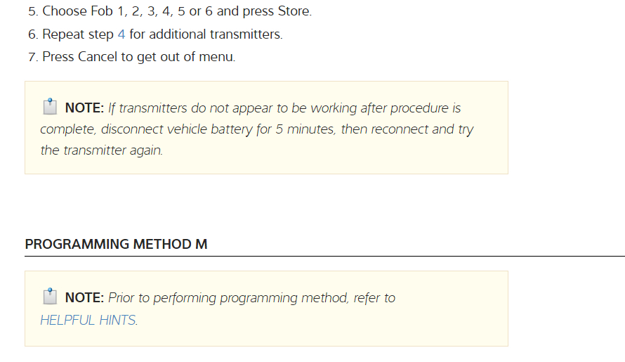

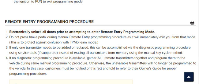

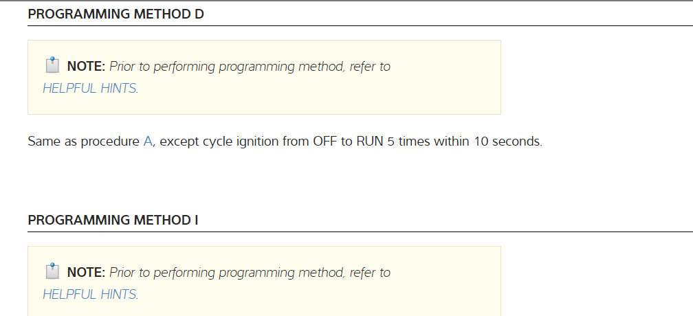

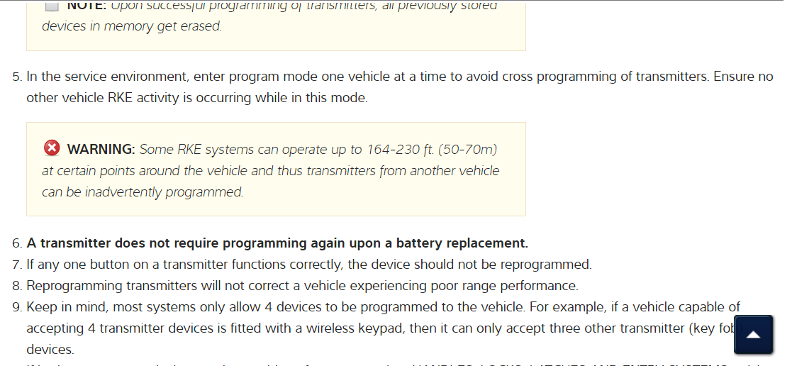

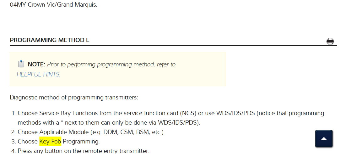

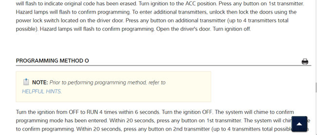

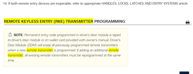

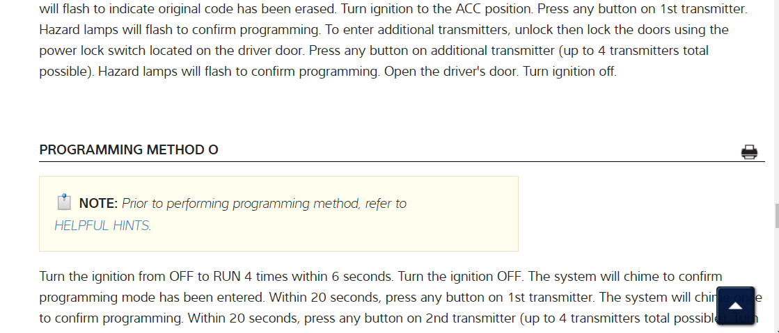

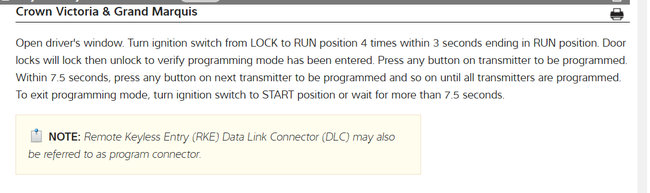

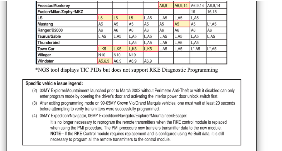

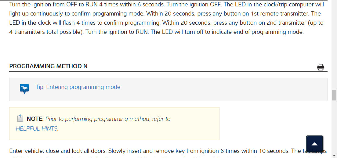

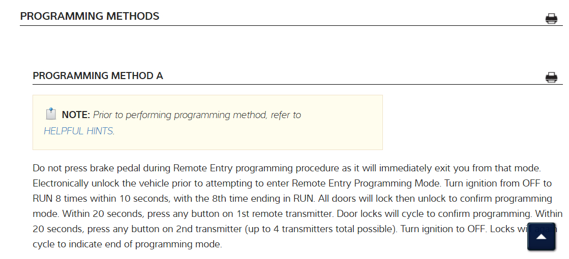

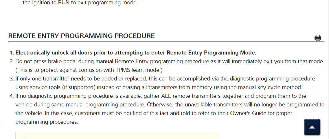

It probably isn't working because there are eight different programming methods for Ford vehicles. In the diagrams down below I have included all of the programming methods for Ford, Lincoln, and Mercury vehicles. Please go through the factory guide and get back to us with how everything turns out.
Thanks,
Alex
