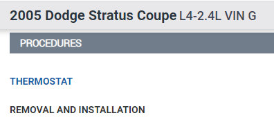

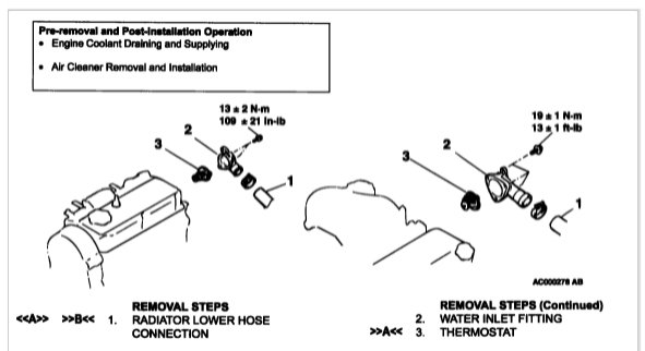

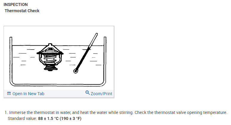

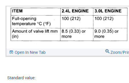

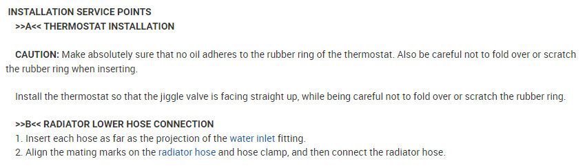

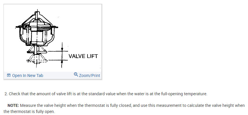

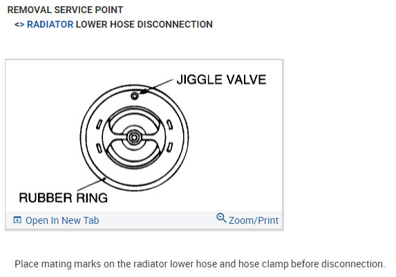

If you think there is no coolant flow back into the radiator then I suspect you might have an issue with the thermostat being stuck closed and not allowing coolant to flow. Here is a tutorial showing how to remove and replace a thermostat:
I've attached picture steps below on how to remove and replace the thermostat on your car. Hope this helps and thanks for using 2CarPros.

Thermostat has been tested and replaced even though the old one works. This has been done twice. There's no circulation period at this point. Thus, the question is as to replacing the water pump, or not. If it's not circulating through the system at all, that is the water pump, am I correct in thinking this?

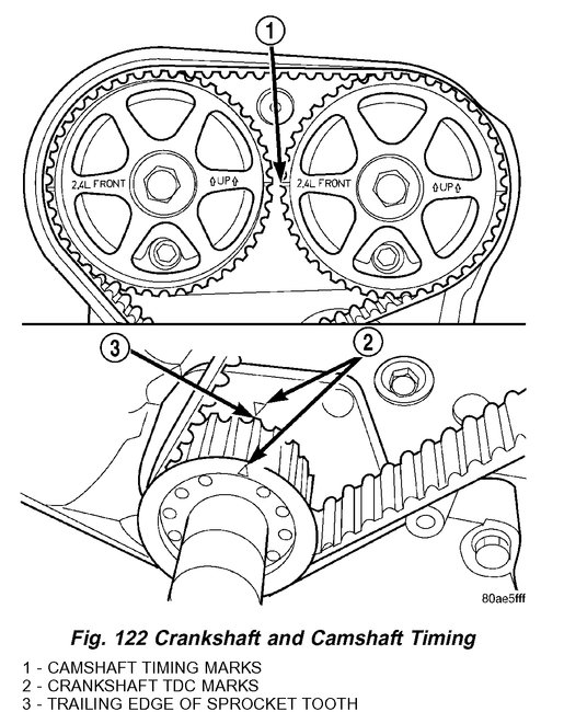

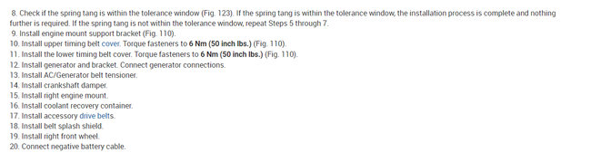

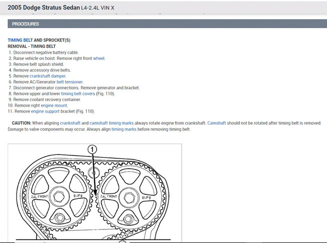

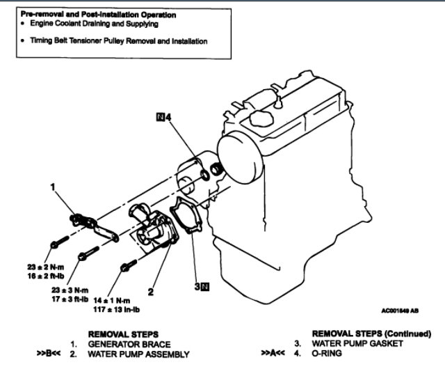

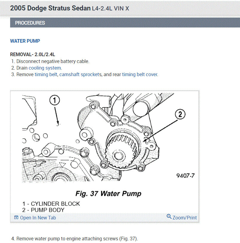

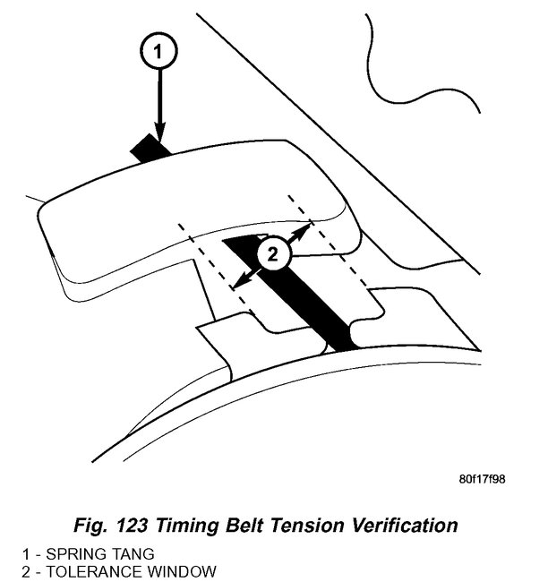

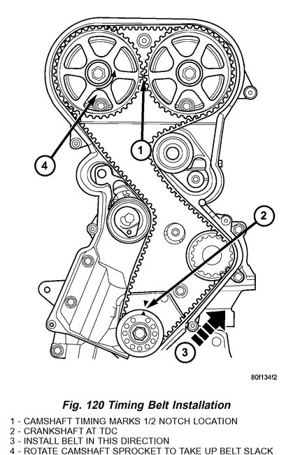

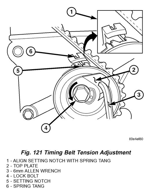

I noticed it has been a couple of days since you were contacted. Has any progress been made? Also, are you certain there isn't a blockage in the radiator or engine block? Also, a bad water pump will oftentimes make noise. Are there any audible sounds you notice?

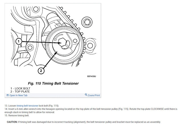

I'm asking all these questions because replacing the pump requires the removal of the timing belt, so we need to be sure. And yes, the pump may simply be bad.

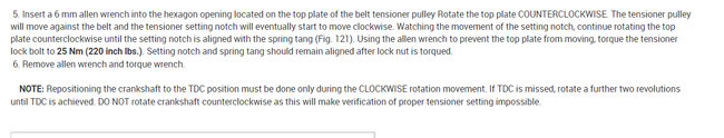

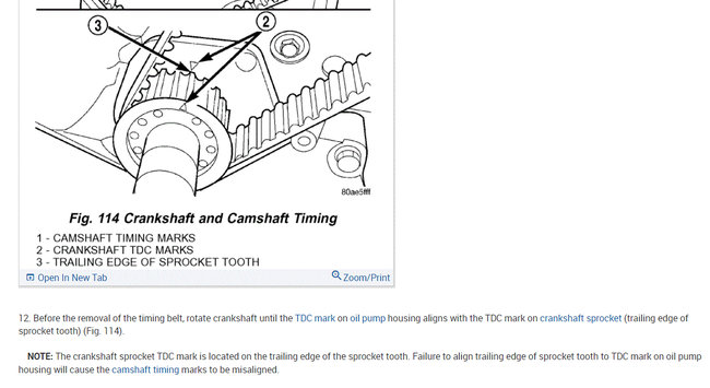

I attached the directions below for replacing the pump. Note the first section is simply the pump replacement. The remaining directions are related to the removal and replacement of the timing belt. This would be a good time to replace the belt if you want.

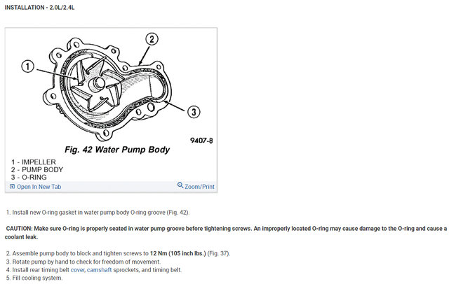

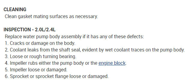

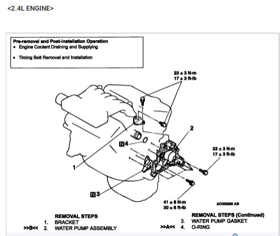

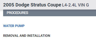

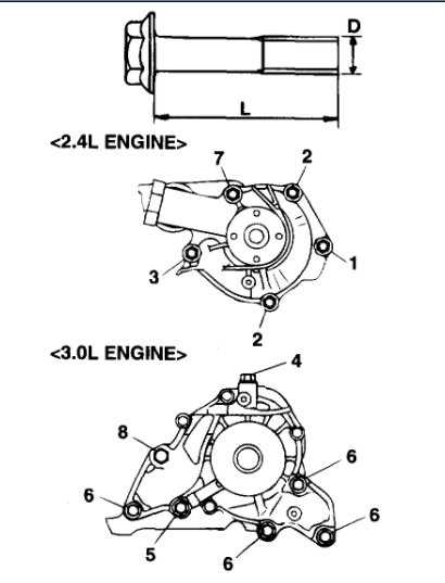

Yes, it's possible you may have a weak or failed water pump not generating coolant to flow through the cooling system. Here is a tutorial showing how to replace a water pump:
https://www.2carpros.com/articles/water-pump-replacement
I've attached picture steps below on how to remove and replace the water pump on your Dodge Stratus. Let us know if you have any further questions on this issue. Hope this helps and thanks again for using 2CarPros.
