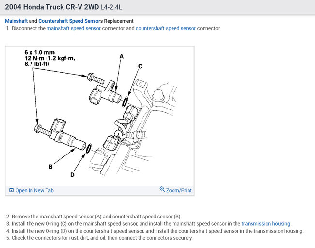

Problems with transmission not shifting when driving faster than twenty five MPH?
2004 HONDA CRV
236,000 MILES • 2.4L • 4 CYL • 2WD • AUTOMATIC
AJH53
A few weeks ago, while driving on the highway after getting out of heavy traffic, the car stopped shifting from 2nd to 3rd and the whole car would shake as the engine revved. I drove it around my neighborhood, and it shifts through the gears perfectly fine at low RPMs, but once I try to go above around 25 MPH it won't shift, and the whole car shakes. I tried doing a transmission fluid change, but it still does the same thing. Please help, I'm not sure what it could be.

It sounds like the countershaft revolution sensor needs to be replaced, but to be sure let's run the codes to see what comes up.
here is a guide to help:
This guide may help as well:
Here is how to change the revolution sensor out in case you need it. Check out the images (below). Please let us know what happens.
