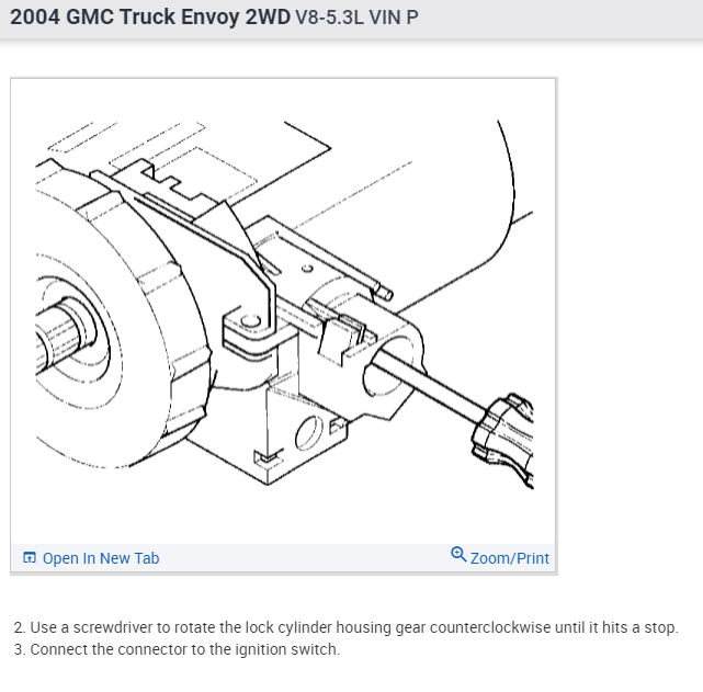

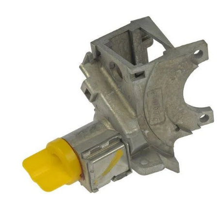

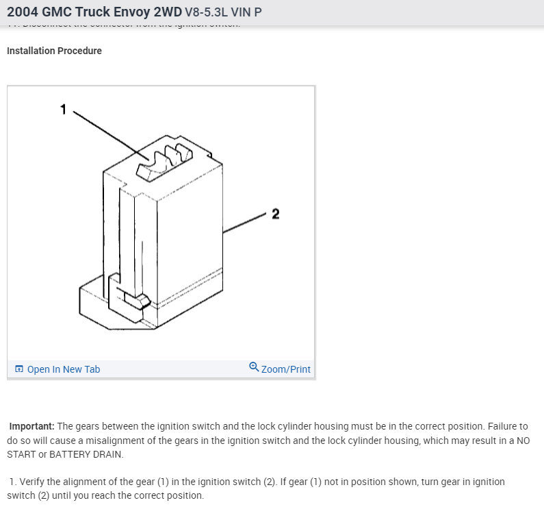

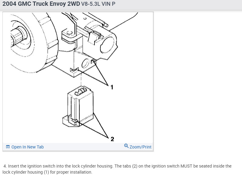

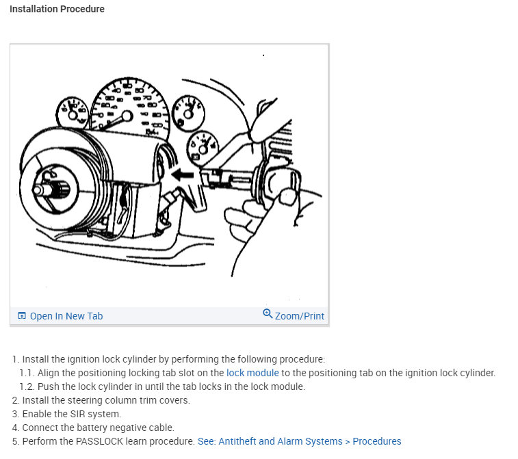

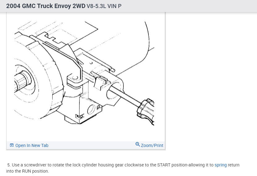

I lost my keys to my vehicle. I bought a new ignition cylinder; I need a diagram of the ignition housing. Someone tore it apart and they must of took the housing apart because when I insert the new cylinder it's like there's gears missing on the inside that connect it to the ignition switch because it just moved freely. I found a sleeve thing that the cylinder fits into laying on the floor. It looks like that's what he needs to make it work but I don't know how to take the ignition housing apart to put the part back in.

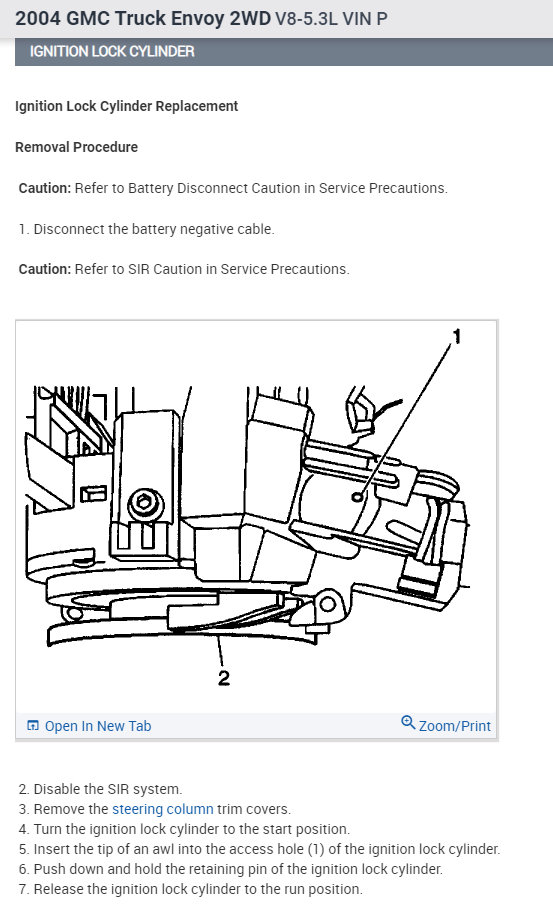

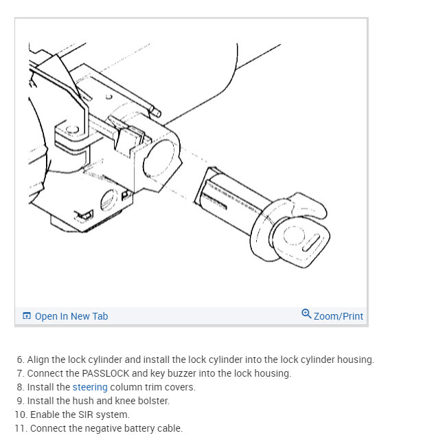

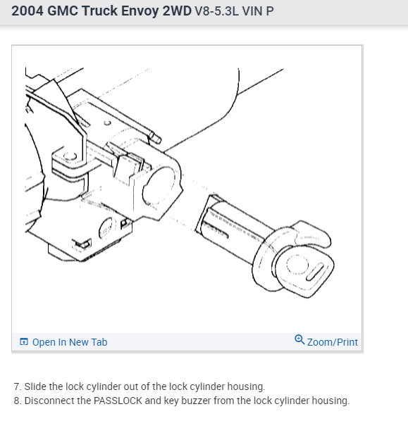

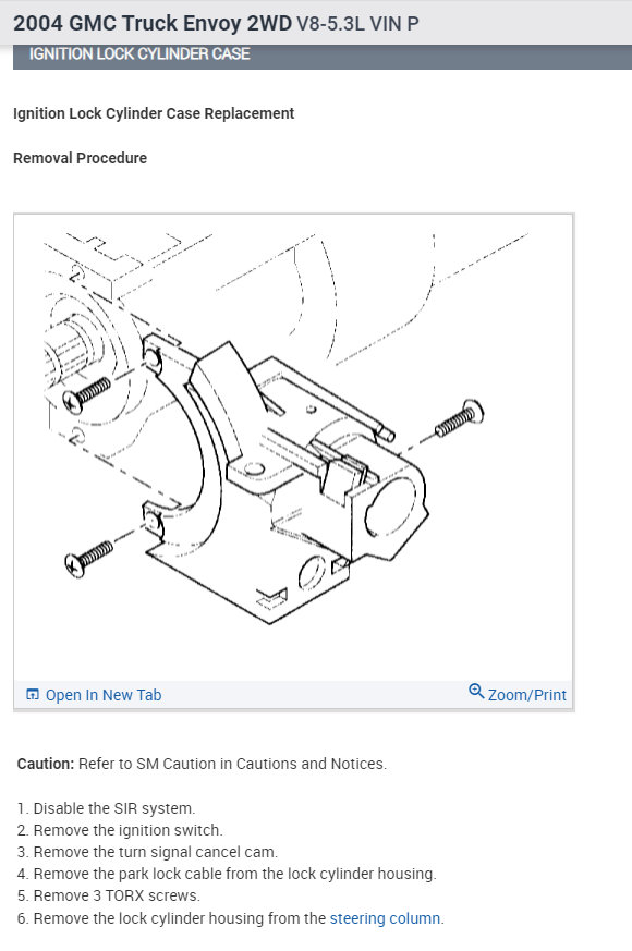

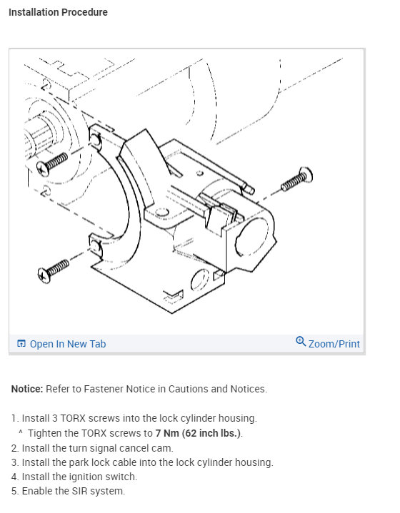

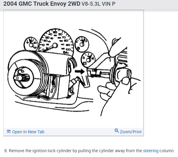

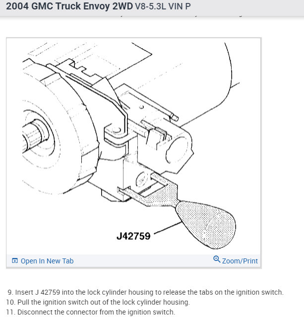

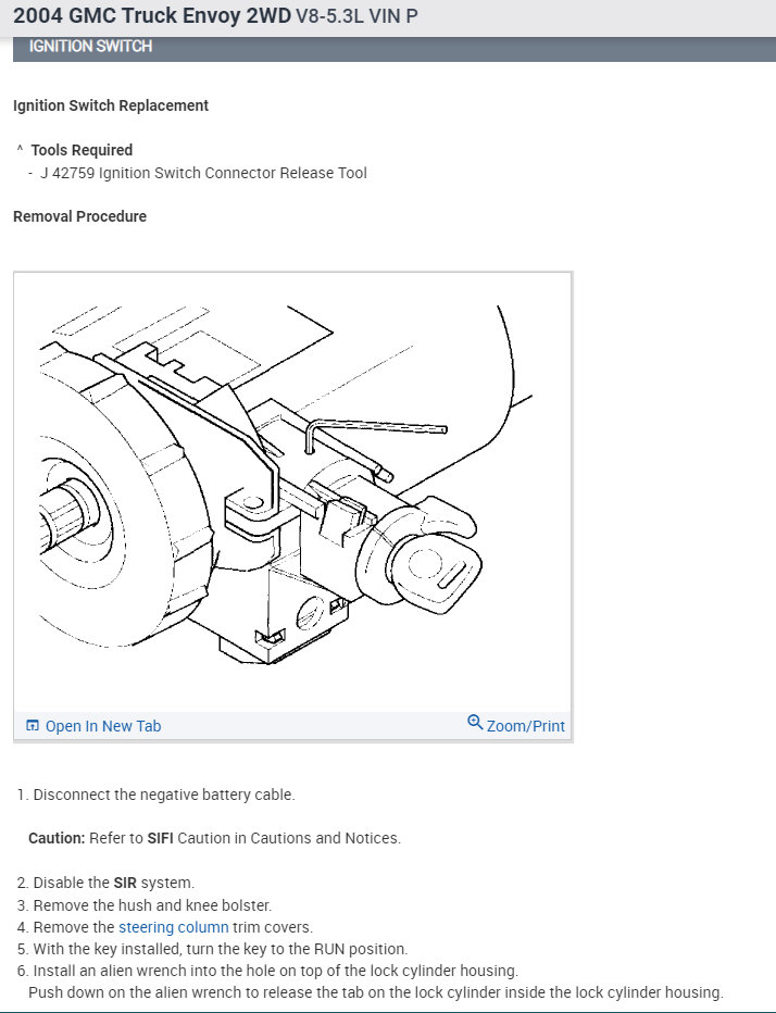

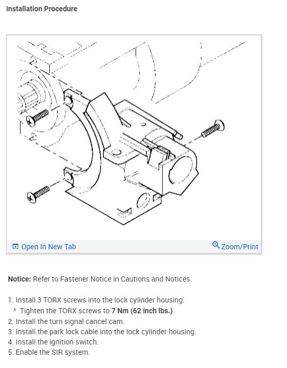

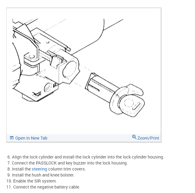

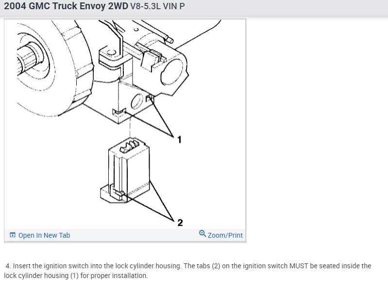

The lock cylinder does go into a housing that attaches to the column.
I have attached the ignition lock cylinder, lock cylinder housing and the switch diagrams and replacement procedures below.

What size are the torque screws on 2004 ignition cylinder housing?
Feb 16, 2024 at 3:42 AM
  • 55,399 POSTS
I believe they are TX25.
