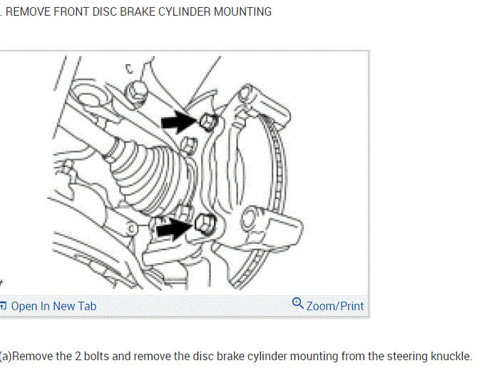

The other week, after noticing a high squeal from the front of my car, I mentioned to my mechanic that the brakes needed to be changed. I purchase a set of the Duralast Gold rotors, and swap out my brake pads. I do not know what to do can you help?

Replacing front brake pads really isn't too hard. When you do it, make sure to get lifetime pads so you never have to pay for them again.
You can expect front pads to last approximately 25,000 miles. However, that can change based on driving habits and terrain.
To get you started, here is a video that shows how it is done
https://youtu.be/VtqeB0qgrTs

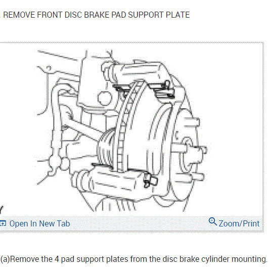

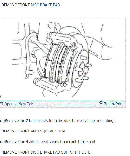

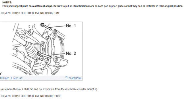

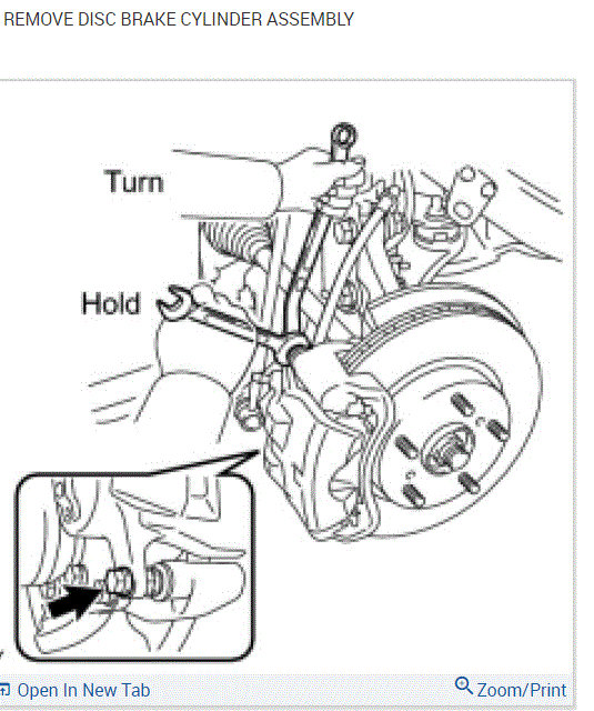

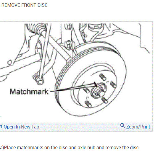

If you look at the attachments, they include the directions and pictures specific to your vehicle for replacement. Use these directions for the procedure.
