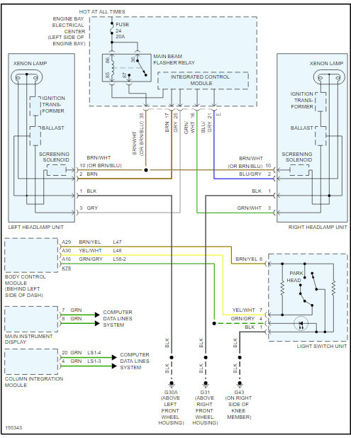

I recently bought a low mileage (93,000 miles) car listed above for my son.
It had the left and right low beam failure on the SID (is why we got it for a good price) After doing some research, I went ahead and replaced both bulbs and when that didn't work, both ballasts.
Unfortunately, we still have the L/R low beam failure notification.
The odd thing is that when the key in start/run position, but not actually starting the car, the HID headlights work perfectly.
As soon as I start the car and it's running, the driver's side low beam flickers and the passenger side doesn't work or flickers when it does come on.
Any help with this would be greatly appreciated.
Thanks,
Billy

Hello, I'm Danny.

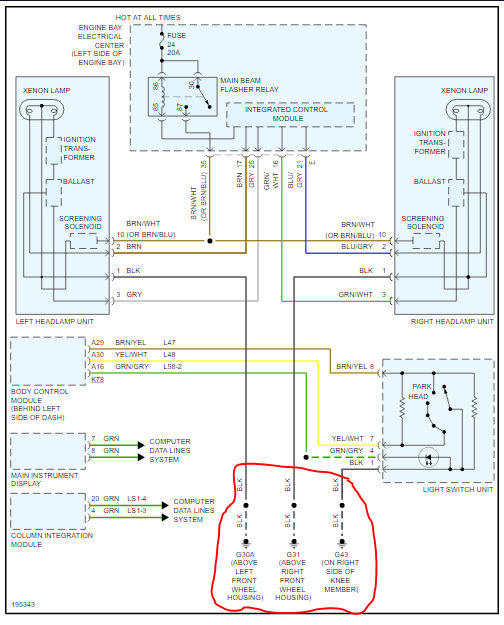

It sounds like you may be having a problem with a headlight ground.. Here is a tutorial for you to view about checking wiring:
You might want to check the ground connection for looseness/melted/frayed/corroded connection. I've attached a picture below of your vehicles wiring diagram with headlight grounds circled in red.Hope this helps and thanks for using 2CarPros.
Danny-

Sorry about the delay, we've been working 12 hour shifts and haven't had the energy to check the car out until today.
Thanks for the diagram, it helped a lot.
I checked and cleaned all grounds. I took the headlight assemblies out and used an electronics cleaner on each connector and used dielectric grease before reconnecting everything.
There are no corroded, burnt or frayed wires.
After this, I took the battery holder out and checked the two ends for the negative terminal. They looked fine, but I went ahead and loosened and cleaned them. So, in all, every ground connection has been taken off and cleaned, the headlights (Sylvania) have been replaced and so have the ballasts.

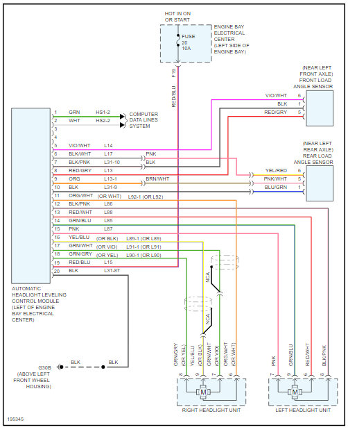

I forgot to mention that the SID also lists the headlight leveler failure notification. I disconnected that to see if it would have any affect; nothing was noted.
I checked the battery with a multi-meter to ensure it was charging and holding voltage fine. With the car running, the voltage goes up as it should, so the alternator seems to be doing it's job.

I've attached the headlight diagram again but I've also added another for the headlight leveling circuit.Having the DRL's disconnected might have caused the problem as well.Hope this helps and thanks again for using 2CarPros.
