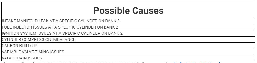

The first thing I noticed is that all misfires are on the same side of the engine. As far as the codes are concerned, the P0420 indicates an issue with the catalytic converter. The P0456 is a small evap leak. The P219B is one of interest. That indicates there is an imbalance in the air/fuel ratio on bank two, which is the side of the engine that has all the misfires (P0302, P0304, and P0306).
The imbalance can be caused by several things. For example, an exhaust leak on bank 2, a faulty fuel injector or injectors, an intake vacuum leak on one or more of the identified cylinders, engine compression, and the list goes on. See pic 1 below for a full list.
When the engine is running, have you ever noticed a slight exhaust or ticking from under the hood? Also, are you comfortable performing tests at home if I provide the directions?
See pic below.
