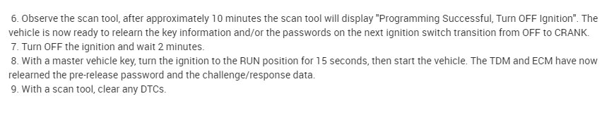

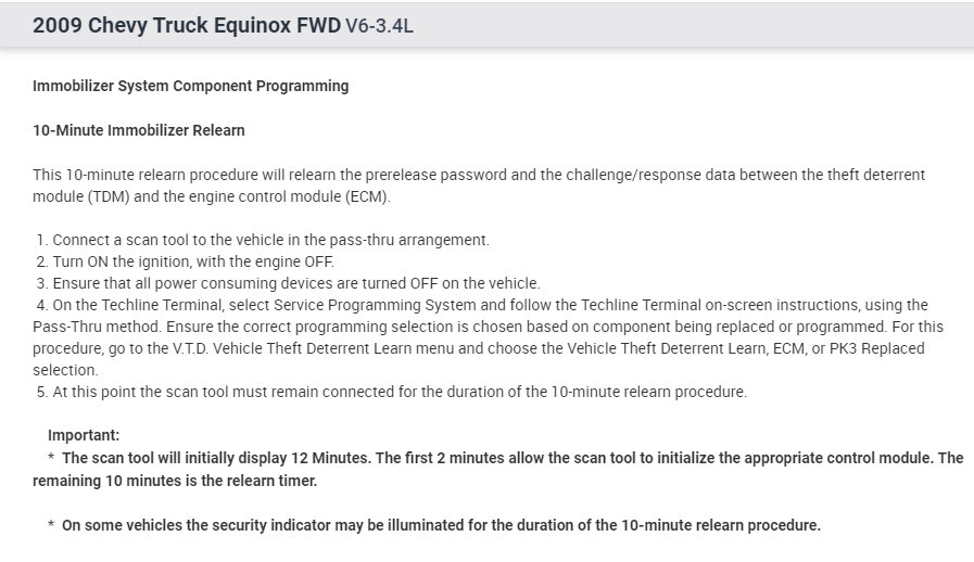

It's odd the light isn't turning on. However, it need to be programmed to your vehicle. To program it, you will need a scan tool that has the ability to communicate with the PCM.
If you look below, I attached the directions. (note, you didn't list the engine size, so I went with the 3.4). Both engine options should be the same.
Take a look at the directions below and let me know if that is what you have already tried.
