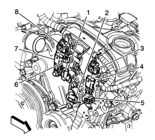

Hi, i have these codes in my car:
P2094 B Camshaft Position Actuator Control Circuit Low Bank 2
P0442 Evaporative Emission System Leak Detected (Small Leak)
Could you tell me the name of the parts and the location?
The last time you helped me out with a sensor to the find the location and i did it exactly like you said.
Thank you
Mar 2, 2021 at 7:42 PM
  • 110,194 POSTS
The P2094 is for a bank 2 exhaust cam sensor. If you look at pic 1 below, it shows the location.

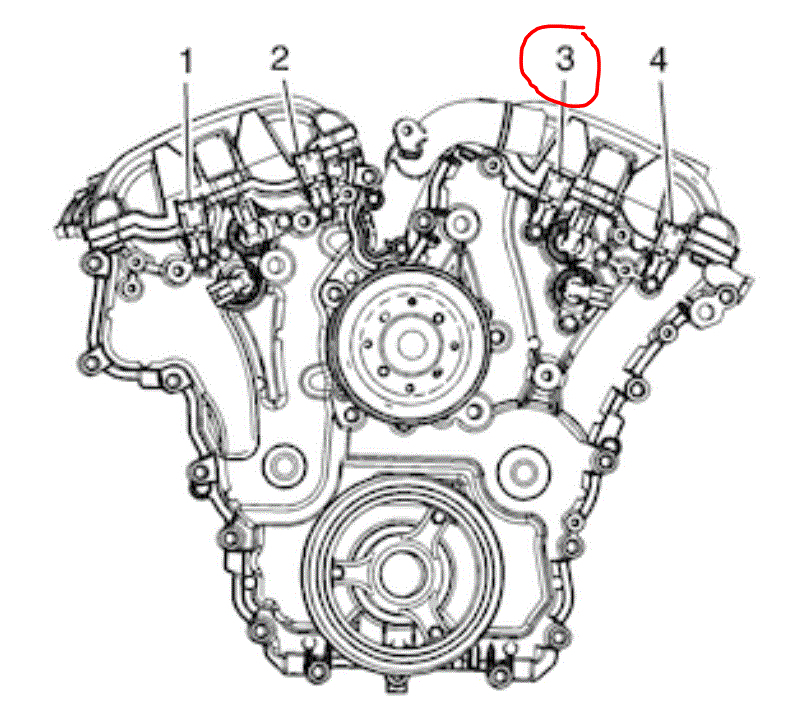

Here are the directions specific to your vehicle for replacement. The remaining pics correlate with the directions.
___________________________________________
2015 Chevy Truck Traverse FWD V6-3.6L
Camshaft position sensor replacement bank 2 (left side) exhaust
Removal Procedure
Remove the engine mount strut bracket. Refer to engine mount strut bracket replacement.
pic 2
Disconnect the engine wiring harness electrical connector (3) from the bank 2 exhaust camshaft position sensor (4).
Remove the CMP sensor bolt and sensor (4)

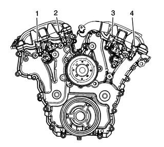

pic 3

The P0442 indicates there is a small leak in the evaporative emissions system (EVAP). When they are small, what I recommend is to have the system smoke tested. A machine will pump smoke into the system at a very low pressure and the smoke will come out where the leak is located.
I recommend this because a small leak can be very difficult to locate.
