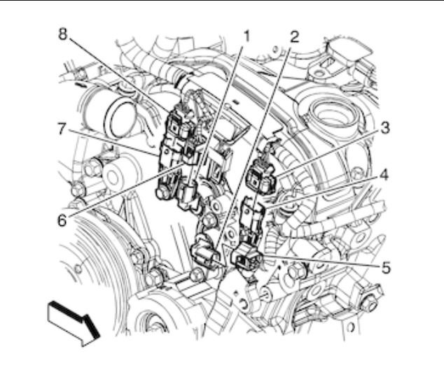

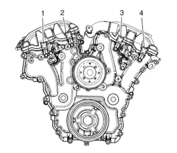

Camshaft position bank 2 location. picture i saw different diagrams and i'm confused. now i'm not sure the location. Please help!

There are 4 cam sensors. On bank 2 there is an intake and exhaust sensor.

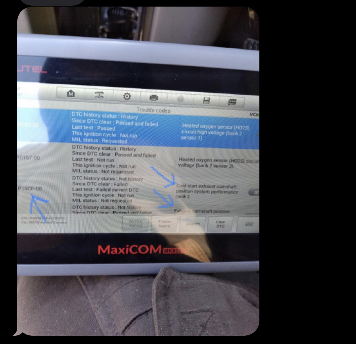

Can you tell me the code that you have?

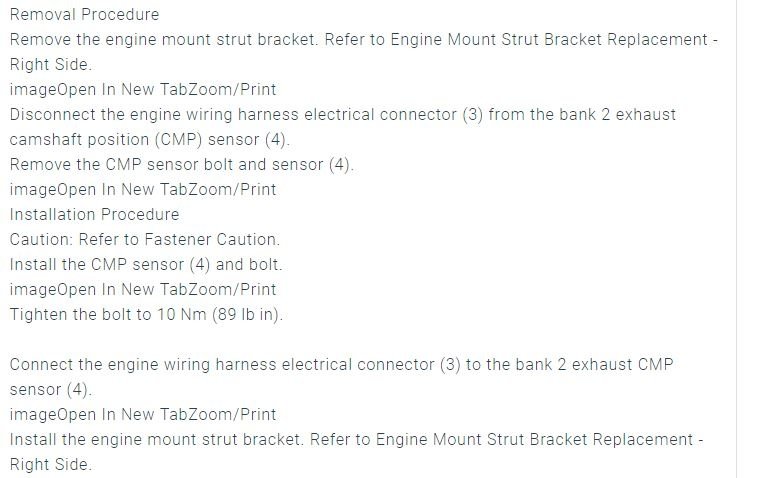

I attached the procedure for replacing it for you below.
https://www.2carpros.com/articles/camshaft-angle-sensor-replacement

This is the code: P05CF-00 exhaust. Bank 2

It is number 4 in the picture.
