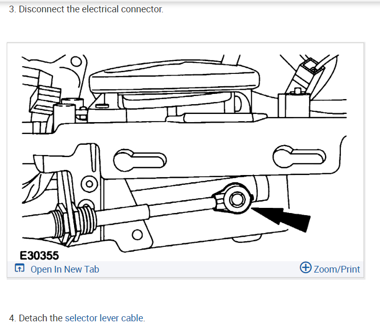

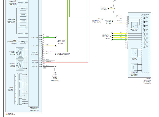

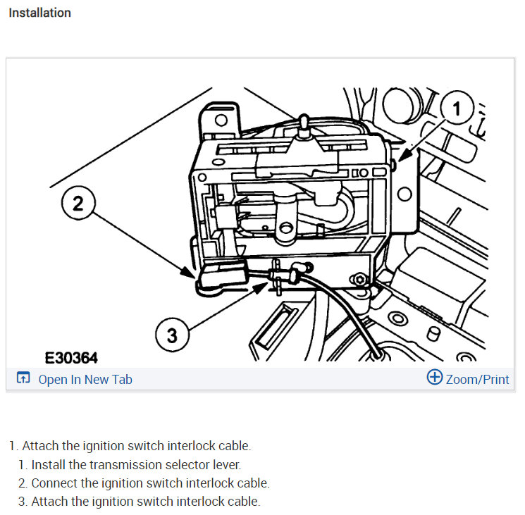

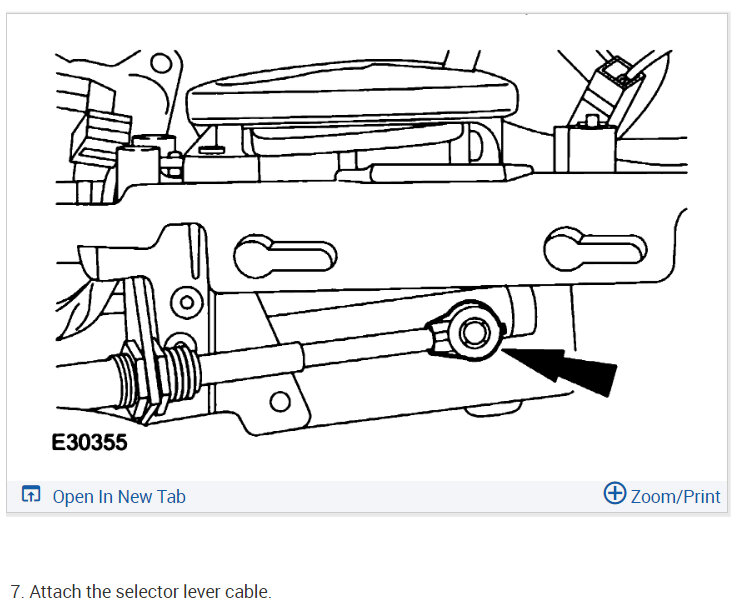

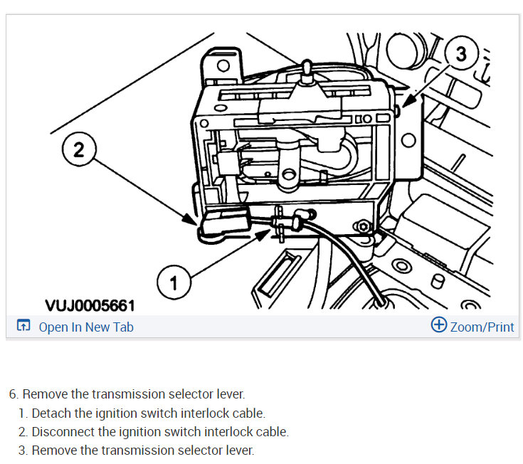

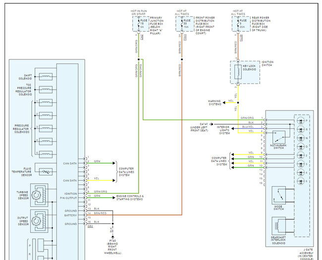

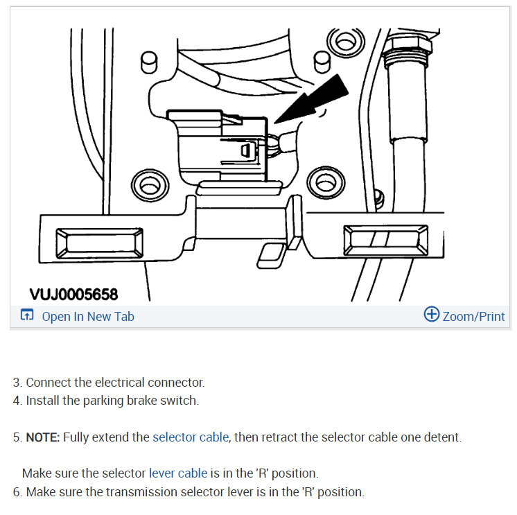

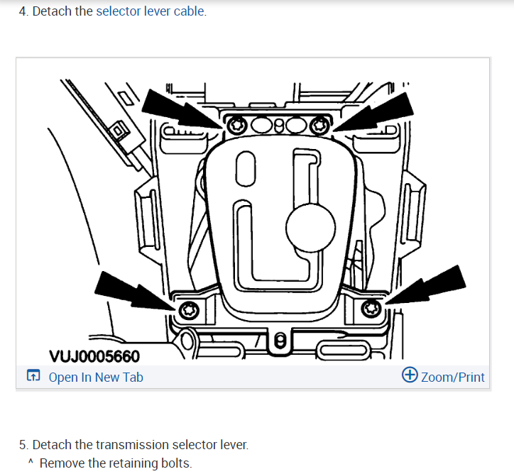

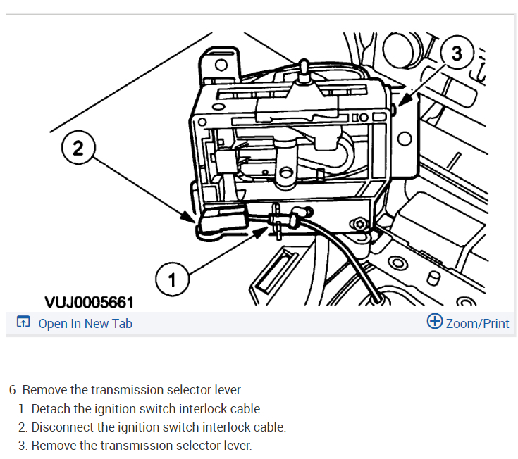

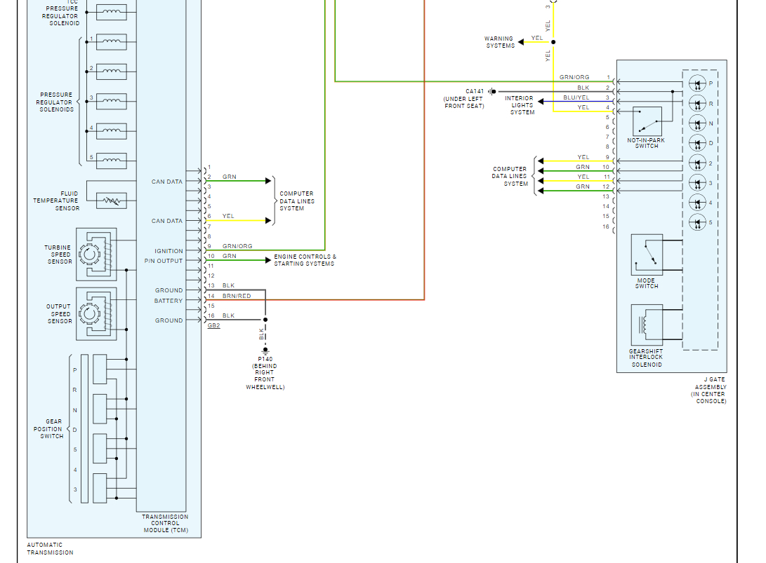

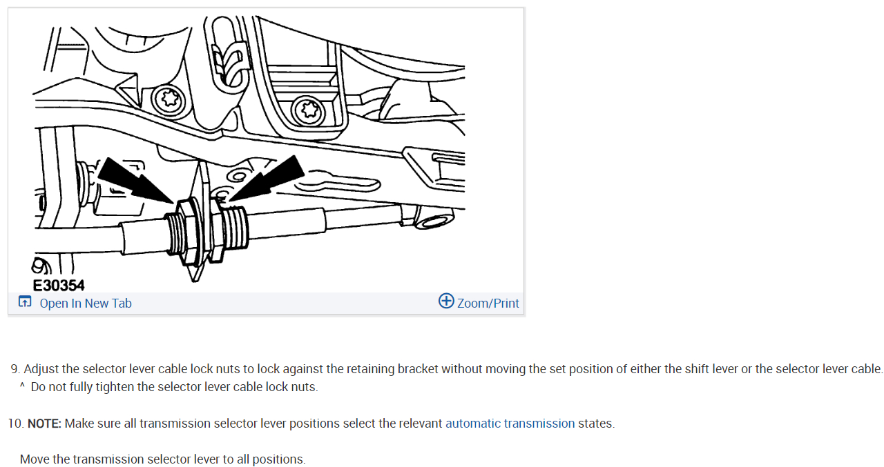

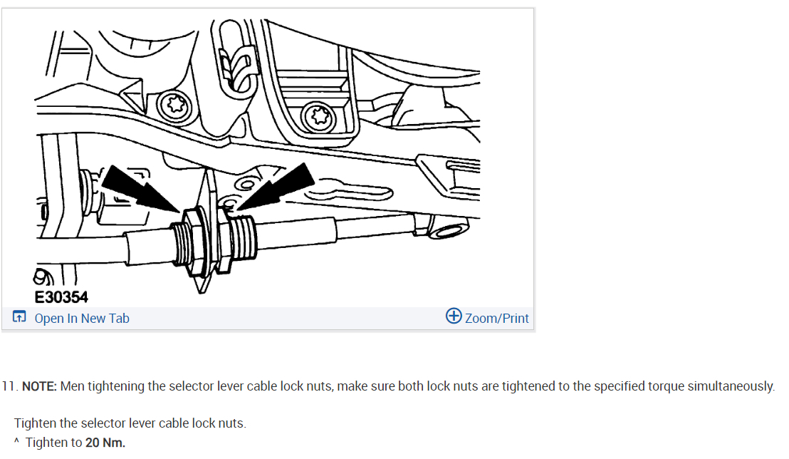

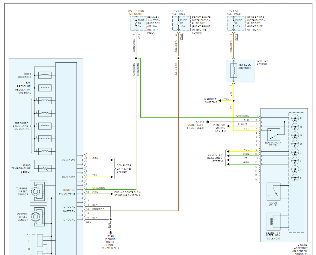

It sounds like the mode switch inside the shifter has gone bad, but we should run the codes to see if any are stored.

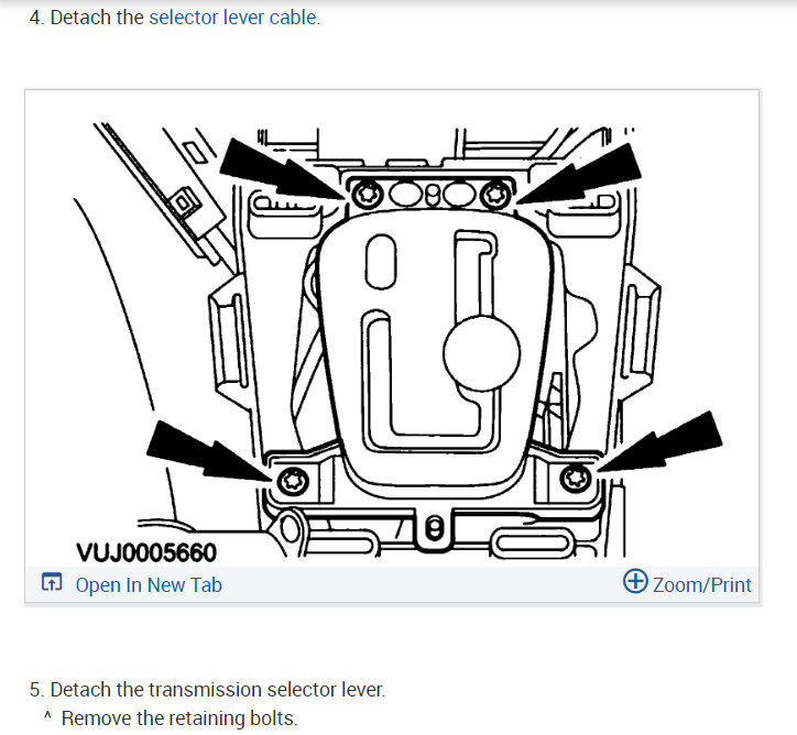

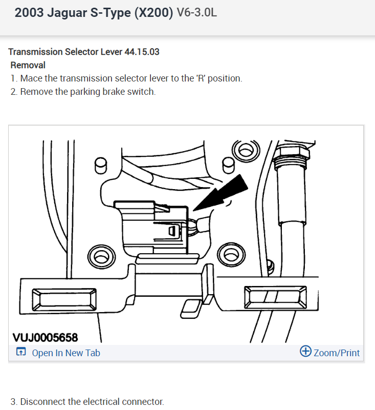

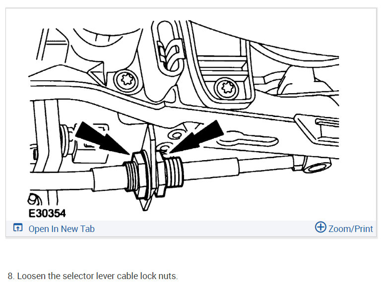

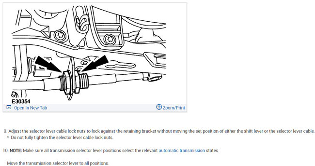

This guide can help:
Here are the transmission wiring diagrams so you can see how the system works, and I have included how to change or test the mode switch. Check out the images (below). Please upload pictures or videos in your response to any problems so we can see what to help you with.
