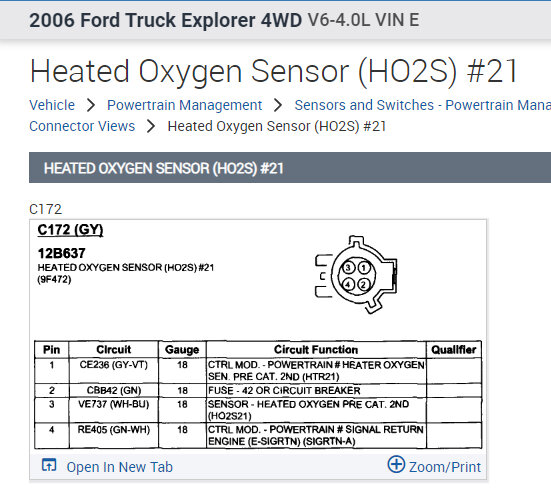

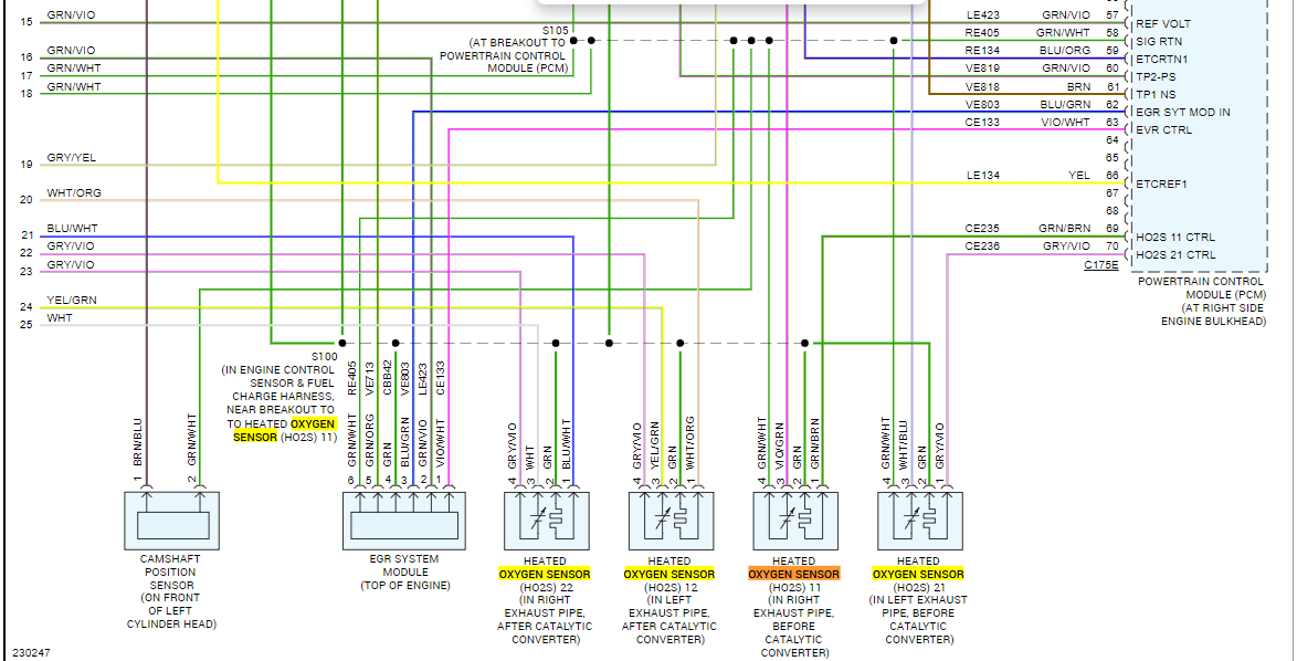

problem with the oxygen probes cable completely stripped at the connectors of the connector?
2006 FORD EXPLORER
103,458 MILES • 4.0L • V6 • 4WD • AUTOMATIC
FONTAINE
I need the engine wiring diagram for the Eddie Bauer 2006 model SUV listed above. I need to check the wiring. Is it the same wiring as the XLT?
Dec 27, 2023 at 10:43 AM
  • 110,244 POSTS

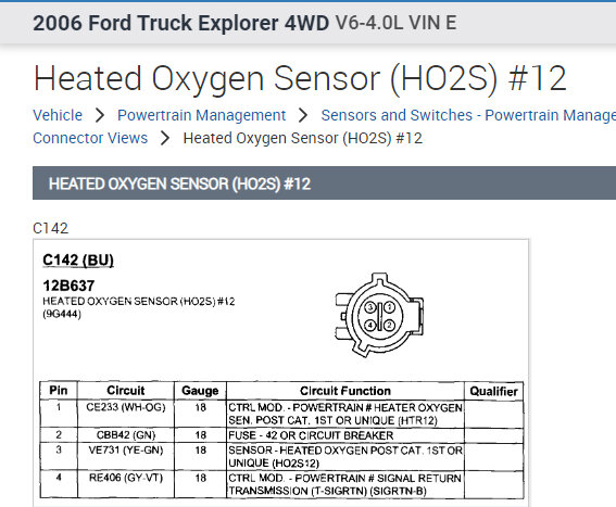

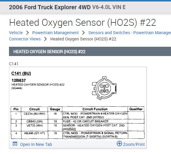

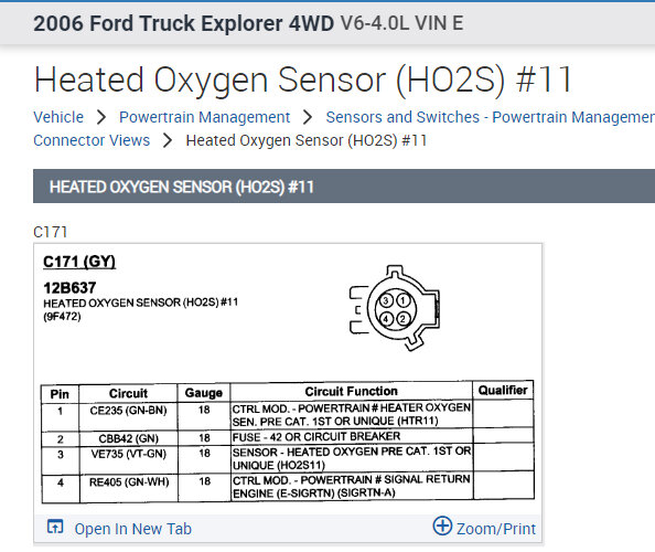

There are four sensors, so I'm not sure which one you are working with. So, if you look at pic 1 below, it shows the sensors in the powertrain control schematic. The remaining pics are a pinout of each sensor.
Note that in the heading of each one, it indicates (HO2S) #11, #12, #21, or #22. The numbers indicate the bank and which sensor. For example, #11 equals bank one sensor one.
Let me know if this helps.
