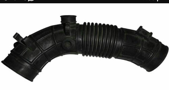

In the hose pipe do we need anything to block the half the amount of air?
If we do not the car does not start.
Please explain to me.

I am talking about the air filter extension hose pipe.
I found a small thing that was placed to allow partial air move out and in.
May 19, 2018 at 2:00 AM
Okay, thanks.
There should be nothing in there to obstruct the flow of air into the engine.
Can you upload a picture for me of what you see?

The engine and things are fine. There was tear in the rubber part of the hose pipe. After replacement I am facing the problem. I am using the LPG and there is no problem in the gasket and filter.
May 19, 2018 at 2:27 AM
SHREYAS
  • 16 POSTS
This is the part which is causing problem I guess.
In between I found that thing.
May 19, 2018 at 2:32 AM

Okay, thanks.
There is a mass air flow sensor on the end of the line. It measures the density of the air entering the system.
disconnect that and see if it starts.

Do you have a scan tool to monitor the system? You need to see the pressure being delivered to the engine from the LPG system. Have you changed the filters for the system?

If you have low pressure to the engine, you will need to lower the amount of air. That is why you need to check the pressure. If you had sufficient pressure, you would not need to bend the hose in half.
You need something to check the pressure. You need a scan tool that can read it. You also need to check the filter for the gas as well.
