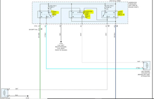

Sometimes the temperature gauge doesn't indicate anything, and the fans are on all the time. Sometimes I suddenly start to work normally. Sometimes are several days that it works normally. I have already changed the temperature sensor twice. Already checked the wiring, it's okay.
Any advice?

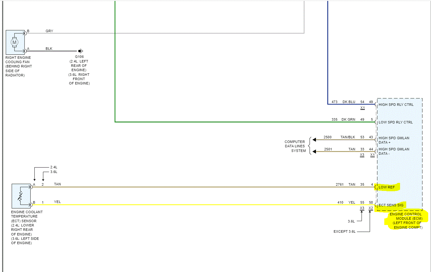

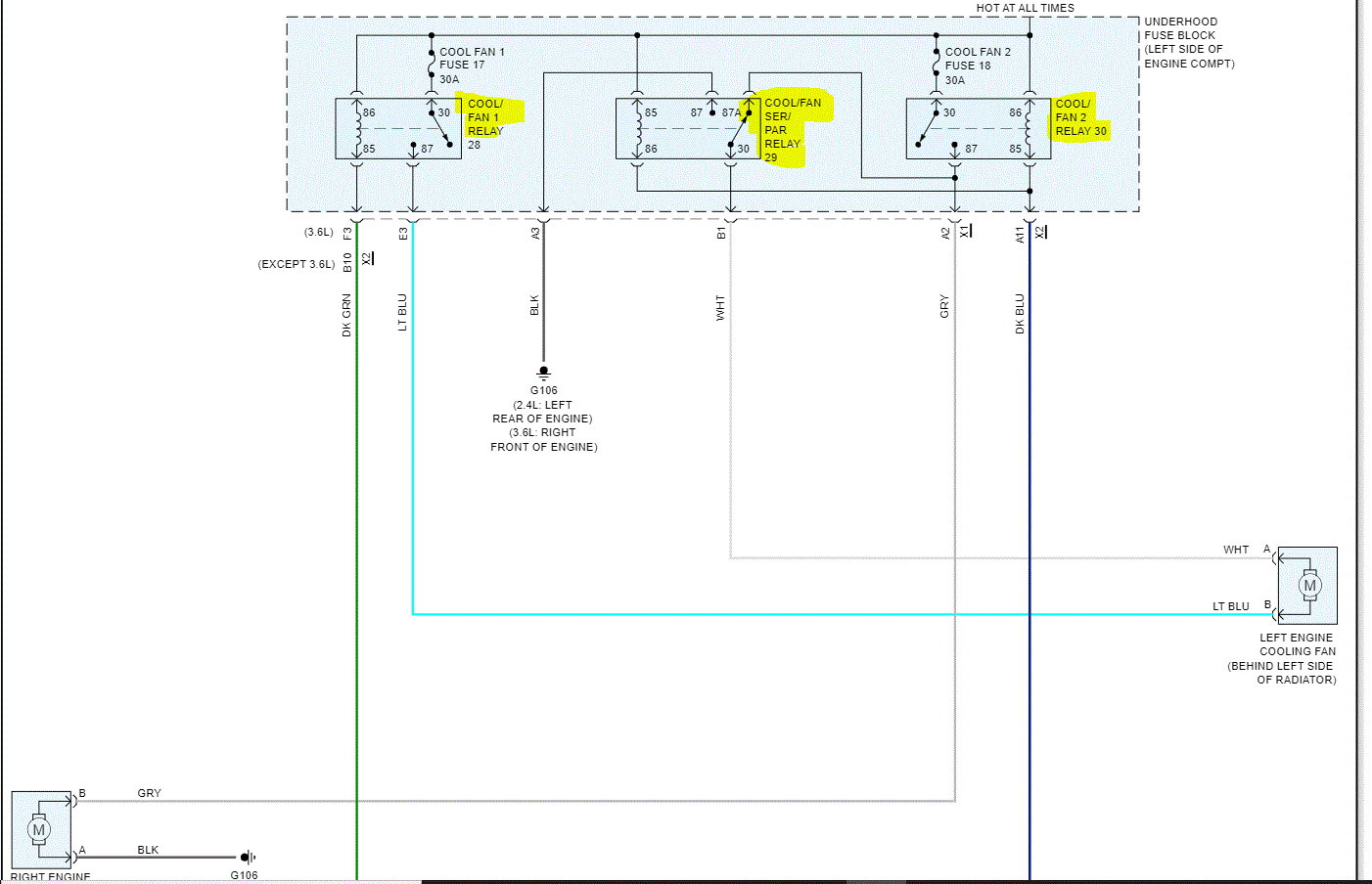

If there are no codes from the can-bus, I would suggest checking for issues within the wiring between the ECT and the BCM, as well as checking relay connections.
I attached a copy of the cooling fan wiring schematic. It included all components related except the gauge itself. Go to the body control module (BCM) and make sure there are no issues with wiring there. Also, confirm there is nothing wrong with the connection such as a loose connector, damaged wiring, and corrosion at the connector.
If that all checks good, confirm the relays in the relay box are tight and not damaged.
Let me know what you find.
See pics below. Note: I had to cut the schematic into two parts to make it readable for you. I did overlap them and highlight areas to check.

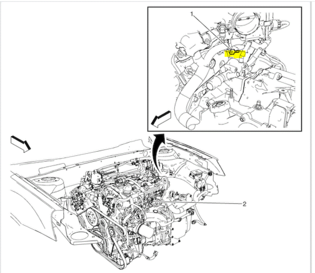

Thanks. New symptoms. Changed water pump and thermostat, temperature gauge seems to work fine. Weekend go visit gf 150 km away.
On one occasion the gauge was going up and down for a while, fast, it looked like a tachometer. At another time, when passing another car, going into overdrive, it went down and up and then normal.
At another time, completely stopped, I felt a pull, the indicator went down to 0 and went back up to normal.

It sounds like you have a faulty signal ground. The PCM signal ground is located on the lower left side of the engine. See pic 1 below.
I need you to locate that ground, inspect it for damage, make sure it is tight, and make sure it is free of corrosion. The wire will be black with a white tracer.
See pic below.
