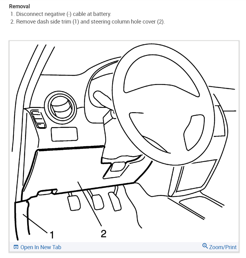

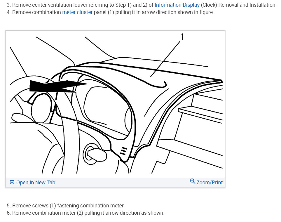

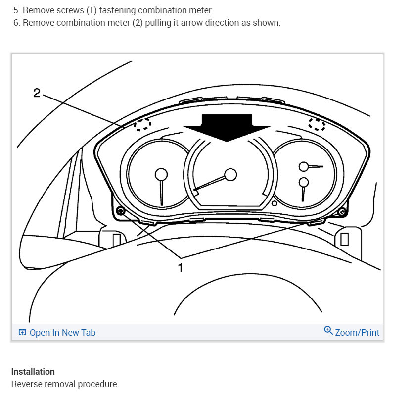

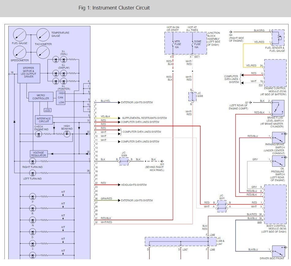

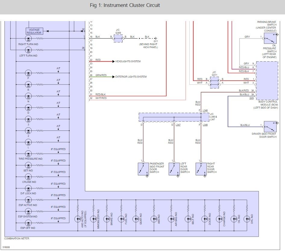

There is not must you can do but have the cluster rebuilt here is a video that show the job being done on a similar car with diagrams below to show you how on your car. Check out the diagrams (Below). Please let us know if you need anything else to get the problem fixed.

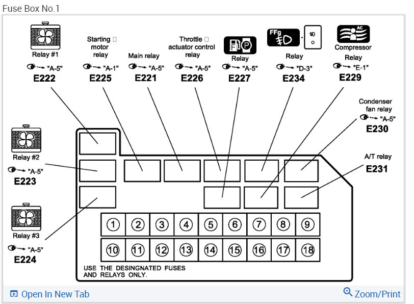

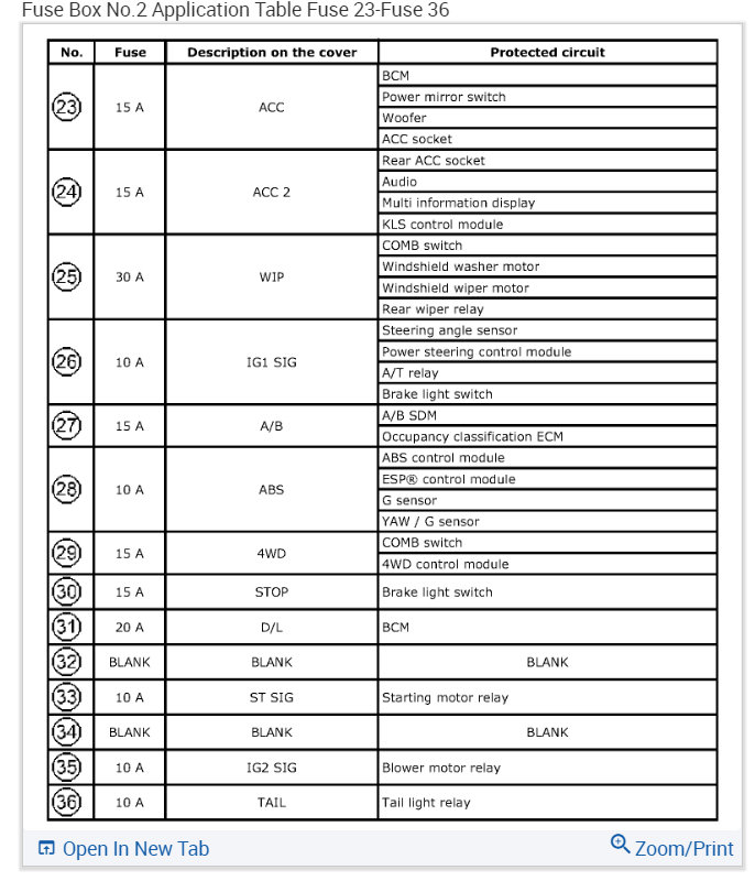

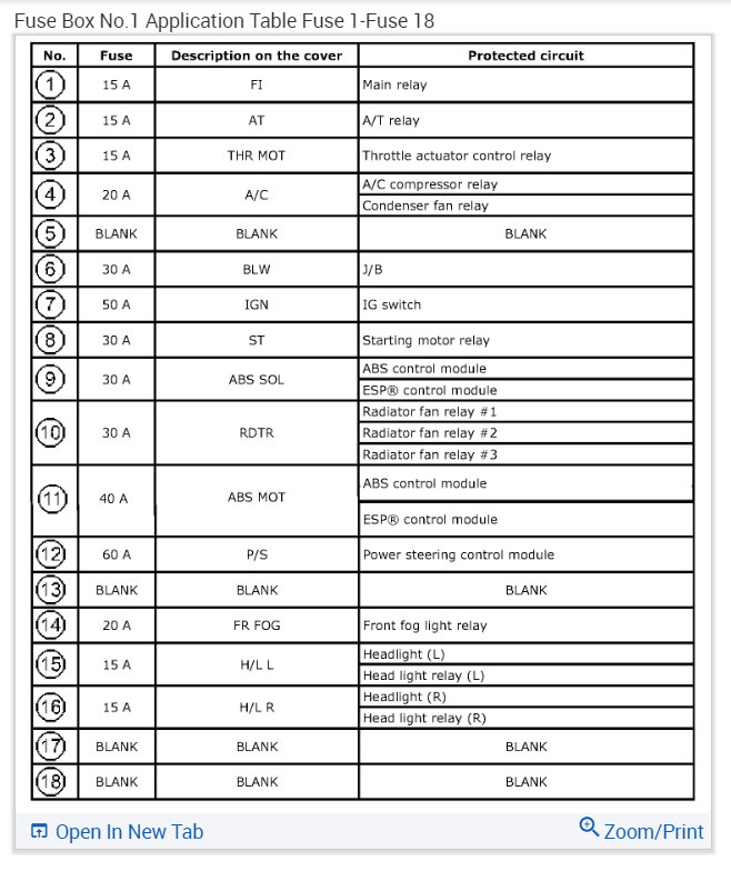

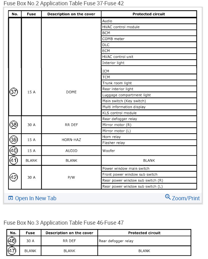

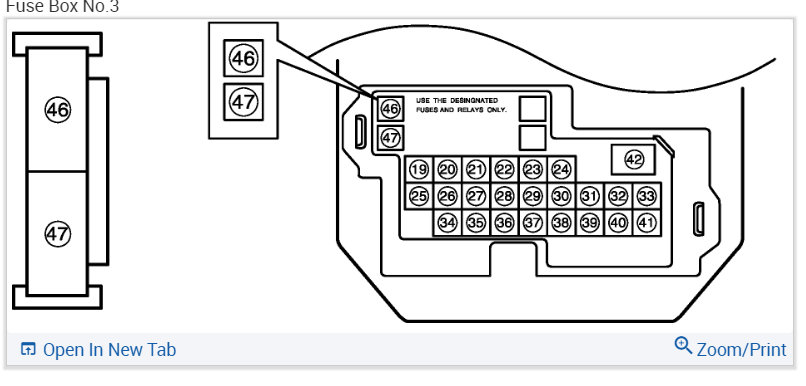

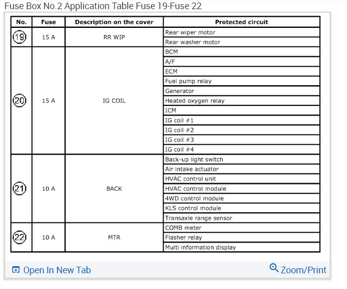

There are two fuses that run the cluster, please check them out to see if they are blown. If they are okay try unplugging and re-plugging int he cluster to help any bad connecting there. Here are a couple wiring diagram to see which fuses are running the cluster
