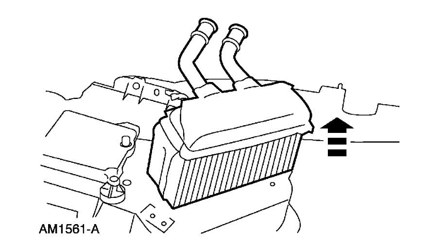

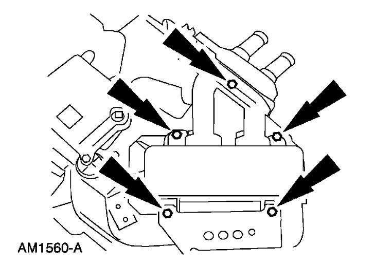

You said the issue. stop leak is junk and never works. It solidifies in the heater core and the radiator and causes a blockage.
You need a heater core replacement. This is a full dash removal and then the heater case has to be removed as well.
Are you going to do this yourself? If so, I can provide instruction for this huge job.
REMOVAL AND INSTALLATION
NOTE: If a heater core leak is suspected, the heater core must be leak tested before it is removed from the vehicle.
1. Remove the plenum chamber.
2. Remove the screws and the heater core cover.
3. Carefully cut the seal above the heater core inlet and outlet tubes and remove the heater core.
4. To install, reverse the removal procedure.
