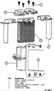

18.Remove retaining screws from heater core cover, then the cover from plenum assembly.
19.Remove retaining screw from heater core inlet and outlet tube bracket.
Heater Core Removal And Installation
https://www.2carpros.com/forum/automotive_pictures/12900_hc_4.jpg
20.Pull heater core and seal assembly from plenum assembly.
21.Reverse procedure to install.
