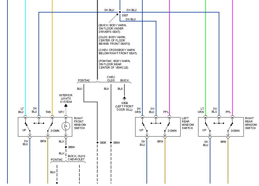

Front passenger side window will not work with passenger side switch but will work with driver side switch. I removed the passenger side rear switch and tried it on the front window and it would not work. Does anyone have a wiring diagram of the power window circuit?

I fyo put it someplace else and it doesn't work then it is probably the switch. circuit is to large to send this ought to helpyou oult

Thank you for the quick reply, but I removed the passenger side rear switch and tried it on the front window and it would not work. That's why I was looking for the wiring diagram.
