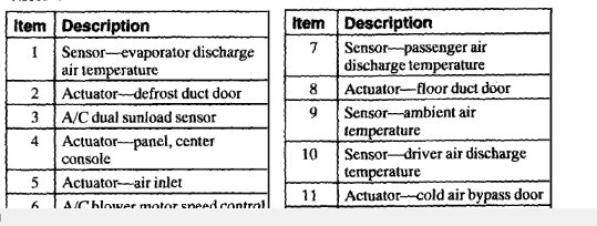

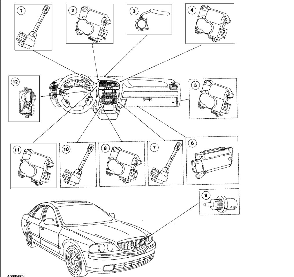

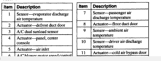

You have a blend door actuator that sounds like is going out. Here is a guide that will show you what you are in for when doing the job:
Here is the location for your car.
Check out the diagrams (below) Let us know what happens and please upload pictures or videos of the problem.
