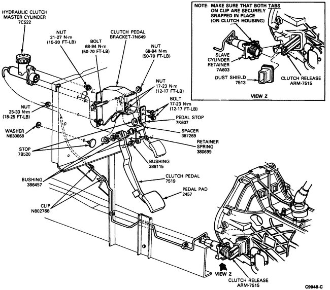

If you can't put the vehicle in gear with the engine running (It grinds), then you have a problem with either the clutch master cylinder or the slave cylinder.
First, check the fluid level in the clutch master cylinder reservoir. It is mounted to the firewall under the hood. See picture 1

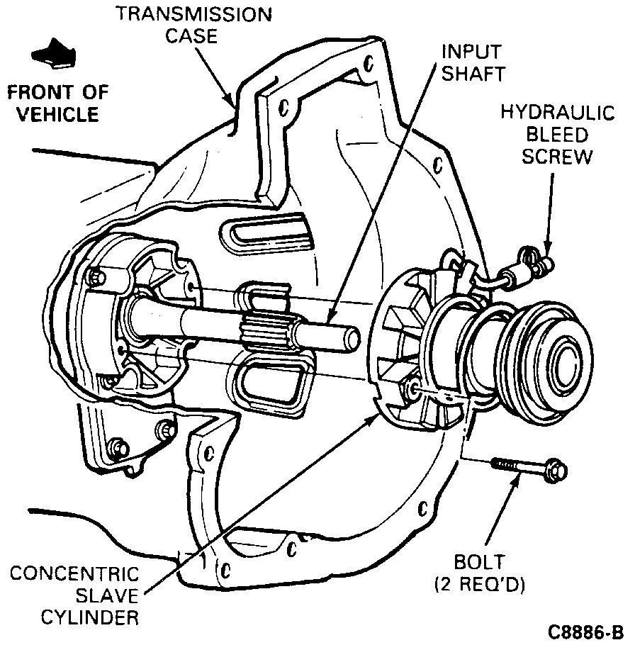

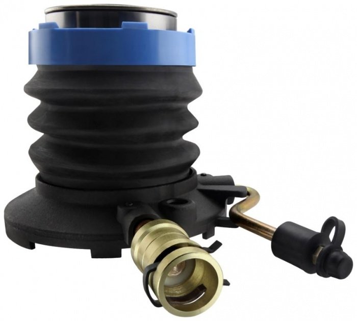

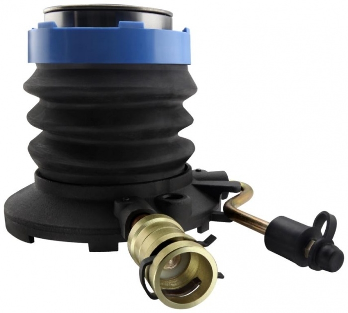

I also attached a picture of the slave cylinder. To replace it, the transmission needs removed.
If the fluid is full in the reservoir, suspect a bad master cylinder. Have a helper pump the clutch pedal while you watch to see if the fluid level changes in the reservoir. If it doesn't, remove the MC. As far as the slave cylinder, most times they leak when they go bad, so check under the vehicle for evidence of a leak. Regardless, if the MC reservoir is empty, refill it with Dot 3 brake fluid to see if it was just low.

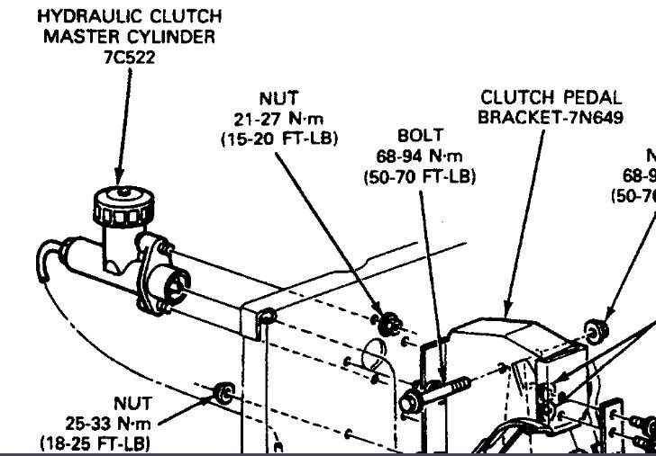

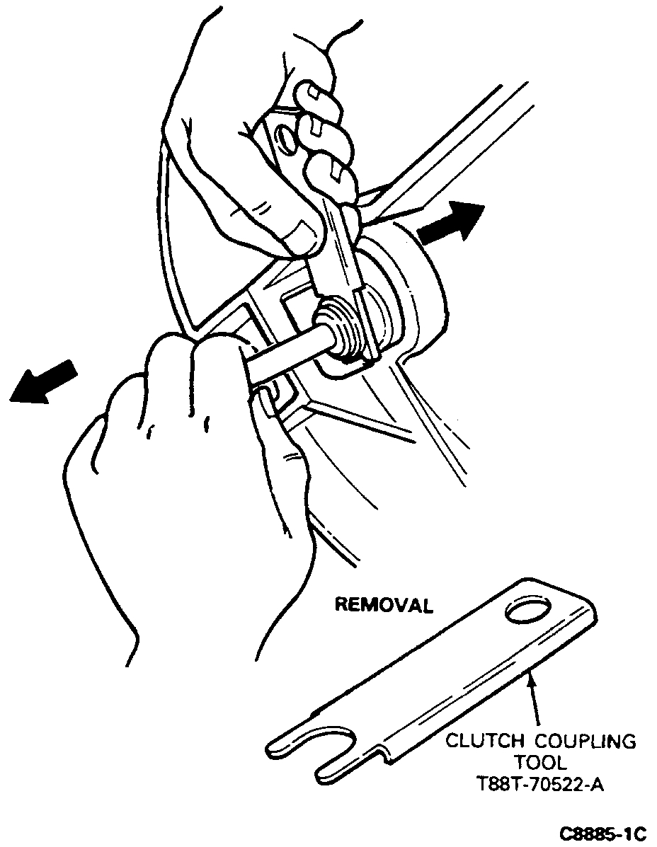

If you determine the MC is bad, here are the directions for replacement. Pic 3 correlates with these directions.
CAUTION: For vehicles equipped with external slave cylinders, prior to any vehicle service that requires removal of the slave cylinder (i.e., transmission removal), the master cylinder pushrod must be disconnected from the clutch pedal. If not disconnected, permanent damage to the slave cylinder will occur if the clutch pedal is depressed while the slave cylinder is disconnected.
1. From cab interior, carefully pry push rod and retainer bushing from cross-shaft lever pin.
2. Disconnect interlock switch connector plug.
3. Remove the two nuts and support bracket retaining the clutch reservoir and master cylinder assembly to the firewall.
4. Disconnect hydraulic tube from master cylinder.
5. Remove clutch reservoir and master cylinder assembly from firewall.
6. When the master cylinder studs are free of dash panel, rotate cylinder 105° counterclockwise to permit interlock switch to exit dash panel. Remove unit from vehicle.
7. Reverse procedure to install.
8. Fill and bleed the hydraulic system. See: Clutch Fluid > Procedures
NOTE: As the clutch disc wears, the fluid level in the reservoir will rise. The fill line step in the reservoir is the normal level for a new system.
If you determine the slave cylinder is bad, here are the directions for replacement after the transmission is removed.
______________________________________________
REMOVAL AND INSTALLATION
REMOVAL
Disconnecting Clutch Slave Cylinder Tube.
See Pic 3
1. Disconnect coupling at transmission with Clutch Coupling Tool T88T-70522-A by sliding the white plastic sleeve toward the slave cylinder while applying a slight tug on tube.
2. Remove the transmission.
3. Remove slave cylinder bolts to the transmission.
4. Remove slave cylinder from transmission input shaft.
INSTALLATION
Slave Cylinder
See pic 4
1. Position slave cylinder over transmission input shaft with bleed screw and coupling facing left side of transmission.
2. Install the slave cylinder attaching bolts and tighten to 20-27 Nm (15-20 ft lb).
3. Install the transmission.
4. Insert male coupling into female coupling on the clutch slave cylinder. Make sure that the connection is secure.
5. Bleed the hydraulic system as required See: Clutch Fluid > Procedures.

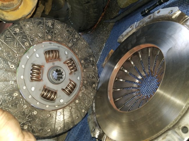

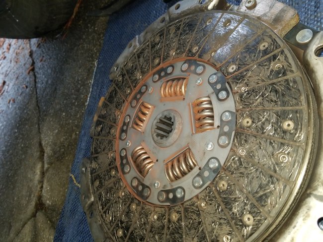

so i did one more final check before i start tearing this apart. i put a pry-bar on the slave with the bleeder open. squeezed all the fluid out, put the line back in and after two or three pumps it pops out again. which tells me the pressure plate does not want to move. maybe the clutch came apart and is keeping the whole system from moving.
Mar 24, 2021 at 6:23 AM (Merged)
the plate may be the problem. I doubt it came apart.
300 CID
  • 14 POSTS
it looks fine, just got it and the clutch down, no cracks or anything out of the ordinary. before i dropped the transmission all the way out, i still had the hydraulic line plugged in had someone pump the pedal and it never blew the connection. could a bad bleed may have caused the over pressuring? or is it going to even do what it is supposed to when not pushed against the pressure plate?
there is no pressure on the slave without the pressure plate to push. so it will not build much pressure.
no, the bleeder has nothing to do with it
300 CID
  • 14 POSTS
could the pressure plate been too tight? i torqued them a lot. I am seeing 15-20 ft/lbs online.
no, that is not it. it is the springs in the plate.
15-20 is what you need. do not over tighten.
300 CID
  • 14 POSTS
they are going to look at me like a scammer if i try to exchange it. but it does have a life time warranty. i know bad bearings can be hard on all this stuff right. it shifts (or shifted fine) just made a lot of racket in anything but fourth gear.

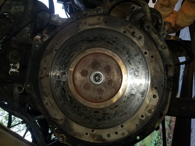

the disc looks terrible.
did you have the flywheel resurfaced?

no i have not, was going to buy a new one when i get the transmission rebuilt this week. maybe it is warped. it never chattered and a new one is cheap. just did not want to put a brand new one in front of the old transmission. doubt those are warrantied. they should have a clutch kit on the shelf, someone should any way and maybe i can put them side by side. i pulled the top off the other night after this go round and everything spins and meshes. just trying to get a few more days out of it until i can afford to get the rebuild done. literally four days would be great. if not i will have to take a lay off just to get my check from last week early get it rebuilt, and hopefully they will hire me back.

well, put them side by side and the look identical. I am at a loss. only thing i can think of is a bad slave off the shelf. but that does not explain why the two month old one did what it did. there has to be some excessive pressure building up to pop that connection. even if the transmission is busted. there would be no reason that system would not work, push the pedal, slave retracts, let off the pedal, slave extends. wish there were a way to test it without bolting it all up.
the other night i hooked the slave up outside the transmission pumped it up did not break the cxn. then the next morning i had a hard time getting the trans to mate up. what if the slave had all that pressure built up and when i used the clamp to get the transmission close enough to bolt up to the motor, a seal blew out?
you could try using a C clamp and see what happens.

Okay, here we go, put the pressure plate and clutch in, torqued to specs (roughly). i took the female connection off the slave and it would not connect to the hydraulic line. took the master back off the firewall (i could not get the pin out while installed) disconnected the line. installed the slave to the transmission, connected the open hydraulic line to the slave. fished it up thru the bay, mounted the transmission, hooked the line into the master, and what do you know? so i looked at the old male cxn and it did have a bevel on the shoulder where the retainer clip holds it in place. so that is why i think it popped out. does not explain why i have never had this problem before, seeing that i have changed all three pieces out at least once upon a time. but maybe the pre-filled/pre-bled units, and never having done all three at the same time may have had something to do with it. if i would have hooked the new line up to the slave then plugged it into the master everything would have been easy (maybe) there still would have been a three foot line with air in it.
Okay, so it is all good now?
