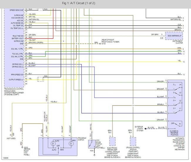

My car shifts by it self from D to 2 or 3 as I drive. If I select S, then it stays there and behavior is normal, it does not change gears by it self. We tired changing gearbox oil, but no change. The car is mostly in my garage, as I work abroad. Also, the small display at the gear changing handle shows wrong gear number - when in D, it shows 2 or 3 and it is not the same as the dashboard display shows. When I shift to S, the small green lights may or may not show S, but some other, at random and changing. Car is in Serbia, Europe.
Mar 15, 2017 at 5:12 AM
  • 55,849 POSTS

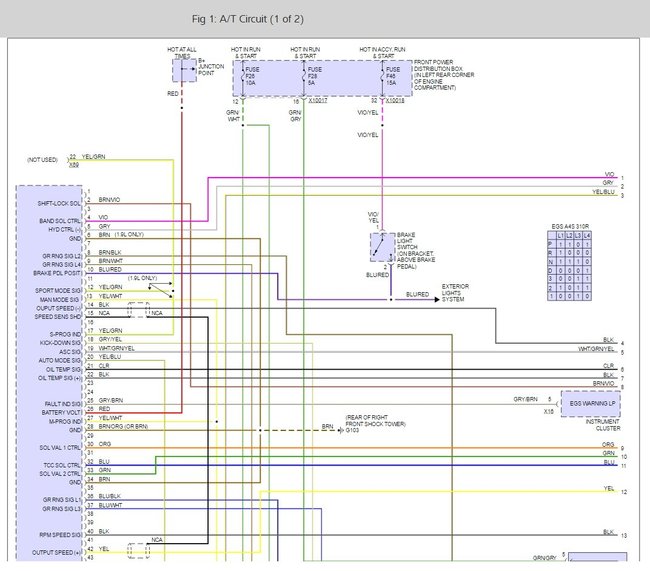

This car has a transmission control module that sounds like it is going out and needs a new one. Check all of the fuses to be safe though.
Here is the location which is under the hood on the passengers side. check the diagrams below.
Please let us know what you find so it will help others.
Best, Ken
