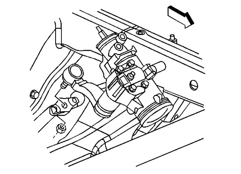

When I turn right at slow speeds, park, and reversing to the right the steering gets tight and whines. But only to the right. I checked the power steering fluid it was low but not dry. I added some but not change. Any ideas on what might be going on? My next step is the change the pump but as a single mom I don't have a lot to put on to this.
Aug 28, 2019 at 8:39 PM
Good morning

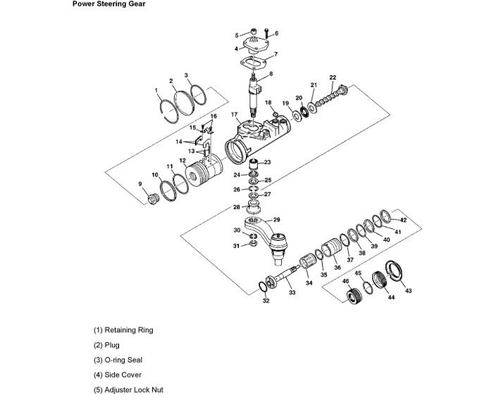

The fact it turns okay with the other side tells me it is not the pump. It sounds more like steering gear.
The first thing I would do is to flush the steering system with about 1 gallon of fluid. There may be dirt or debris in the system causing this issue.
Remove the return line from the pump and put it in a 5 gallon bucket. Start the engine and add fluid as it is running to keep the level up until you see clear fluid going into the bucket.
If that does not cure it, I would suspect the steering gear is your issue.
