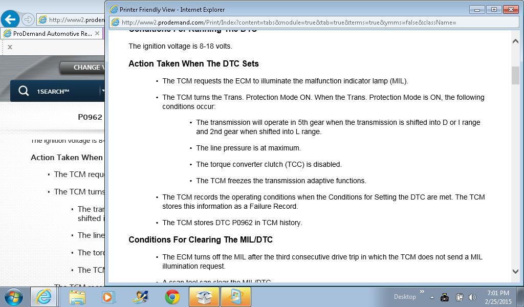

SATURNTECH9
  • 30,869 POSTS
Are you sure the light doesnt say reduced performance? I have never seen a reduced pressure light on those vues.If the reduced performance light is coming on there is a problem in the throttle by wire system. That will cause it to not shift retard the timing you wont go anywhere real fast.Pretty common on those.
Feb 25, 2015 at 6:33 PM
SATURNTECH9
  • 30,869 POSTS
they only used those transmissions in the 2002-2003 v6 vues and only the vue no other car line.then in 2004 they switched to the v6 Honda engine and Honda transmission.i have never had to make a repair to the actual transmission on those v6 2002-2003 vues.plenty of repairs to the 4cyl automatic transmissions those were a piece of junk.from what I see I don't see the pressure control solenoid available.I posted what happens when the code sets it goes to full line pressure and shifts to 5th gear and stays there.I see the whole valve body that's expensive.
