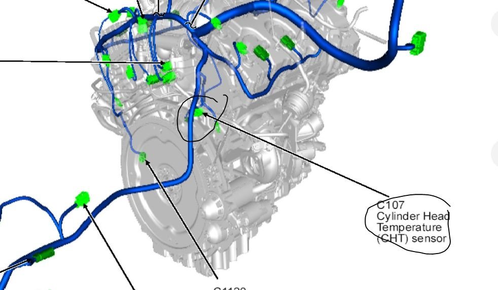

need location of coolant temperature sensor.

The sensor is behind the right front cylinder head. I attached a picture for you to view. Check out the diagrams (Below). Please let us know if you need anything else to get the problem fixed.
