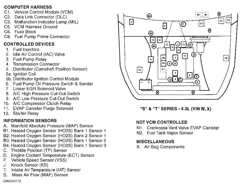

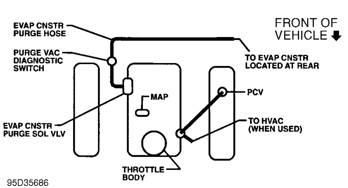

I need to know where the vacuum lines and electrical sensors go so I can replace missing ones from my 1996 4.3L AWD Olds Bravada. Thanks

see pics may be confusing on one of them.
